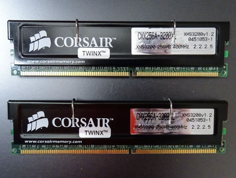

I guess using Corsair 3200LL or 3500C2 is okay. They're different products by corsair. I compare that with 4790 / 4770K like here. I guess they need a picture of the dimms to validate the score?

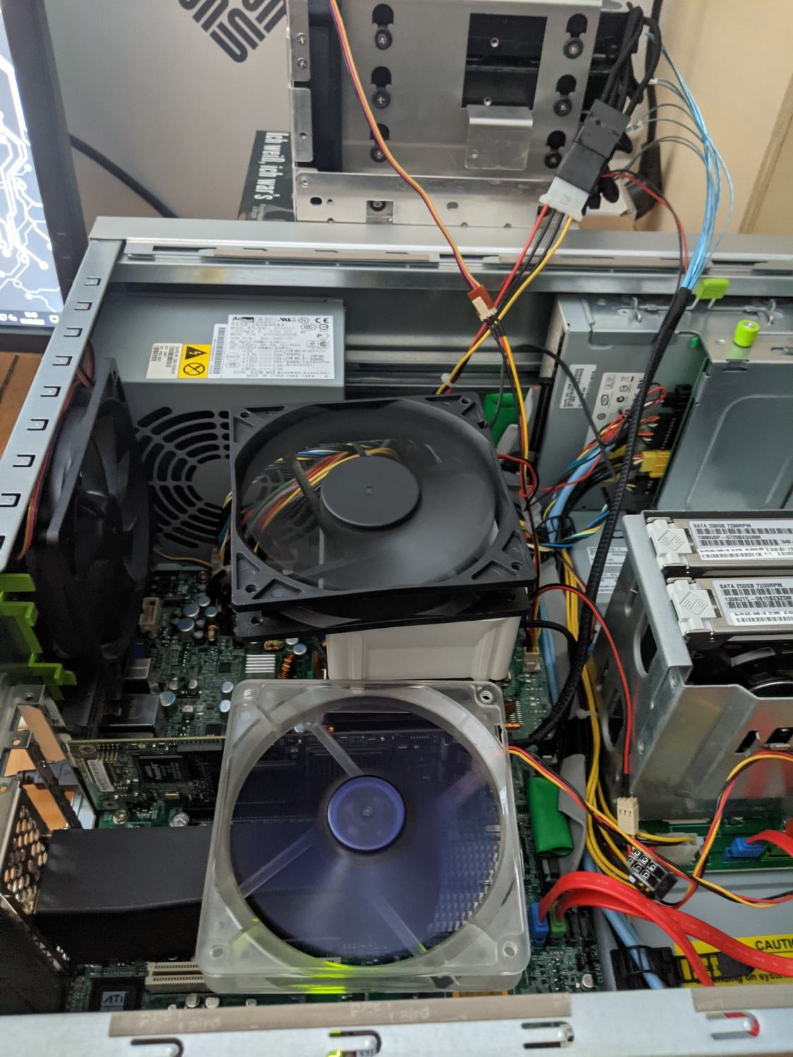

For the record, I just ordered 3x Opteron 285.
I don’t know if I will order a board or ecc memory, but at least those I have then.
I was just wondering, when running a dual Opteron setup ecc memory is needed.
How much “needed” is it? Is normal memory able to run?
Edit: Somehow it does not leave my mind.
I suppose for most boards it is not the ECC part, which afaik doesn't lead to incompatibility when using normal DDR,
but the registered part that many Dual 940 Boards use, which is generally not interchangeable with standard desktop DDR.
I have an Asus K8N-DL here and although I haven't tested it, I would suspect that it won't work with regular DDR since the entire memory QVL is made up of registered memory which due to the different way of addressing the chips is not going to work in standard 939 boards and vice versa for desktop DDR.
the Sun Ultra 20 M2 works with non ECC, dont know if its relevant :haha:
chipset is gettin very hot without cooling :unsure:
I was pretty sure about the ECC / non ECC and registered / unregistered stuff.
Maybe I missed something with the memory controller being integrated in the CPU with AMD.
Guess I'll try and check with my 940 system then.

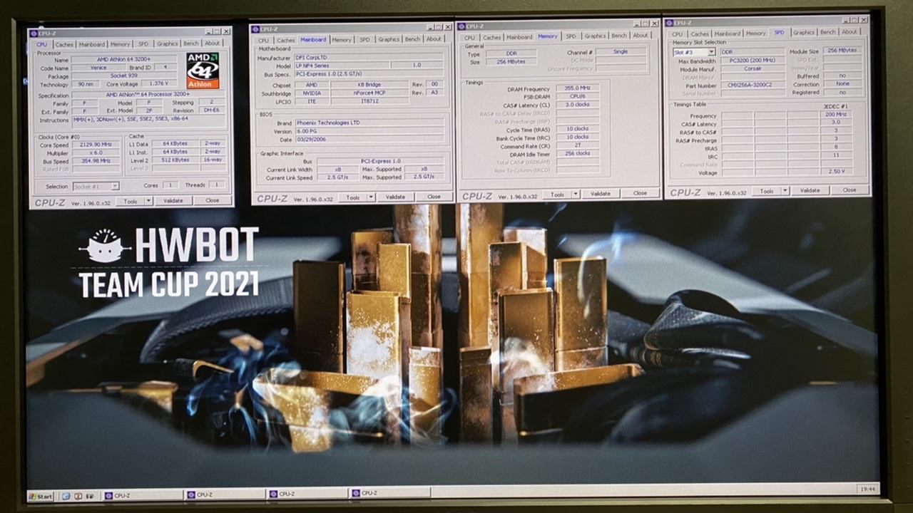

I am testing my Venice s939 processors. I noticed I had a border I could not cross on 1 chip with C2.5-4-4-8 (2T). 1 did a 320MHz boot and 1 did not boot anything higher then 300MHz.
My best cpu so far can do a 345MHz boot for C2.5 (TCCD without bp). Good that I finally bin them.
Edit: Just boot tests for now.
Edit: Testing with a fixed LDT voltage of 1.30v

I just tested all of my tccd at pre set timings and settings on s939. I tested them to be able to post an boot C3 355MHz. I allready had 1 dimm which was capable. I tested 4 more dimms to be capable (all 256MB). So I need to bin these to find out which is the best dimm.
For those wanting to test max speed for ddr1. Please focus on 256MB tccd dimms. I have a lot of 512MB dimms and none boot 355MHz. From the few 256MB dimms I have, I allready had 1 which boots 355MHz c3, but now I have tested 4 more to be capable. 1 other crashed while booting and no 512MB dimm even tried to boot Windows XP. Knowing that I have a lot of 512’s.
Edit: So if you ever see ddr 700 512’s, buy them. That should be rather unique.

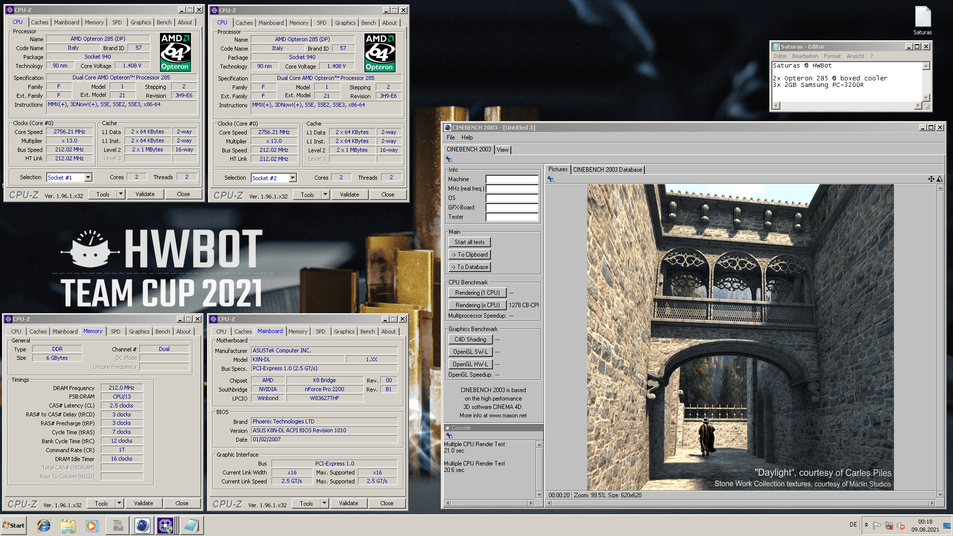

New memory arrived, but working with 2 or 4 sticks seems to have barely any impact on CB2003 performance and virtually none on overclockability.
But to my surprise I can run those 8GB at 230MHz with fairly tight timings 2.5-3-3-7 1T - at least for server grade memory that seems pretty good.
I'll do more testing in September, hopefully with a little better cooling, but the coming weeks are pretty busy.
And since my team doesn't really compete in the team cup, it's more for reference anyway 😅
