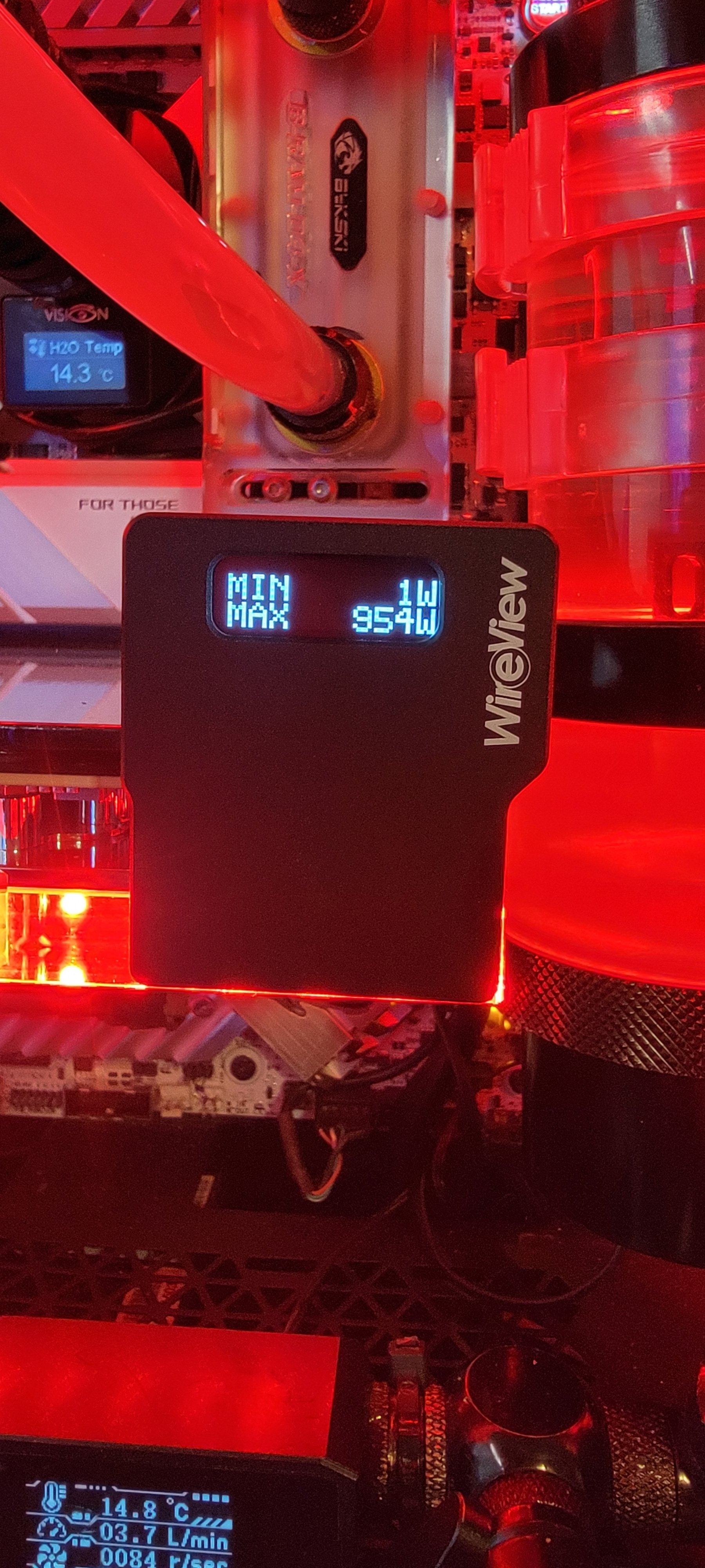

I'd love to find a thread that's for the 4090 guys with the evc2 mod! Here's my highest wattage my strix oc 4090 has done.

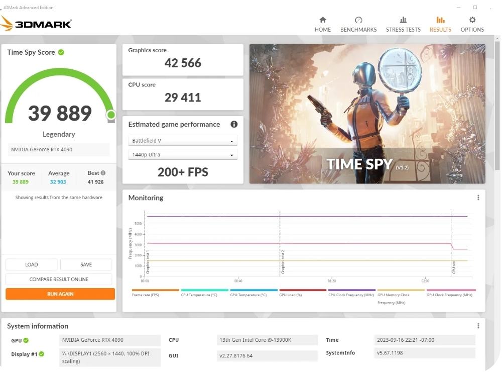

How in the hell are people getting 44k gpu scores in timespy with the 4090?
I'm pulling almost 1k watts out of my strix oc with the evc2 and pretty much the same drivers and clocks.
Anyone willing to help?
