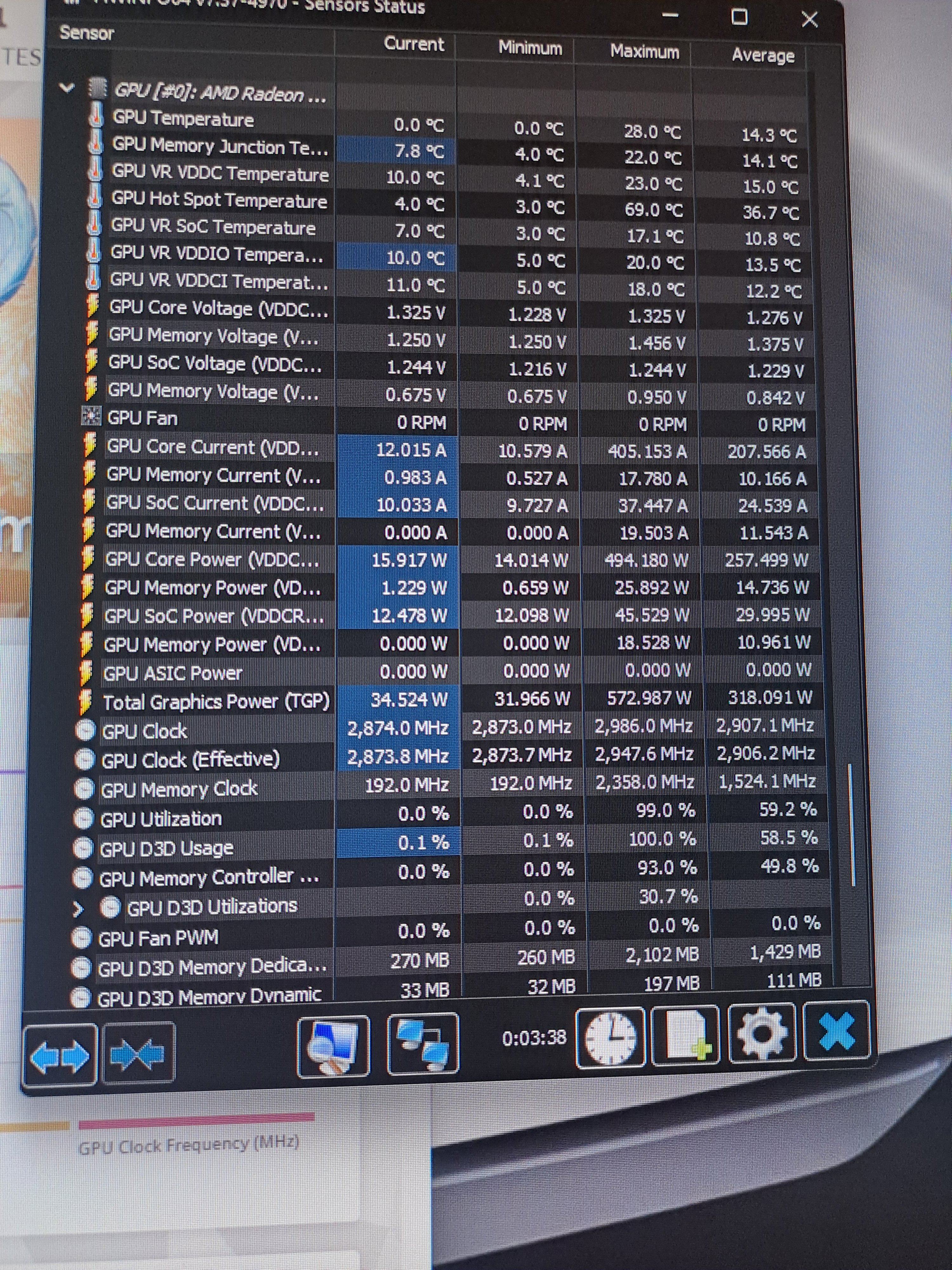

GPU core temp feels ok, but hotspot is too hot.
Do you use liquid metal?
Wie so oft: wenig sinnvolle Frage ohne Verbrauchsangabe. Wir wissen doch, dass es da eine Spreizung gibt. Für 300 W ist das Delta zu groß, für 500 nicht.

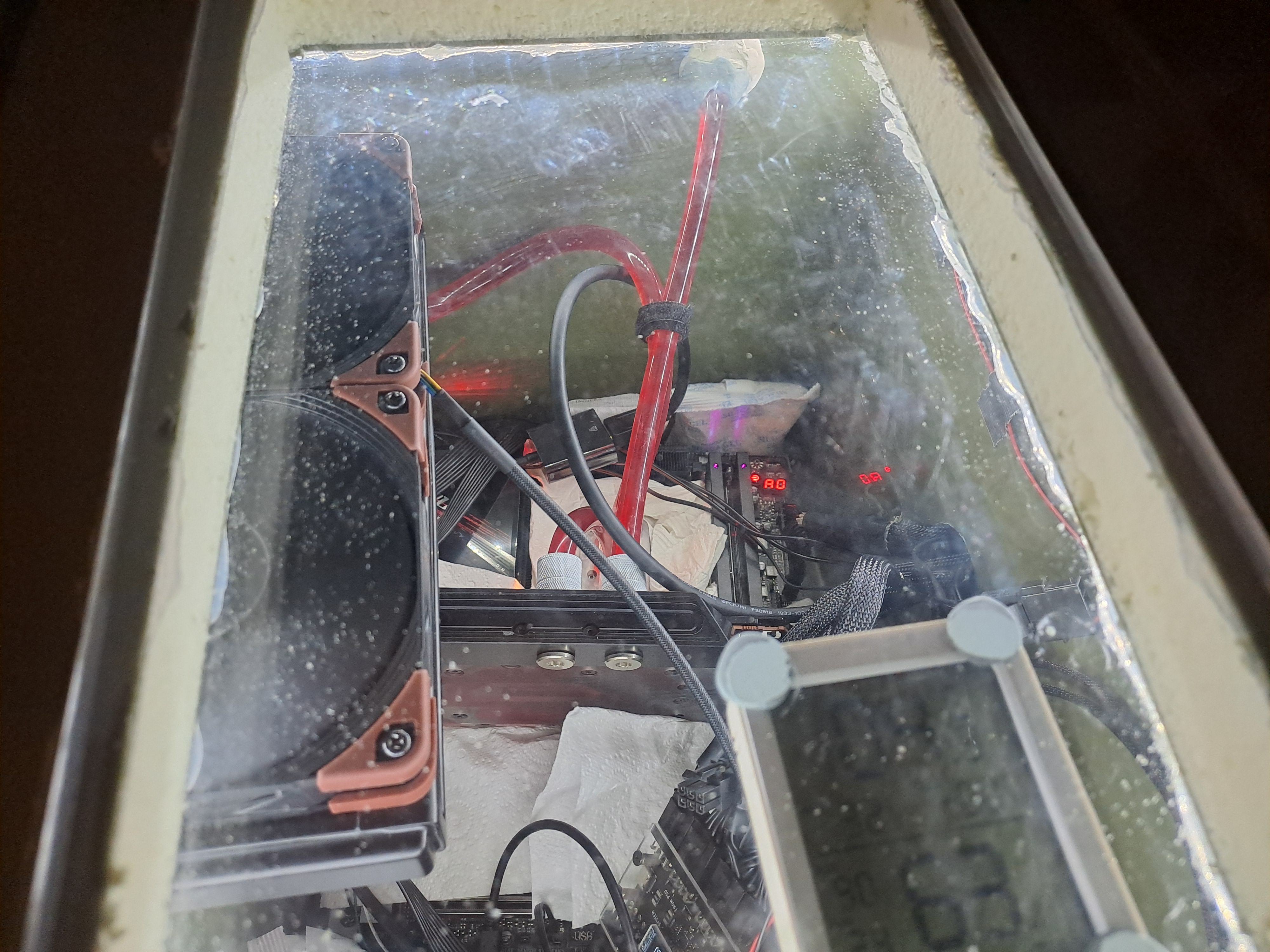

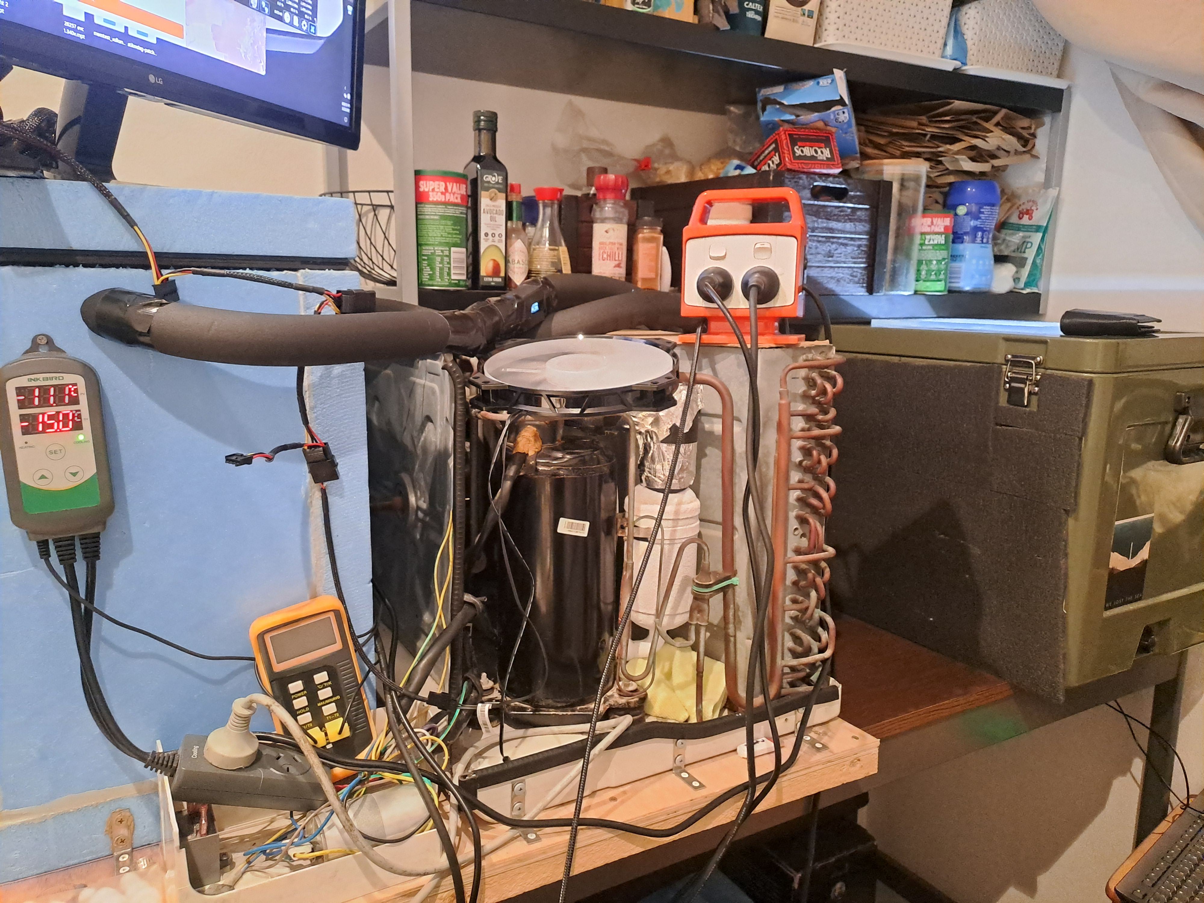

This is the set up now..in a chill box..no condensation to worry about!

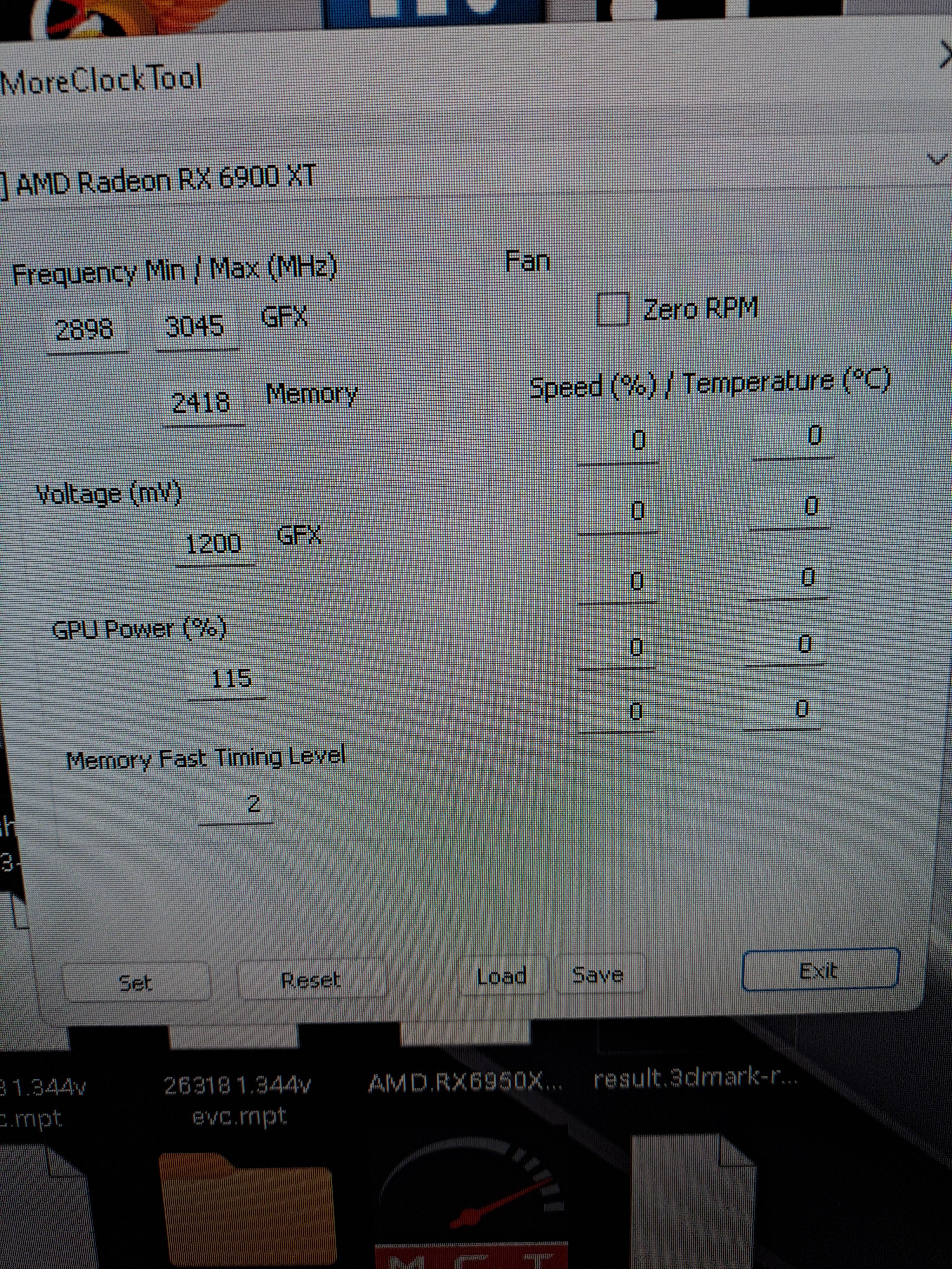

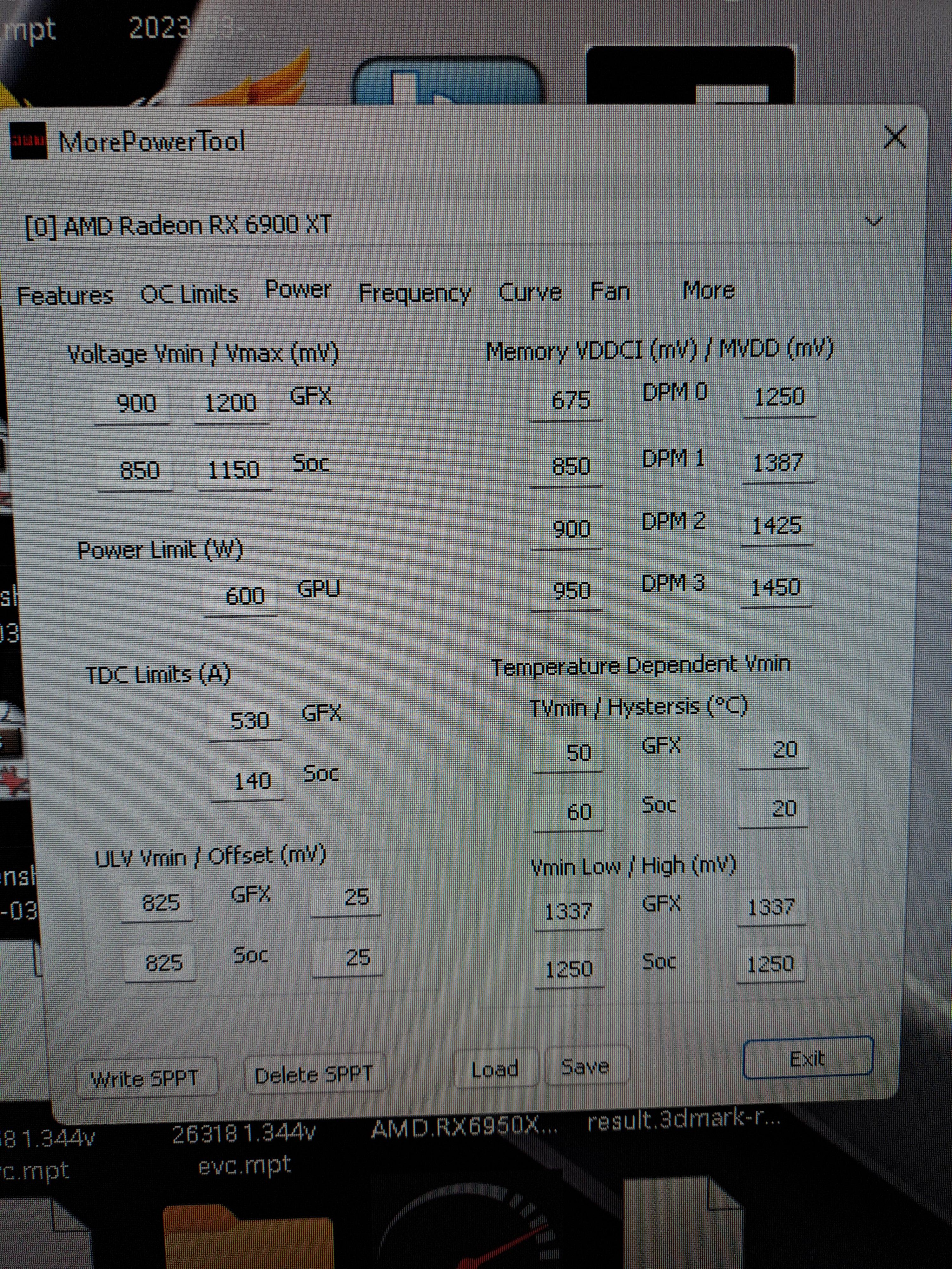

This last run was at 1.32v

65-27=38 Grad Delta halte ich auch bei 550W für viel. Ich weiß, ShirKhan, dass du da toleranter bist, aber ich denke, das könnte auch etwas geringer sein. Wir sprechen hier ja fast von 40 Grad.
@Grindcore77 Could you please tell a bit more about your cooling setup? Thx!
I think 65-27 = 38 degrees delta is a lot, even at 550W. I know, ShirKhan, that you're more tolerant, but I think it could be a bit lower. We're talking almost 40 degrees here.
Yeah i was thinking so myself...oh well time to drain the loop again 😆😆
Is just a modified air conditioner....to run below 0c....pumping ethalyne glycol with a strong submersible pond pump....
Temps controlled with inkbird...
pc is in a beer cooler...everything inside except the PSU....
First component in the chill box is a radiator with fans that cool the inside air of the box to around 0c thus lowering the dew point enough that sub zero temps can be achieved without condensation..being in the box minimises humidity with the chilled air
