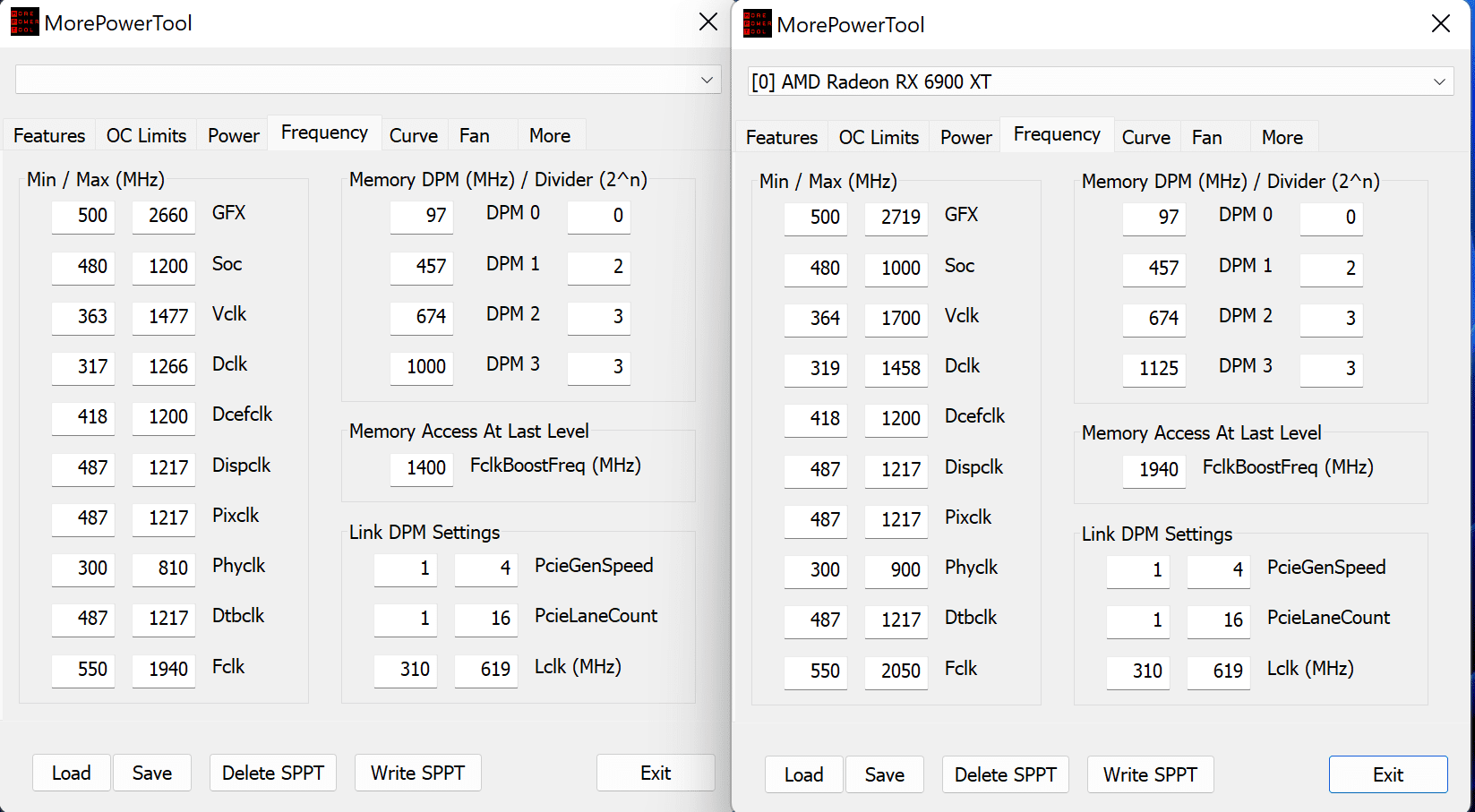

DPM 2 & 3 to 1400 maybe VDDCi to 900 ?
Könnte klappen, ausprobieren.
Soc Vmin low/ High to ??
Default oder nicht viel mehr. Vielleicht 1175/1175.
And what others setting ?
Schauen, wie weit du Fclk max im "Frequency"-Tab anheben kannst. 2050, 2150, 2250 ... Dafür Soc Vmin vielleicht etwas höher. Das hilft dir zwar nicht dabei, 2150 FT1 stabil zu bekommen, bringt aber etwas Leistung.

Basically: It's possible that the VRAM 2150 FT1 just won't make it, no matter what you try. If it works, but only with a crowbar, the VRAM error correction may cost more performance than the higher clock or FastTimings bring. Less is sometimes more.
Might work, try it.
Default or not much more. Maybe 1175/1175.
See how far you can raise Fclk max in the "Frequency" tab. 2050, 2150, 2250 ... Soc Vmin maybe a bit higher. While this won't help you get 2150 FT1 stable, it will provide some performance.
If you've studied the tutorial and the ranking screenshots as intensively as you say, you certainly know examples from there, use them as role models. But since the abilities of different cards are so different, we can't give you any fixed values from here. Test, change, test, change... If you're running all-day Time Spy loops (I don't think anyone here has done that before), you're nothing new.;)

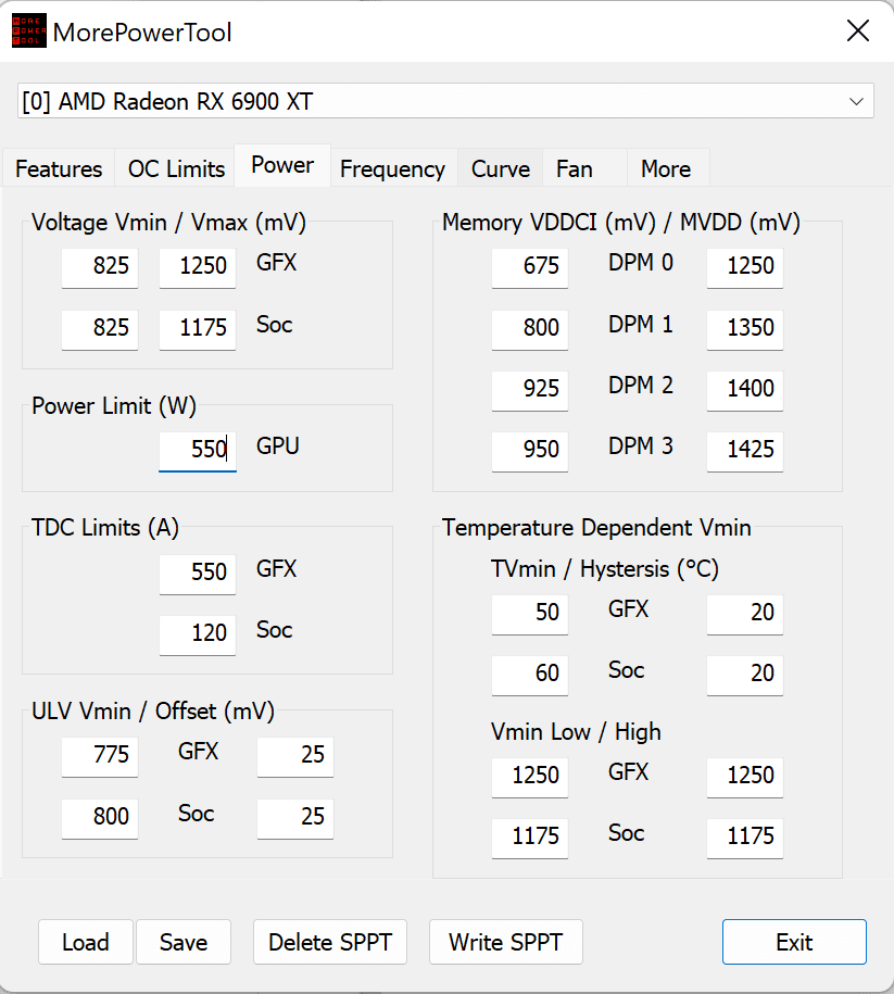

100A for the SOC is either unnecessary of way too much.
This is the first time i have to disagree with you
Why do you think it's too much ?
Because it's not visibly hit ?

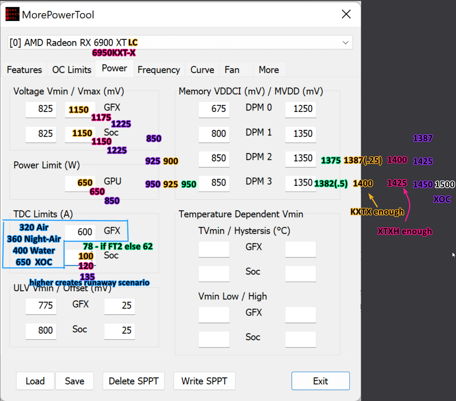

@Sectorz
EDIT: Made a tiny coloring mistake on the card's title

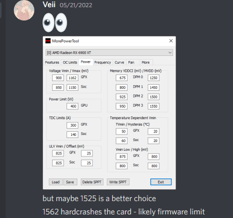

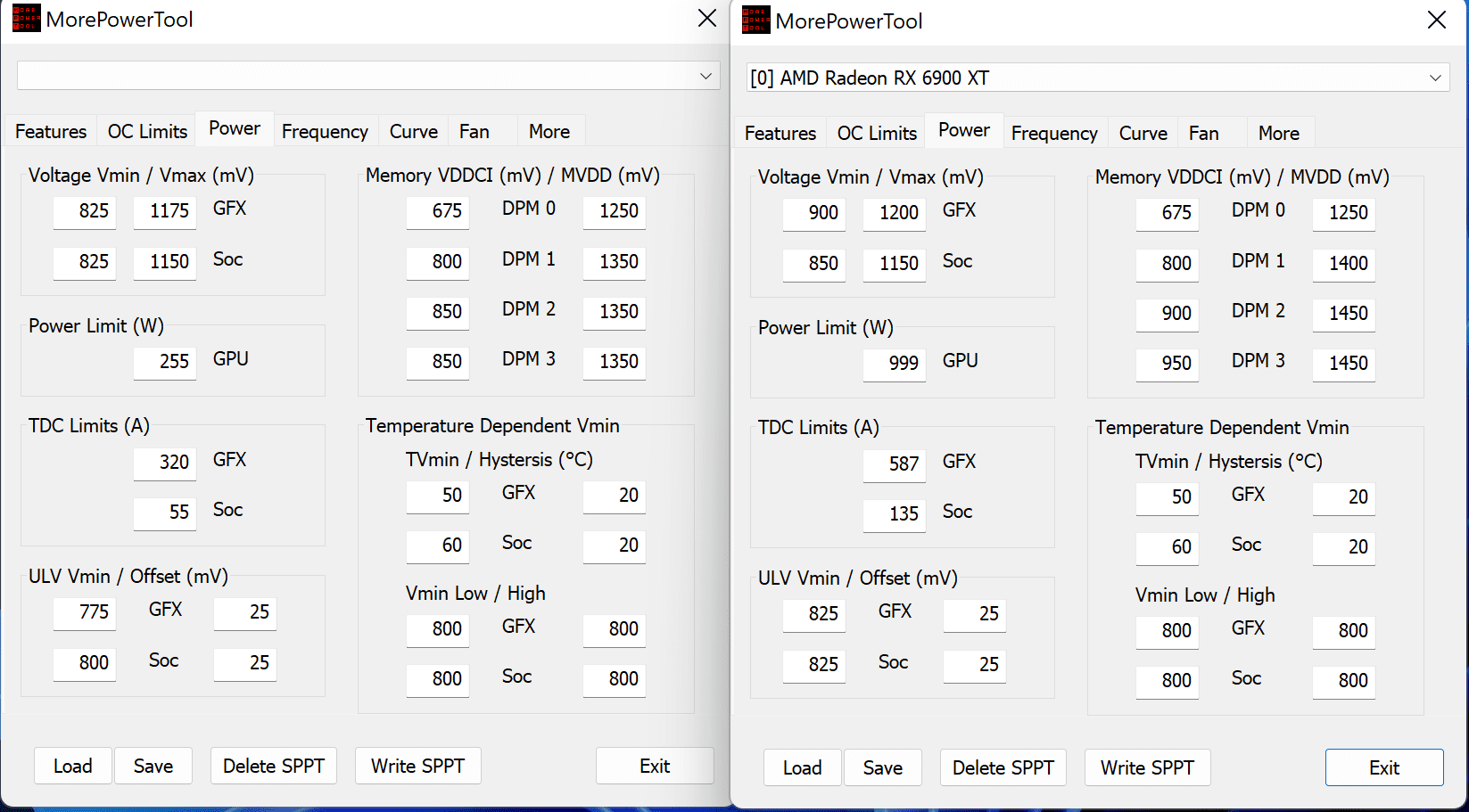

KXTX cards and OEM LC ones have lower voltage binned memory. Lower MVDD for them is better. We have "older" ones. I have seen both limit at the same wall ~ but we can pump MVDD without issues ~ just around 1550 you have overcurrent failures. As usual ~ too much VDIMM causes bad signal integrity :)
EDIT2: two mistakes - green (air) is 900mV VDDCI not 950. oops. Orange is cold air or max fans

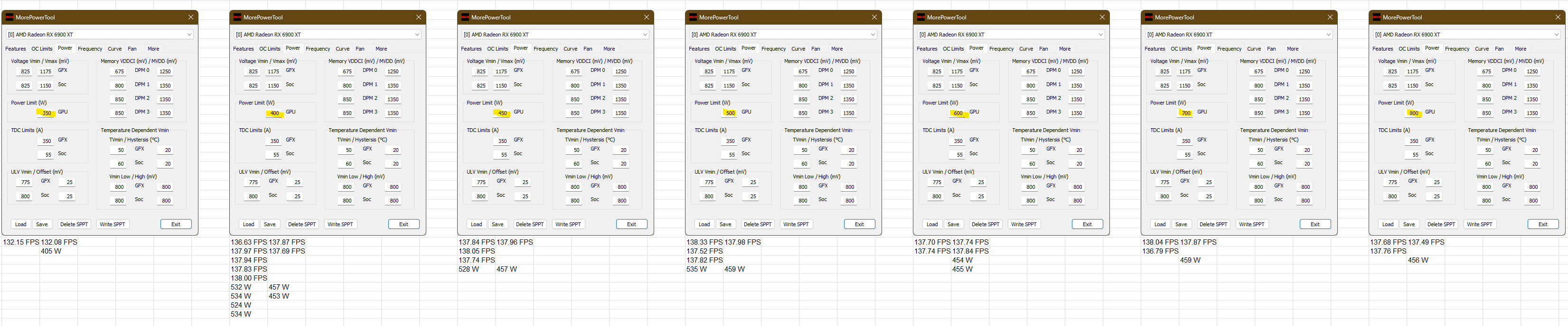

Wow Thanks this image is the kind of diagrams I needed but not sur if I understand it,if you dont have make error. For the moment it a basic reference one I play with, next week a Gigabyte Waterforce and after that a XFX Zero WB.
So if I read correctly your image, what you put is
Green = 6900 XT basic ??
Pink = 6900 XT XTXH
Yellow = 6950 XT KXTX
Purple = SHOCK
1) You don't find your 1225mv voltage a little low for be XOC no ?
2) @Veii or @ShirKhan, you tell me 2 different things 😅 one say write the voltage 1250 at Vmax GFX the others at Vmin low/High box ?
3) @ApolloX I wait your answer8-)

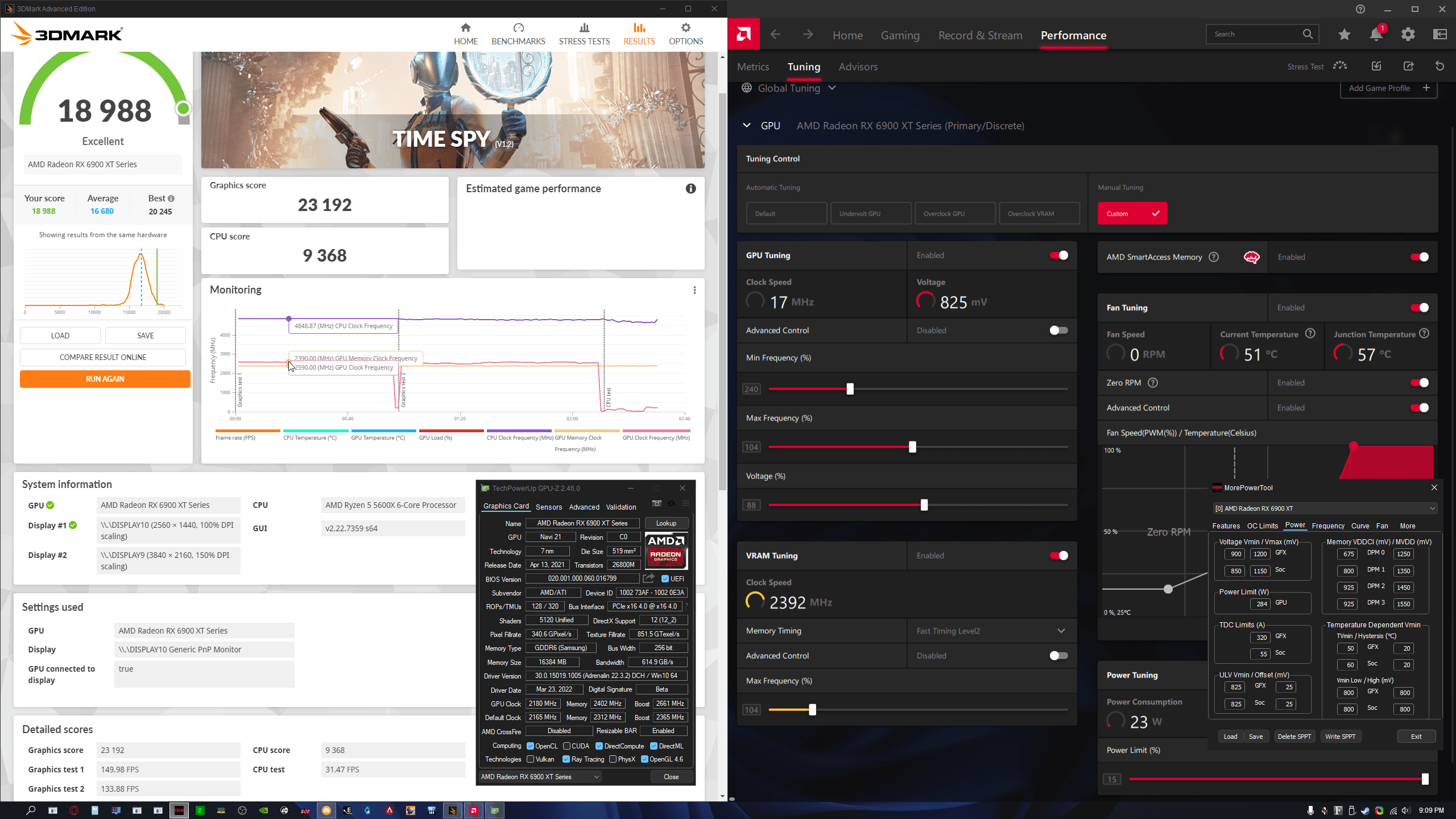

So a mix of your tips and I arrive to this for have like a Ref stock 6900 XT but with max voltage Core 1250mv / Vram 1.450 with all the normale drop when idle ? The sentence where you say ''Extend TDC limits with the slider, not with MPT'' you want that I put less in MPT for that the +15% of WATTman = to what I want ?
Thanks alots yours three for your time.
PS: Veii I know 6900 XT block to 2150mhz but XTXH I can go higher in Wattman.
I added the names later, i'm sorry for the confusion
Usually wanted to split it in:
~ fine for air (which is about 320W)
~ fine for cold air or 100% fans (which is peaks that make sense without "wasting" voltage, as frequency can not increase)
~ the later separation was between "recommended" and "pushable if you have thermal headroom with little benefit"
XOC section is indeed for 550-600W loads and higher
It from this point on brings too little to even bother. Soo is there only if heat is no problem to maybe gain the little benefit of it ~ but in reality it's more of a waste.
^ also high voltage decreases signal integrity and memory scales only by that
DPM 2 & DPM 3 you usually want to keep similar
Yellow is what i would recommend people to run on water
Green is what i would recommend everybody to run to have any chance of passing 2150 ~ it is by stock higher on KXTX and on REF LC bios who default to 2300 mem.
Soo an "always recommended even for air" ~ tested to show similar scaling with bad and good VRAM (defaulting to 1156 DPM 3 strap)
^ by default higher, given green values are very modest
Yellow is higher logically, but "high enough" for KXTX cards with better low voltage IC's.
Red/Pink is already very hot but about what still makes sense for bad ICs like our XTXH cards or XTX , well all others. ~ typically near 450-500W
Purple is for actual XOC. High, but high enough within reason. There is negative scaling ~ soo it requires very cold ambient to not fall into bad SNR issues
It is Purple like values in bios usually are after "Red" . It is for extreme cooling and XOC runs in general.
I dailied "red" but there is no way how i can cool that. Soo it was "a waste" and eats too much into SOC powerlimit. Useless :)
It is fine for custom loops tho
Purple is for pushing scenarios where thermals are not a problem and signal integrity wouldn't matter , near 10-20° . Usually i should title that XOC/LN2
White then is for LN2/Helium. On normal runs, running 1500 mem is "possible" ~ but it does bring you absolutely zero. It only could be beneficial sub-zero where you need higher input current to begin with
Sadly idk if VDDCI (IMC) would be fine with 1050-1100mV , probably 1050 could run without killing the card ~ but sub-zero is not my territory. Too novice foundation for XOC :)

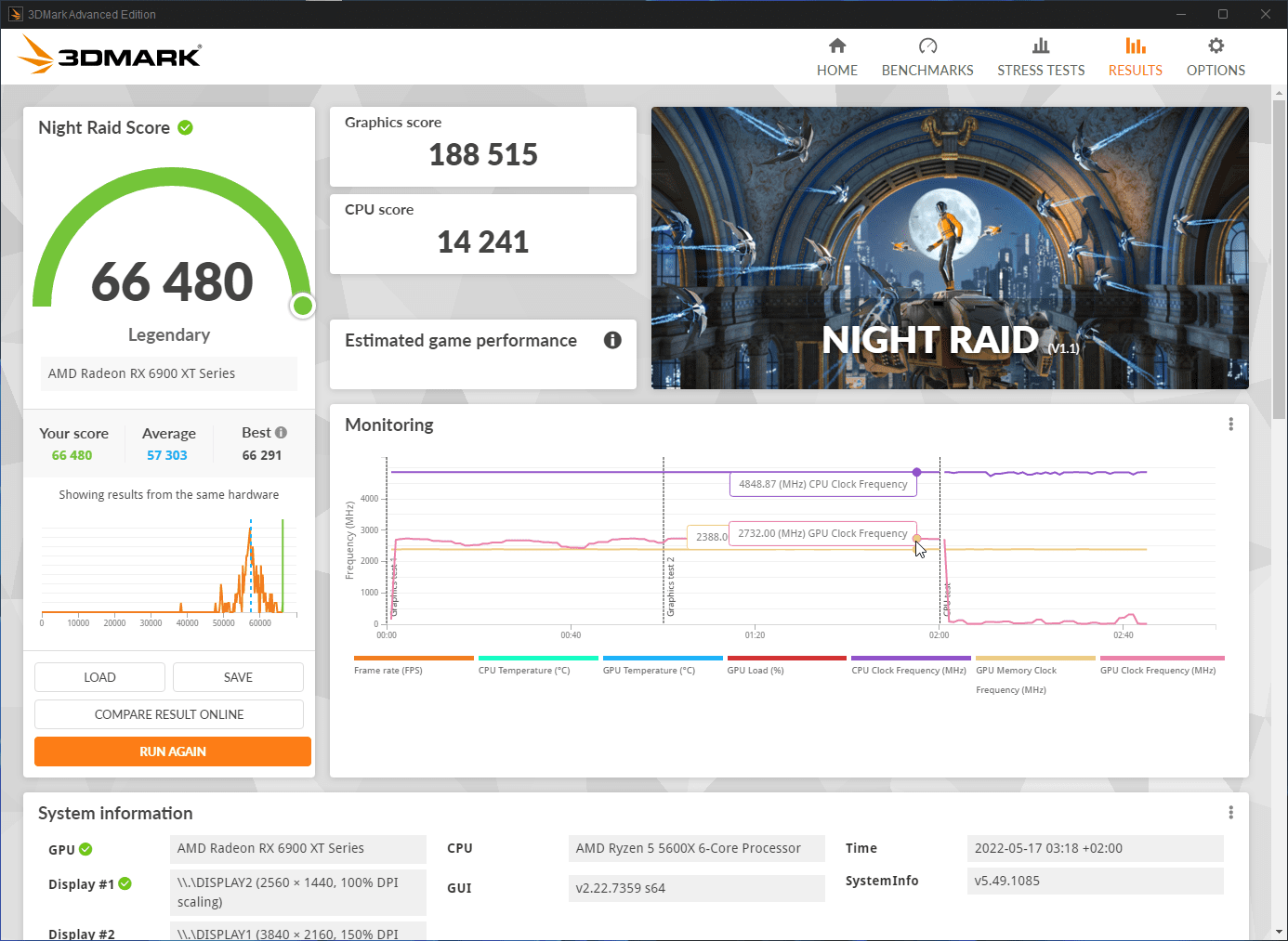

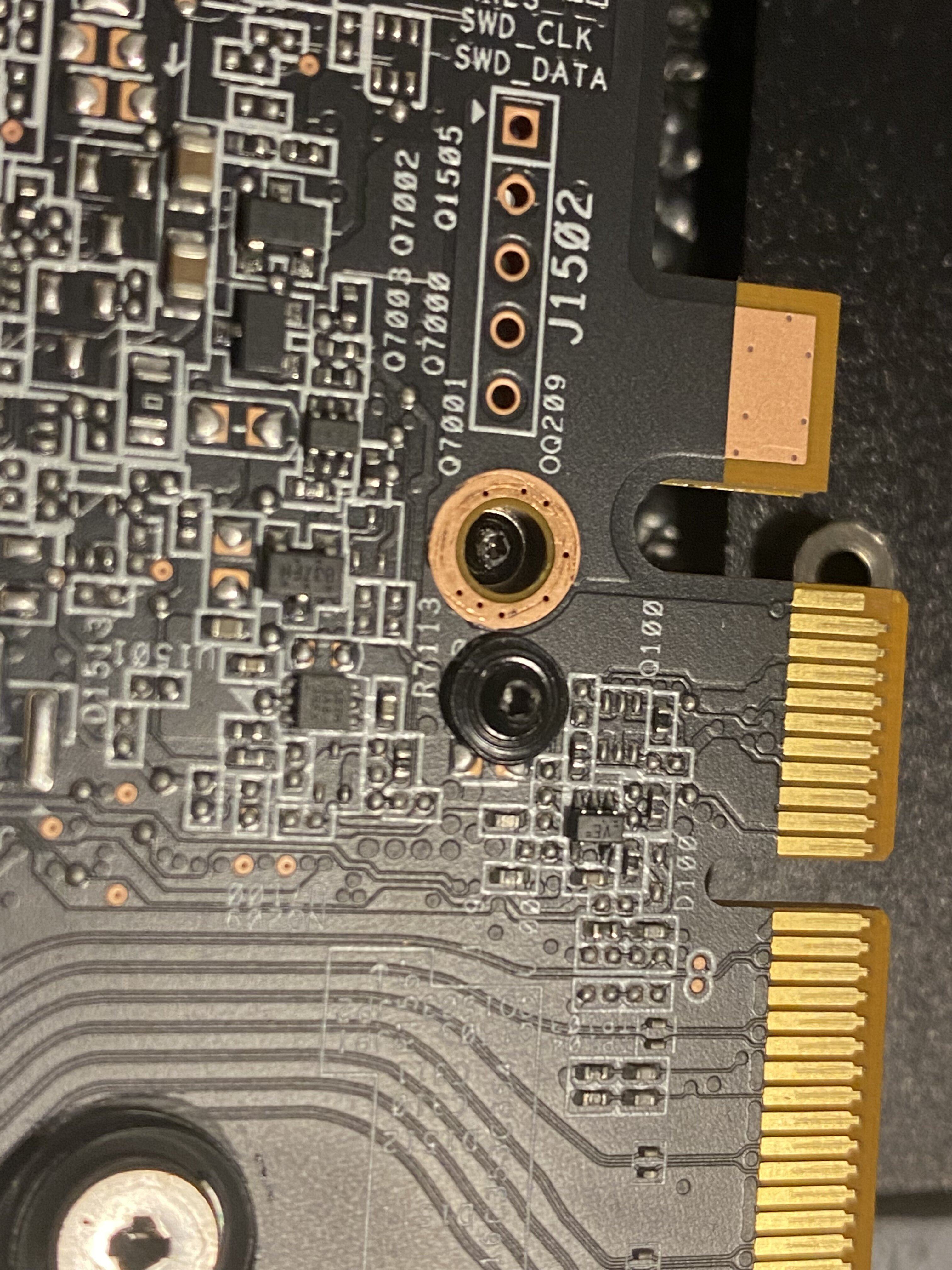

Ok all!! I cracked my card open and I redid the k5 pro application...wasn't the best so cleaned the heatsink and added more..at 512w my temps were lower across the board..by around 5/6 degrees...I will leave it for time being but maybe I could apply a bit more k5 and drop some more but not sure..what I am sure of is the factory pads are much better than the k5...but I think my gpu/hotspot temps are as good as they will get because of the contact with the gpu with the waterblock..no restriction from thermal pads..
Anyway I got my best score to date! Finally cracked 25000! And I haven't really messed with the mem clock yet..I've had it at 2150 for most of my runs...

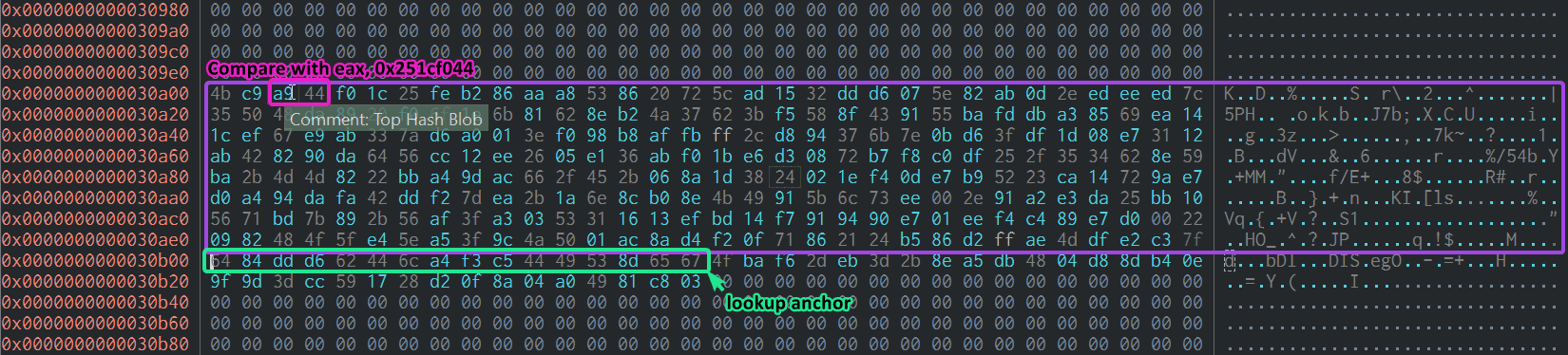

Offenbar näherst du dich den wichtigen Fragen von der Bios-Seite und kannst darin "lesen", während wir nur aus der Summe unserer Erfahrungen berichten.
Etwas digging schon
Das Thema zieht sich schon lange hinter sich. Über den RSA break sprach ich auch nicht weil man sich wie ein kleines Kind Freute ~ naja vlt ein klein wenig teasing :P
Aber ich brauche mehr Zeit
Signature locations hab ich, mini checksums (30+ stück) nun auch
Memory timings location ebenso
Aber das wichtigste ist durch nen 256 Byte hash "verschlüsselt" - welcher mit den anderen hashes zusammengetan wird.
Ich muss rausfinden welcher algorithmuss verwendet wird, den die locations hab ich nun soweit. Erstellen gehe nur nicht ganz ~ habe aber zu gehen
Sonnst ist es nur "halb-fertige" Arbeit. Bringt ja nun echt keinem was ums Problem drumherum zu gehen :coffee2:

So nach einem erneutem Pad Wechsel und einem abgerissenen Schraubenkopf hab ich Mem & VR Temps um gute 10 Grad nochmal runtergebracht.

Try this MPT (For XTXH/KXTX) , target 600W - but upload your bios first or a GPU-Z screenshot
Should load it on XTX but maybe vcore is defaulting too high - could force it to 500MHz, you have to test
  • 600W+75W.zip

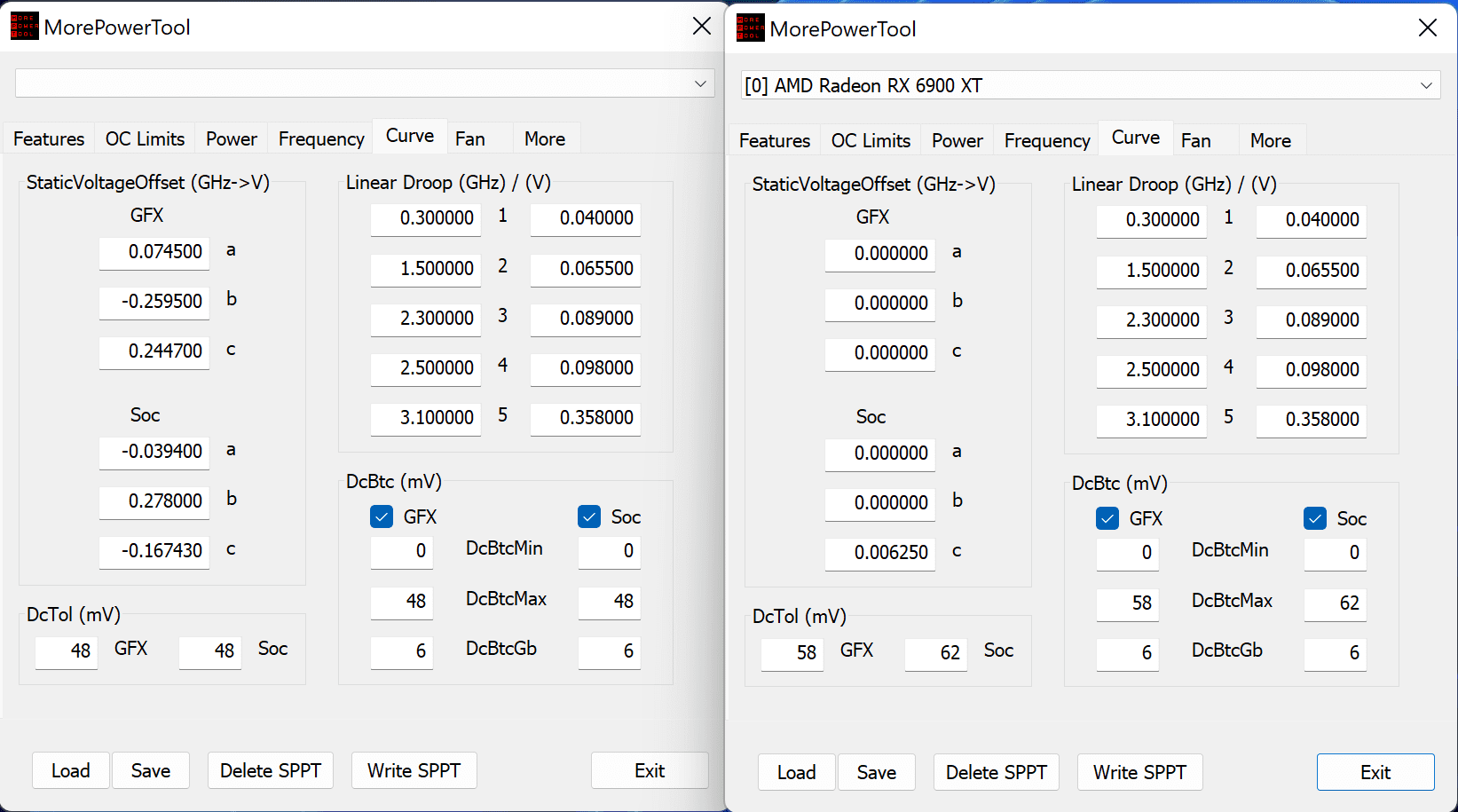

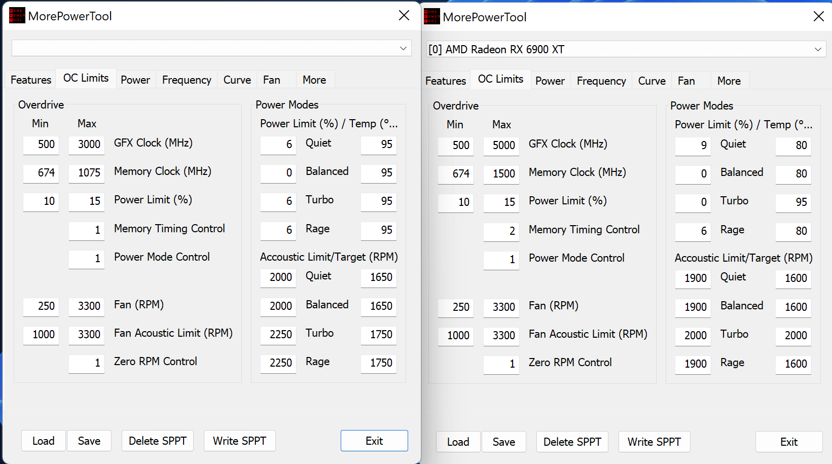

Ok here screenshot me versus yours

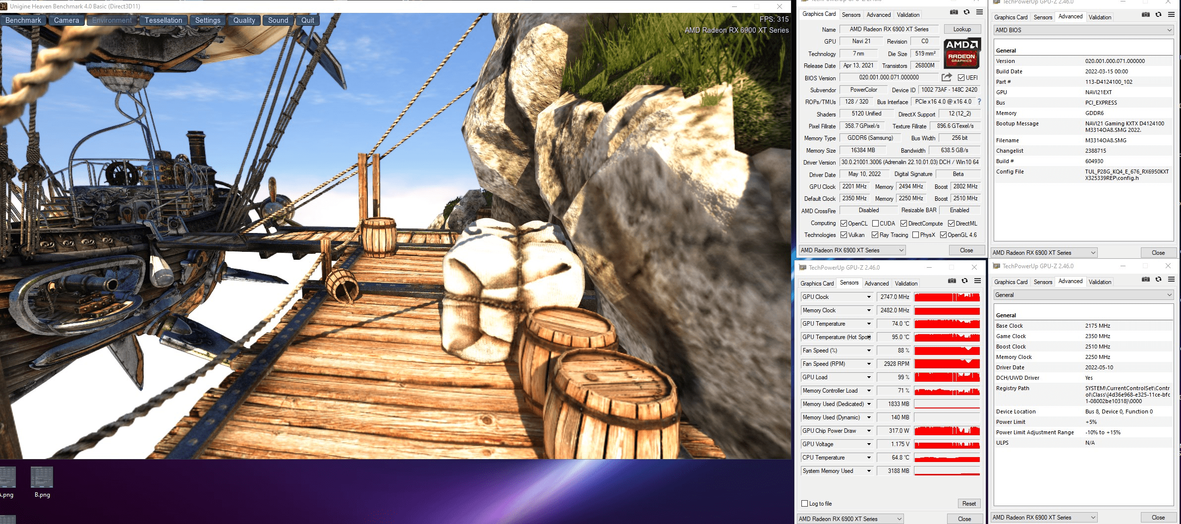

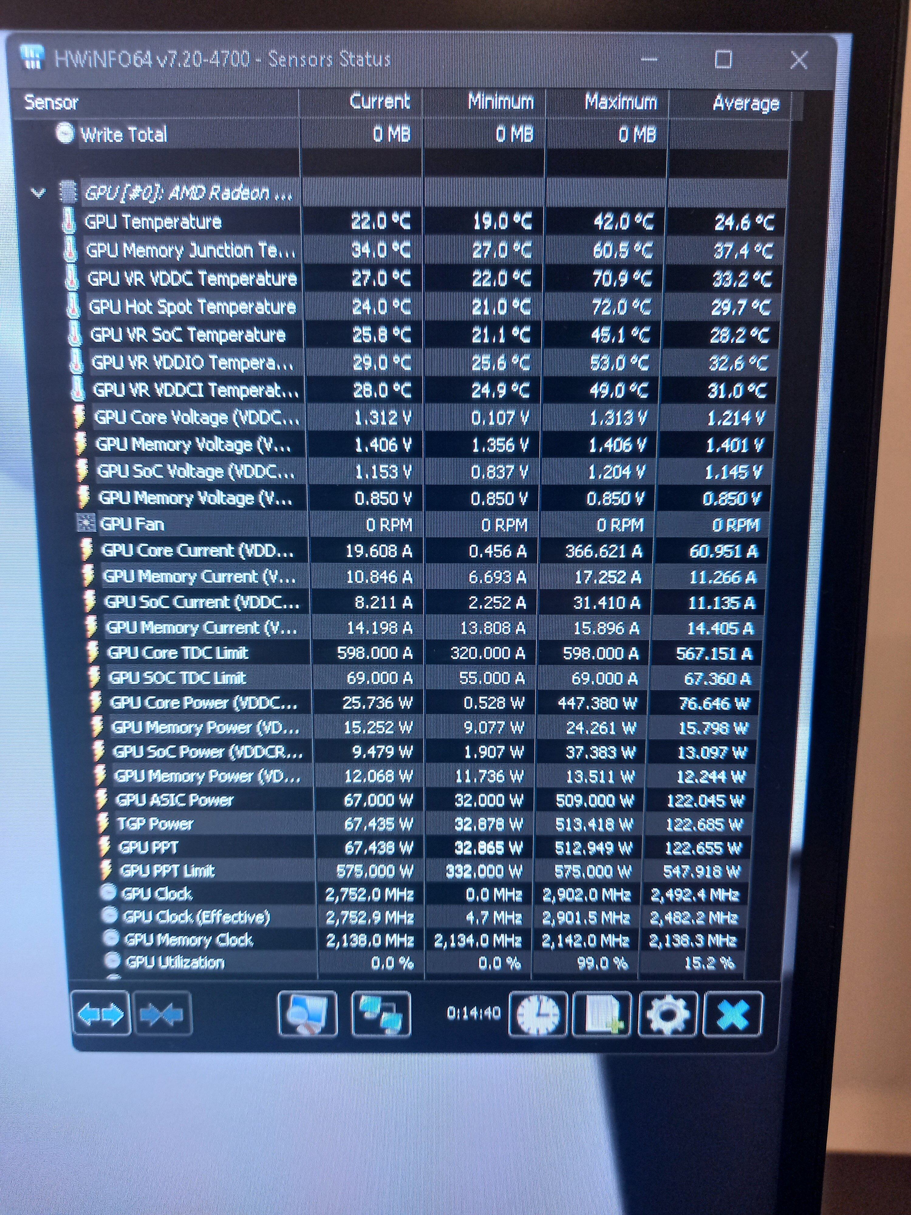

Think I found the reason for my mysterious shutdowns?! 😜 must have been Thermal shutdowns? My HS was definitely around 103° and I kept upping those watts 🤣🤣...must have tipped it over...on the plus side I have more headroom now coz of the LM....maybe I need to crank up the power level a bit more then 😁
Anyway I'm just staring to mess around with my mem overclocking on my card...the card isn't locked at 2150...in wattman the slider will go to 3000....I've tried a couple of settings over 2150 though and it definitely lowers fps...

Ganz sicher mit spoofing wird es nicht funktionieren. Aber ich verstehe nicht genau weswegen
Also dann eher nicht du :)

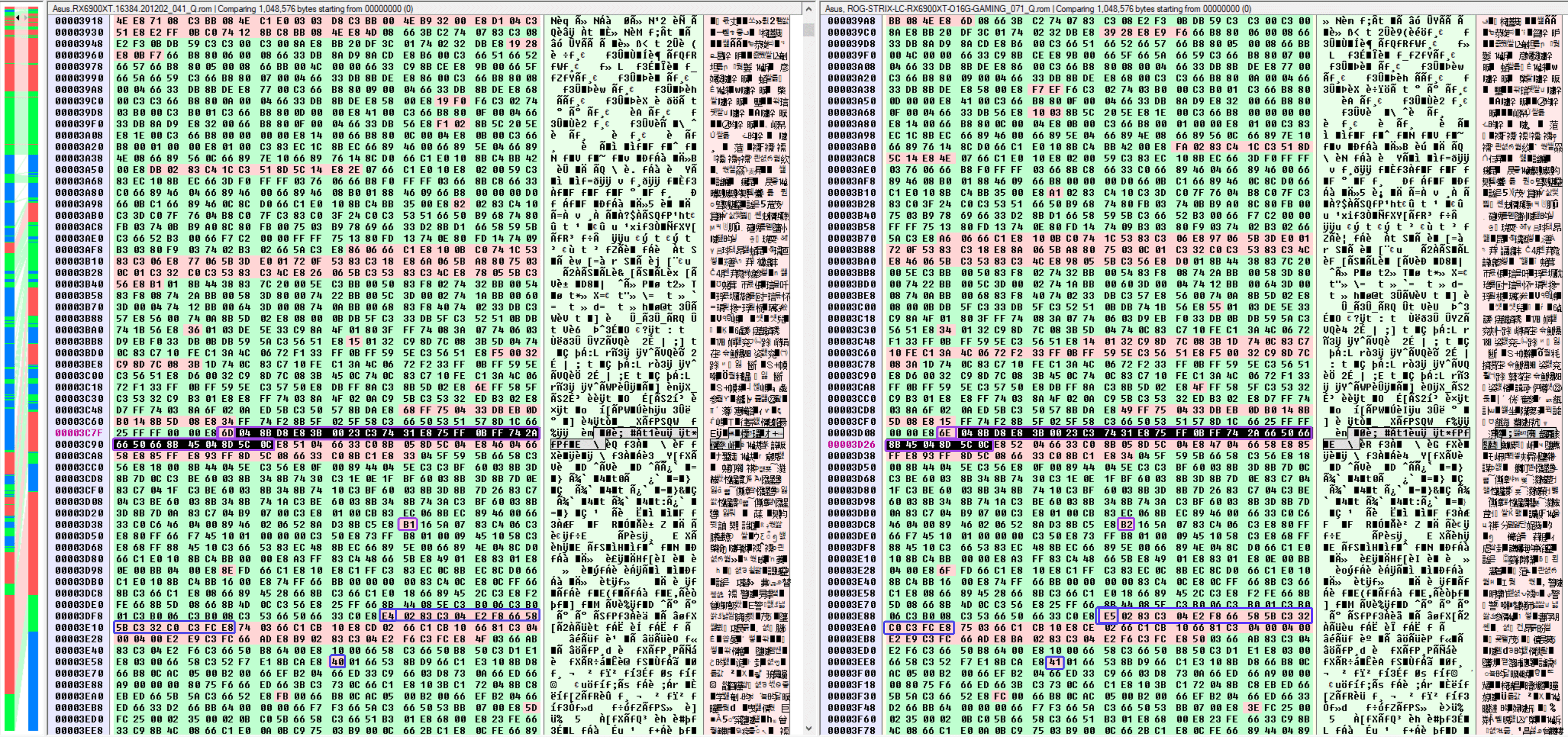

Ich kann halt keine gescheiten Biose erstellen, ohne dass der Top Hash Probleme macht
Sonnst wäre die Sache schon längst erledigt
Ich kann nur signierte module transplantieren
XTXH zu KXTX gehe auch halb - man kann die memory timings als solches nicht rüberpflanzen
Aber man kann den gesammten oberen teil rüberpflanzen :)
Oder die Karte spoofen , dass sie es rennt und "kompatible" wird
Bei den meisten "modulen" ~ ist ein ID check dabei
Solange es nichts gibt welches XTX "verbietet" also wortwörtlich blacklisted (zb das mainboard bios module)
Sollte es ja Ansich gehen
Aber sowas muss man cherry-picking testen
Ansich ja einfach , die kleine stelle muss nur fallen und alles gehe // bloß kein Plan was die verwenden
Eh mal schauen ~ interesant wäre aber Information zu sammen "weswegen" XTX nicht booted
Was genau wo blacklisted ist

Hab mir mal was Einfaches vorgenommen, nämlich das:
It makes a lot of sense to set PPT as high as your powersuply can handle spikes
Auf die Stabilität sollte ein zu geringes PPT keinen negativen Einfluss haben, im Grenzbereich eher im Gegenteil. Veiis Aussage lässt sich also so interpretieren, dass die Performance steigt, wenn das Powerlimit nicht nur knapp, sondern reichlich über der angezeigten Leistungaufnahme liegt, um auch Spikes abzudecken.
Nach erstem einfachen Test mit GT2 von Time Spy ist das nicht der Fall.

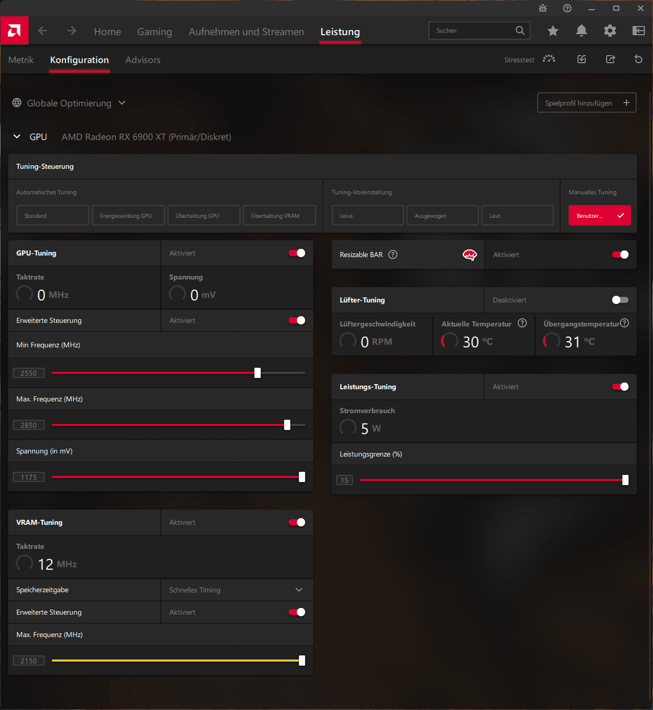

Treibersettings:
Für diesen Takt wurde die GFX/Soc-Spannung per EVC2 um 50/25 mV angehoben.
Im MPT wurde nur das TDC Limit GFX auf 350 A erhöht und das Power Limit von 350 bis 800 W variiert. Rest: default.
In der Grafik unten werden die FPS von GT2 angezeigt sowie die GPU Asic Power. 400 W PPT sind genug, weil das inkl. +15% Treiber-Slider 460 W macht, und die reichen offenbar ziemlich genau aus.
Spikes in der Leistungsaufnahme können von den 460 W nicht abgedeckt werden. Das kostet in diesem Szenario aber keine FPS.
(Anmerkung: Nicht irrtieren lassen von den höheren Wattzahlen links. Das ist eine andere Rechenweise, die GPU Asic Power mal 1,165 nimmt, um die "Total Board Power" näherungsweise zu simulieren. Falls das jemand genauer wissen will, schreibe ich noch was dazu.)

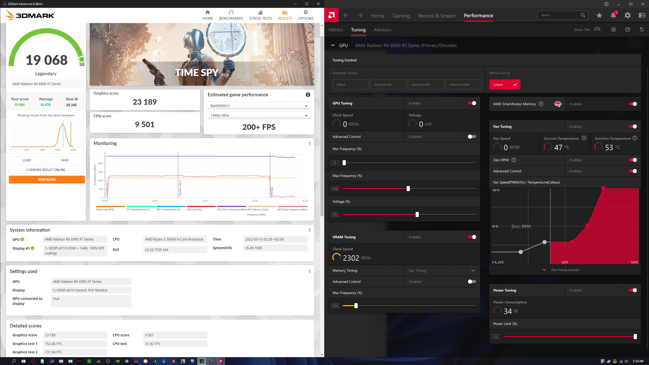

Ok some latest observations...im finding with my card that volts/clocks are scaling quite well...im now at 1.313v for gpu and most consistently stable at 2900mhz with 2842mhz average..in TS
Now how much more could I push the gpu voltage to keep trying out raising the clocks..this is only for benching purposes not 24/7..I have read that 1.3 should be the limit..even some at 1.4!... obviously don't want to fry the card but want to push it to its max....😃
Now for memory...i can get nothing over 2150 to run better...I've tried up to 2180mhz but always ends up lowering FPS...maybe I should be changing some other settings in MPT? ...or could this just be the card itself? It seems strange that it isn't locked to 2150 like other cards but it doesn't really like going over that limit anyway? ...I have read the few posts about speaking about this very problem...just wondering then that it isn't manufacturer/card dependent?....is the LC bios the only option to maybe be able to increase those mem clocks?
Oh and I have read maybe to change timing settings to 2 in mpt but leaving timings 1 to min wattman...to maybe improve performance slightly?.haven't tried this yet but will do asap...
