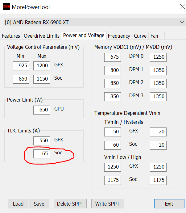

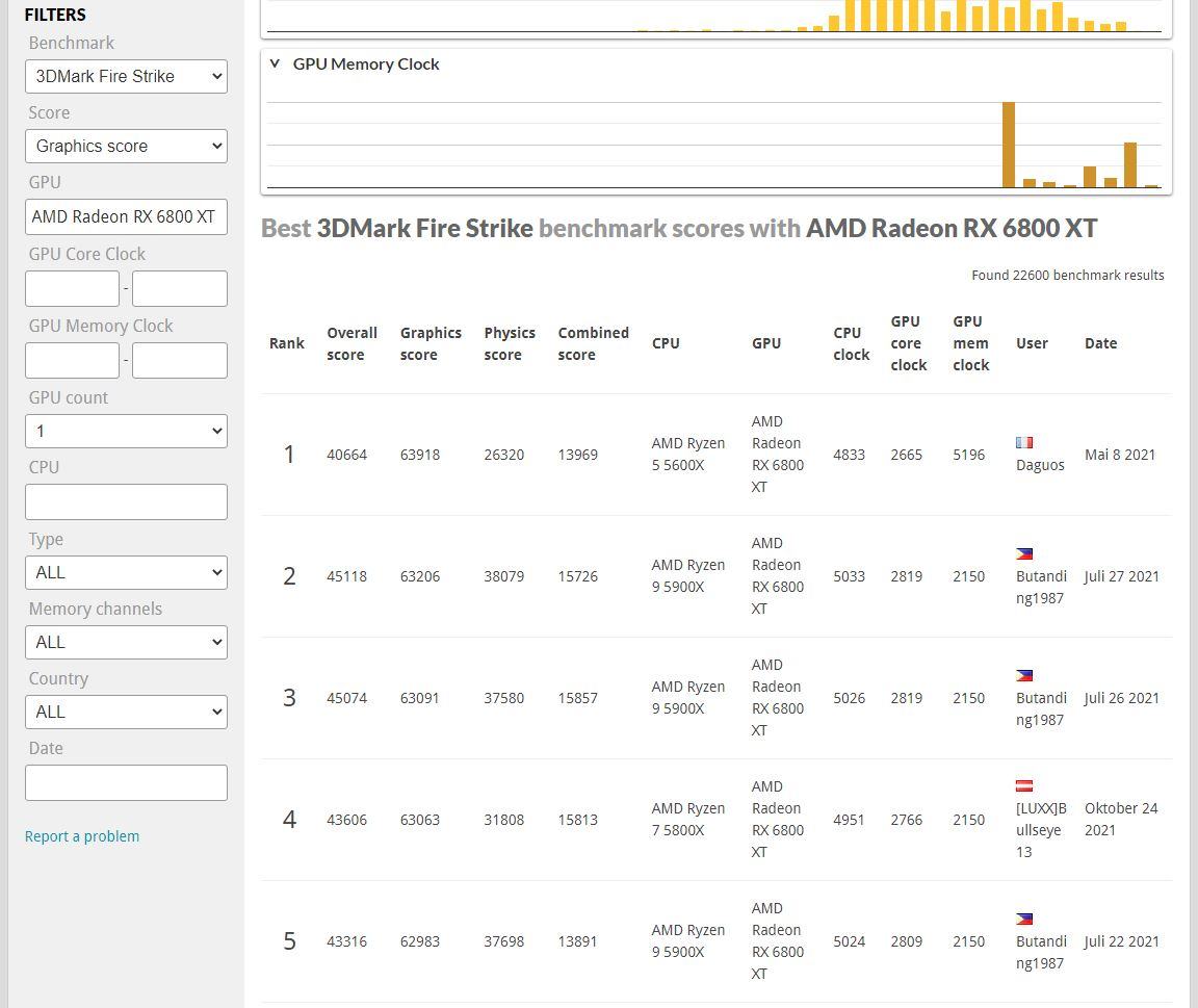

Holzi , try 1250 for gfx 1175 for soc rise power both by 100w and 100 A if You affeaid than on 50W/A
Under watercooling ?

Could the suddenly higher temperatures on my card have something to do with the 65A, I've only been testing it for a few days
Wouldn't it be easier to set it back to 50 or 55 amps and check?
