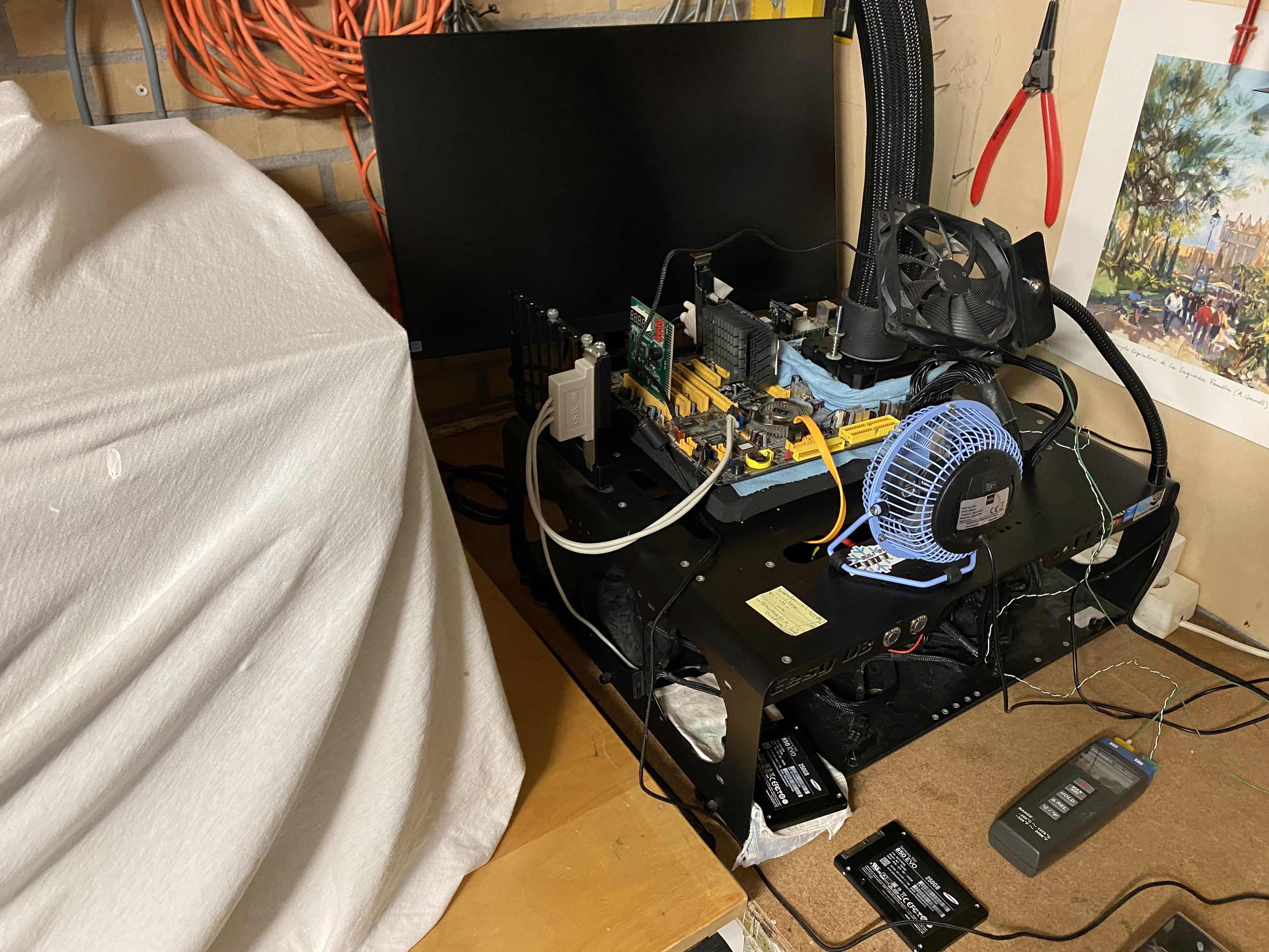

FX-57 AABCE 0516: 3755MHz max frequency validated @1.78 (1.76v CPUz).
It has a CBB @-41C (my sensor) and -49C on the SS head. So it will not post at colder temps. After a proper post I can go back to -60C. There is one but: It looked like it did not post @1.35v and it might do everything normal @1.60v and higher when running -60C.
So this cpu won’t run 4GHz at this temps.

I tested my 2nd FX-57 (CABCE 0538 GPMW) as well. Short test because my SS turned itself off after 1h.
Coldbug prohibits it from booting >1600MHz @-60C (head). Running it @-45C (sensor) and -53C (head) helps. Max boot so far was 3600MHz. I was testing 3700MHz until the SS shut itself down again…
Hard to bench like this. No idea where it tops out, but I think 3.7 would be max for booting.

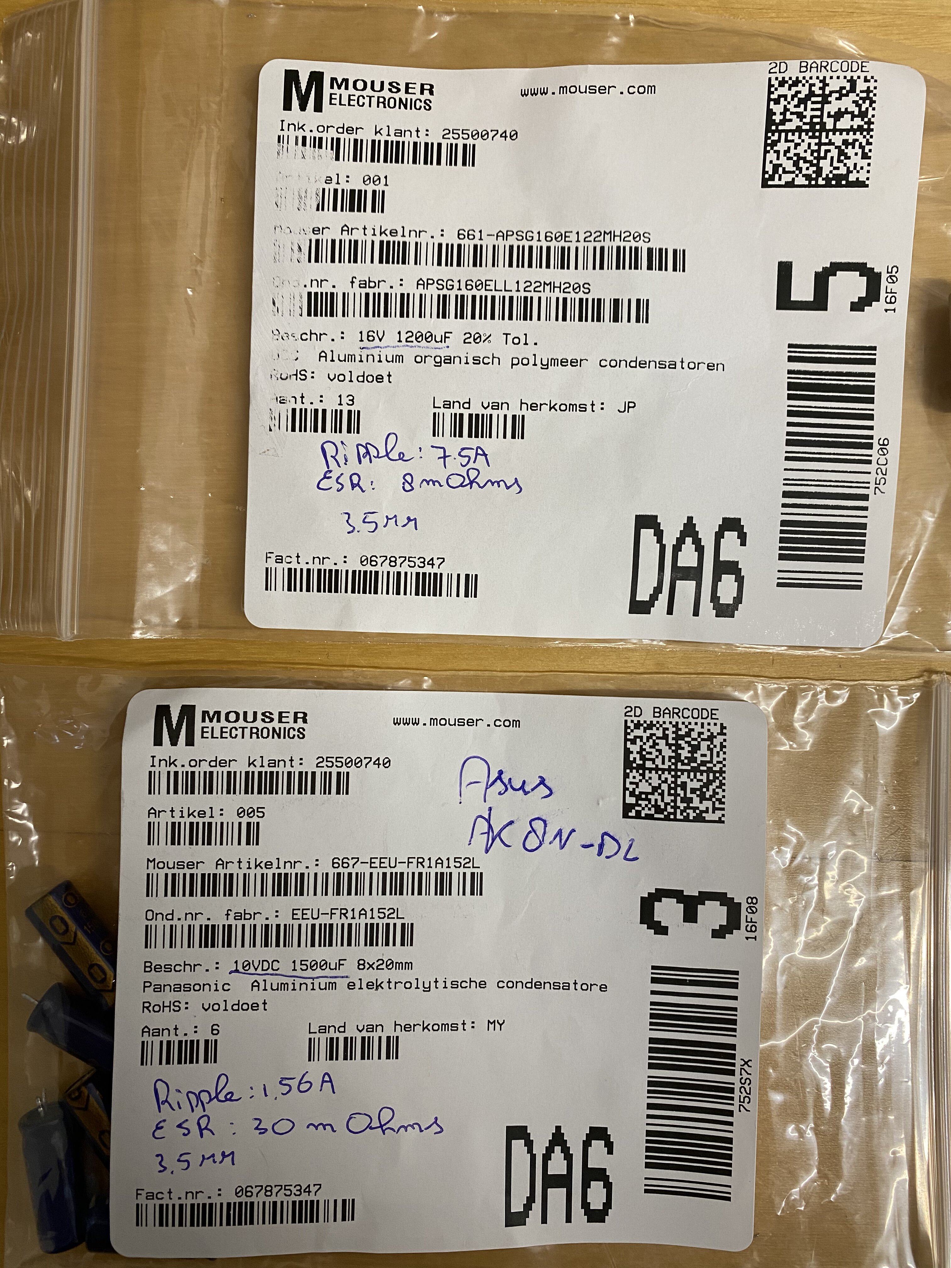

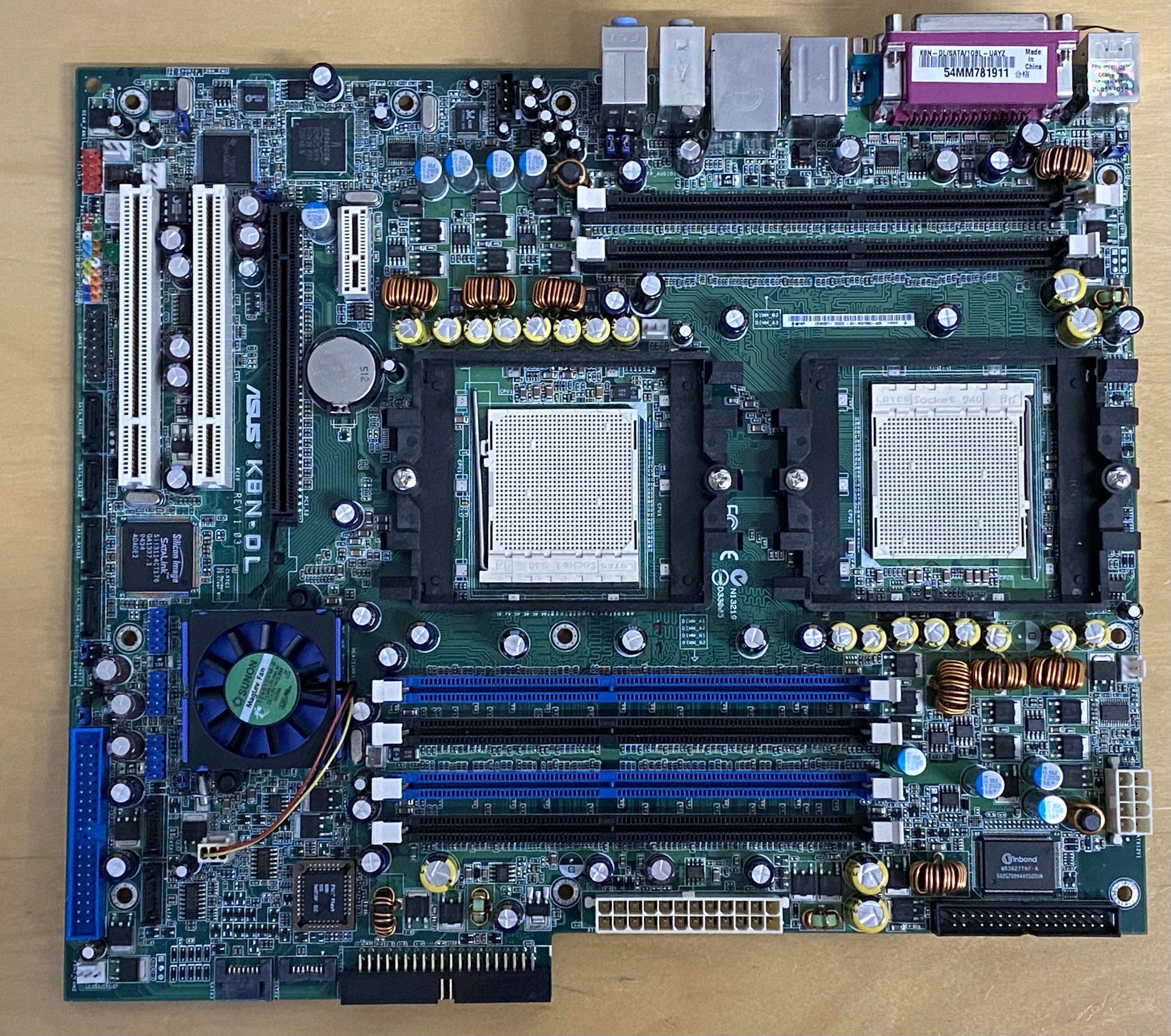

It finally came to it that I upgraded some caps for my K8N-DL:
Used so far for some OST and Some KZG.
For those 1500/6.3v OST’s I had 2 different type of caps as well, but I decided to take some FR’s.
This should be enough for running it again. Those 16v caps were really bad.

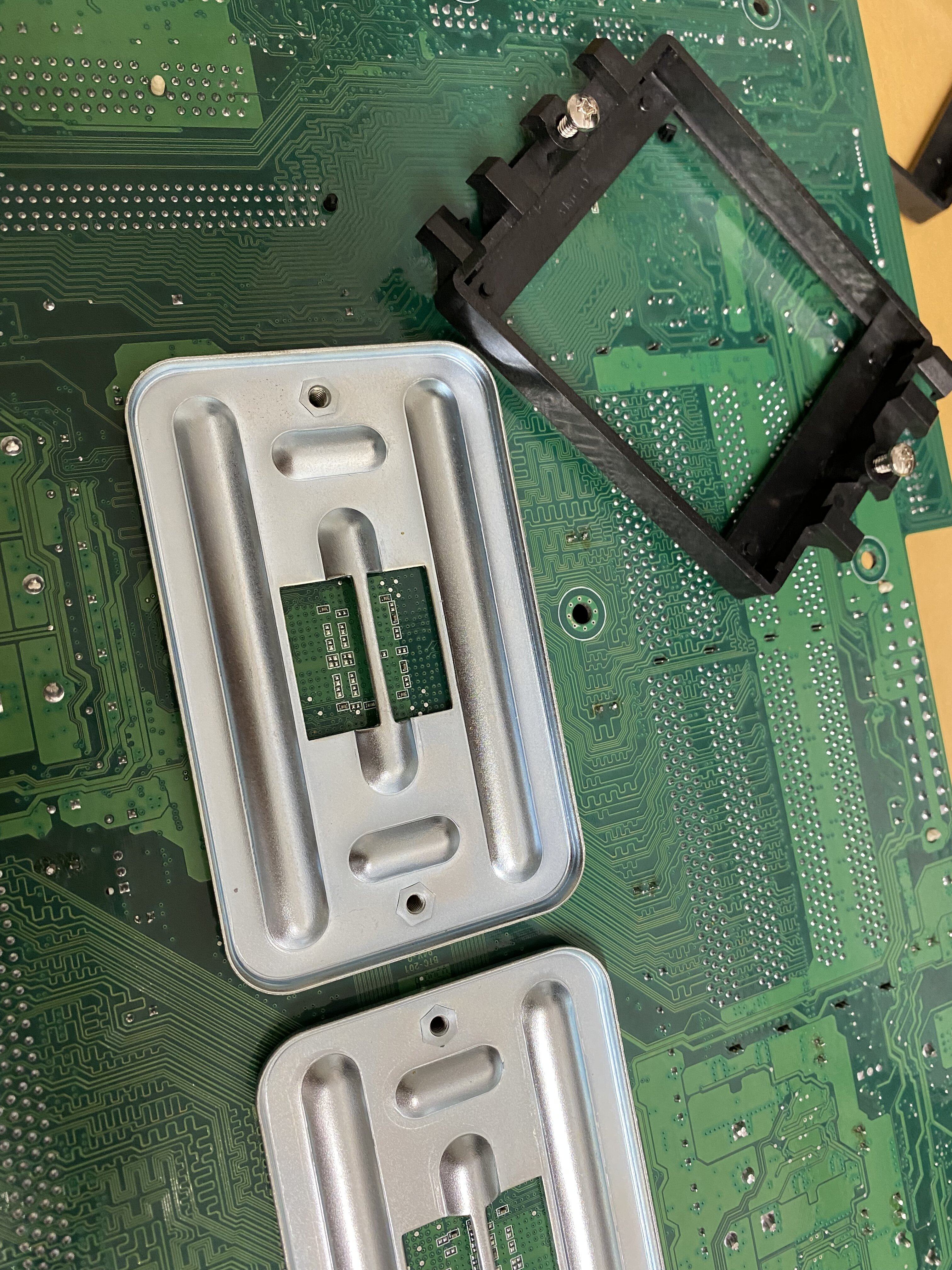

I noticed these are glued or stuck with tape. Do you have any tips for getting these off safely?
Maarten
I‘d try to carefully stick a flat plastic piece between the bracket and board. But only if you’re 100% sure that there aren’t any smd beneath it. Also some IPA or similar solvent might help weakening the sticky tape or glue.
There is something wrong with this board: No OS install possible. I tried 2x Win7 cd's and at least 4 Win XP.
I flashed to the latest BIOS, this did not solve it.
Even installing on PATA or my PCI sil3124 card did not work.
Edit: I think I found it, dimm issue. Other dimms work fine so far.

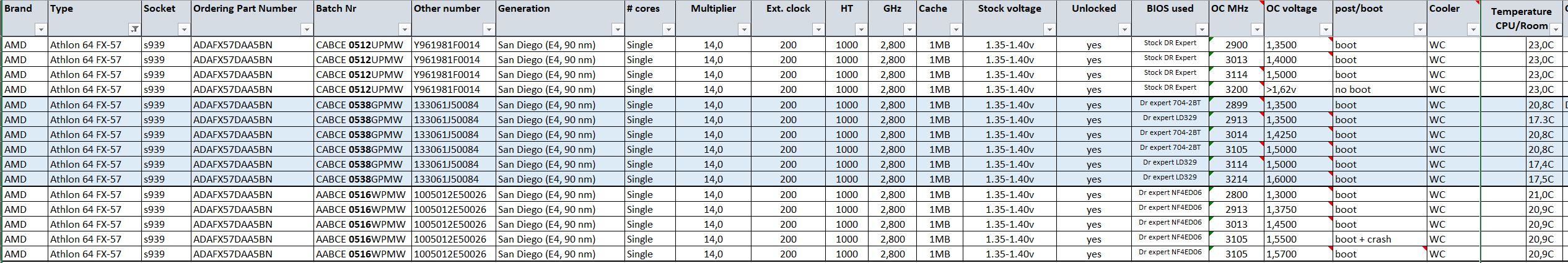

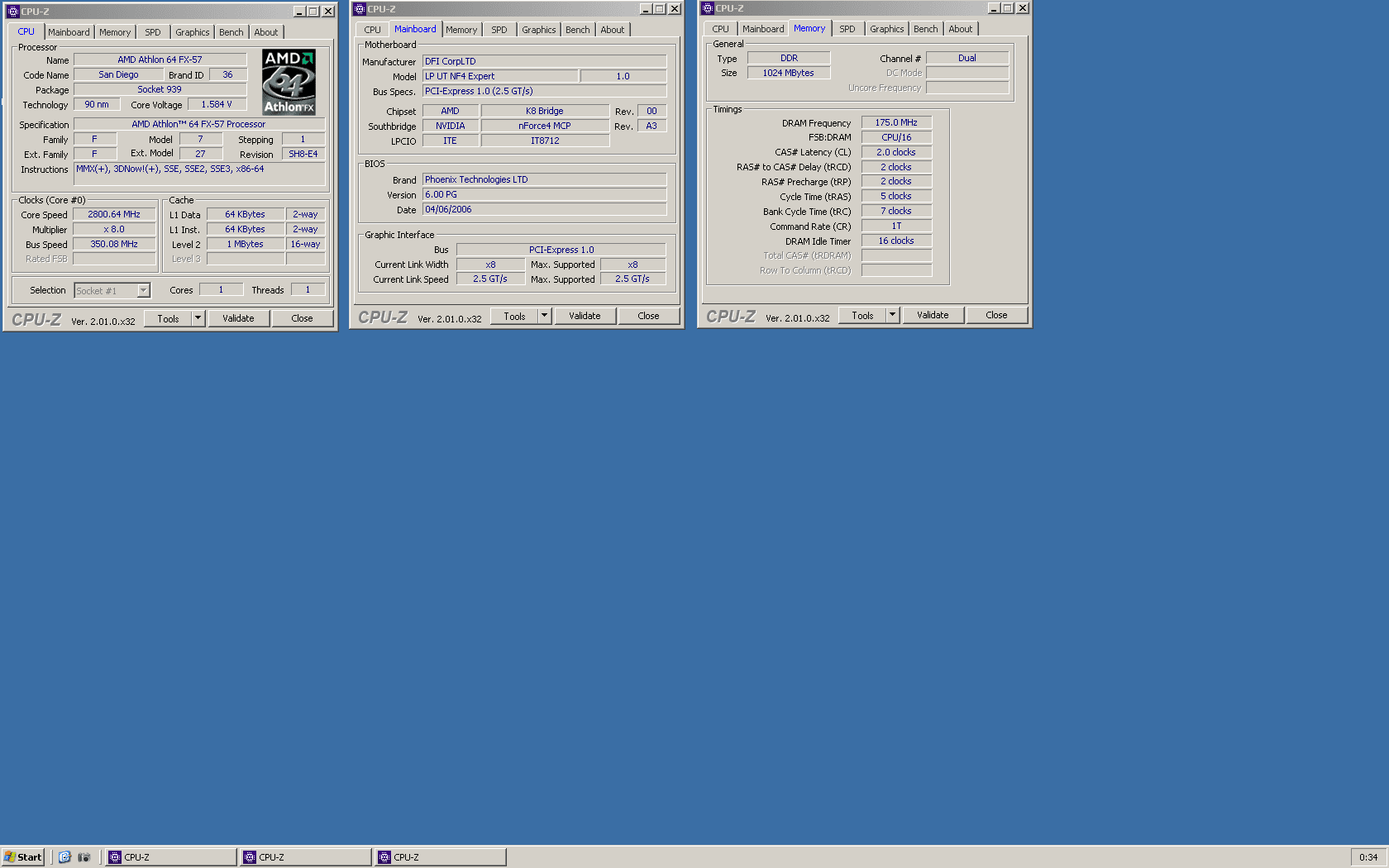

I finally found an FX-57 which is not cold bugged. The funny thing is this was my first FX-57... (and bought it for €15)
PI 32M run @3500MHz (not max speed)
Athlon 64 FX-57 (CABCE 0512) @2800MHz (8x350) 1.75v
Validated
WinXP_NF4_DR_Expert_Athlon 64 FX-57 (CABCE 0512) - 2800MHz (8x350) 1.75v - 2x512MB  - CPUz.png
Athlon 64 FX-57 (CABCE 0512) @ 3600MHz (11x327) 1.75v
Validated
WinXP_NF4_DR_Expert_Athlon 64 FX-57 (CABCE 0512) - 3600MHz (11x327) 1.75v - 2x512MB  - CPUz.png
No CB so far @-60C. And as it seems CB is far away. Is this correct to say?
Max speed: 3794.5MHz
Ja, das mit dem Cold Bug passt. Der FX sollte mit dem Referenztakt über 400 MHz kommen.
3950 Mhz sind eher möglich. 4 Ghz sind wie immer bei den Sockel 939 Prozessoren sehr viel Glück ! Das wirst du brauchen.
Let’s hope for a little luck then…
Oh and 400Mhz fsb did post. It just crashed Win XP.
Edit: fsb added
