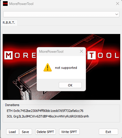

Ich habe eine Powercolor 6950XT Red Devil
AMD Treiber 22.11.2
Neueste Version W11
Wir wollten meine Karte unter dem Tool MPT optimieren .
Unter GPU-Z das BIOS extrahiert. Allerdings lässt MPT nicht zu das ich das Profil reinlade , auch hab ich nicht die möglichkeit oben eine Karte auszuwählen .
Also MPT findet meine Karte auch garnicht.
Wir haben auch den BIOS switch Schalter betätigt und beide BIOS ausprobiert . Es klappt mit keinem von beiden .
Um einen Treiber Fehler auszuschließen wurde der Treiber via DDU deinstalliert und einmal sauber neu installiert
Hatte hier schon jemand einen ähnlichen Fall und kann mir weiterhelfen ?

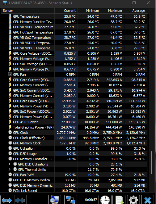

Ok! Nothing untoward straight off the bat...just idle temps at the moment...water temp at 22°..wnt be able to go much lower than that weather depending...temps pretty close together and not much above coolant temp..a good sign! Nothing abnormally high or anything..so I'm hoping my repad holds up! See how they go under load!
Ok first run....I thought I clipped my timespy score but i didn't...24 418 was looking for the screenshot 😆
444w....does that hotspot temp look a little high considering? In relation to that power draw?Or that delta isn't to bad? I was hitting 90c on the aio with a lower clock frequency also but also less power.
All I have changed is the power limit and disabled DS stuff.
Oh and I noticed on the latest driver...I have rolled back to the one you sugges⁸ted..but on the latest driver TGP and something else was greyed out in hwinfo? Is that normal? Is that a locking of some sort?
Anyway not the best day for me to use the chiller to try really hard....might see what happens tonight!
Oh water temp was between 22-23 degrees..so only a couple below ambient here...
P.s....not gonna get any runs in tonight..its quite humid and warm...but I looked back on some of my other runs with the 6900xt waterforce and those runs were on 8°c water temp..hotspot on those runs was 70°c and gpu was 42°c..that was at 530w....big delta there....but a positive...I think the temps will be better on this other card..e.g 67°c hotspot and 47°c gpu at 444w-20°c delta...but with 22-23°c water...

@Grindcore77
Relation between GPU and hotspot are 20°C - this is ok. And the absolut 67°C for the hotspot is good. If you get this for 444W I'd say that your cooling system is ok as well.
In the past there were few drivers which had something weird at the power consumption display with TGP and ASIC etc. I didn't fully understand (wasn't interested in these discussion).
What is your goal? See the maximum possible with your card? If yes, then continue with my OC tutorial and proceed to the higher voltages and high FCLK. Where are you located? Any chance to get the water temperature down to winter outdoor temperatures far closer to 0 degrees?
Thanks for the reply! And info.yeah I wanna try and push this thing to the max..😆...
I'm in Sydney Australia..so now...middle of summer..quite humid and warm...we've had a lot of rain this summer as well....the chiller I'm using I've had down to 3°c on a good day...and my best run on the previous card was 8°c...the lowest this chiller can go is about 2°c..but you can actually set it to 0°c the manufacturer said something about one of the parts in it not being able to handle that temp...but quick runs probably not so bad..and the coolant wouldnt stay that low under load anyway...but those temps I think only in autumn/winter....
We don't get the winter temps you get overthere! No snow...nothing like that haha! So I'm already behind the 8 ball against you guys 😆😆😆
Ok, there is not so much difference between 0 and 2 or 3 degrees. You would profit from each 5 degrees which you can lower your water a lot. So if you can get your water down to about 5°C you will see a difference in performance and stability. And then I'd attack with the voltages. Good luck!

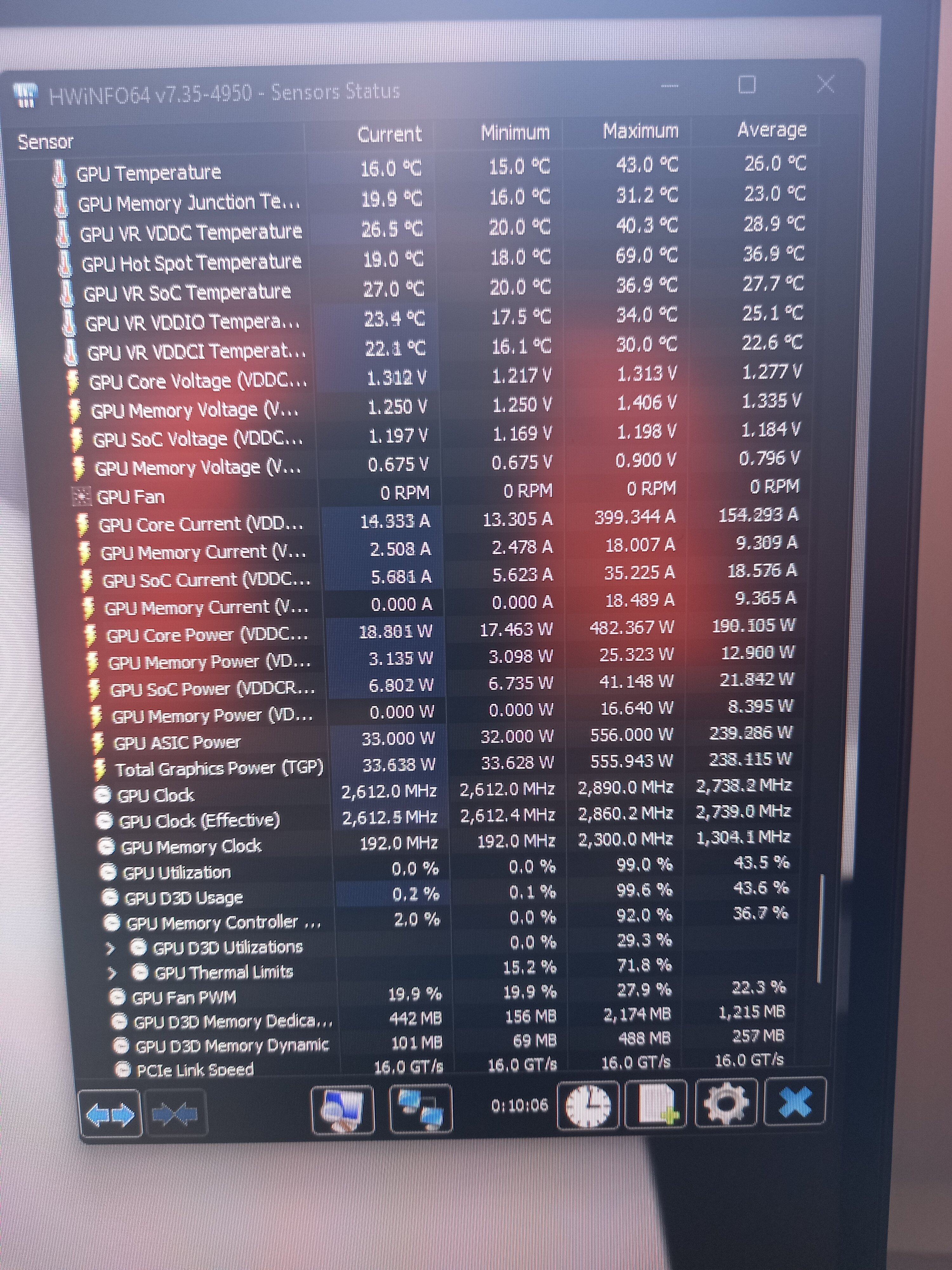

Had the chance for a couple of runs today....temps all very good for nearly 556w...
Excuse the photos!..just cracked 25k with these settings..just gpu and power limit/voltage
Chiller was at 12°c....so hoping to get it lower...maybe tonight I'm not sure...at least a run or two at 5°c...
I've tried upping the mem from 2300mhz but doesn't seem to like it...but gonna get the core sorted first then crack on with the memory...
In relation to the other card at 513w I was hitting 72°c hotspot and 42°c gpu temps..
Mem jnct temp 60.5°c...and that was with the 8°c chiller temp.

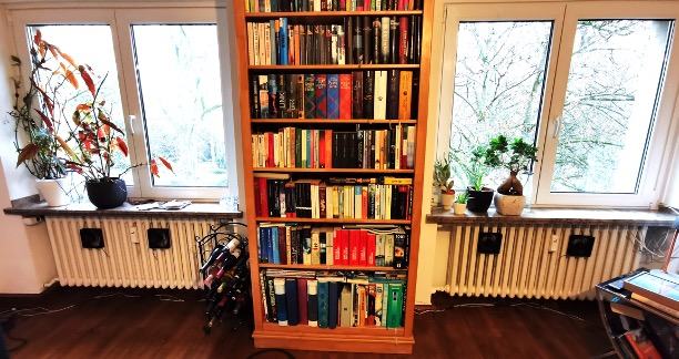

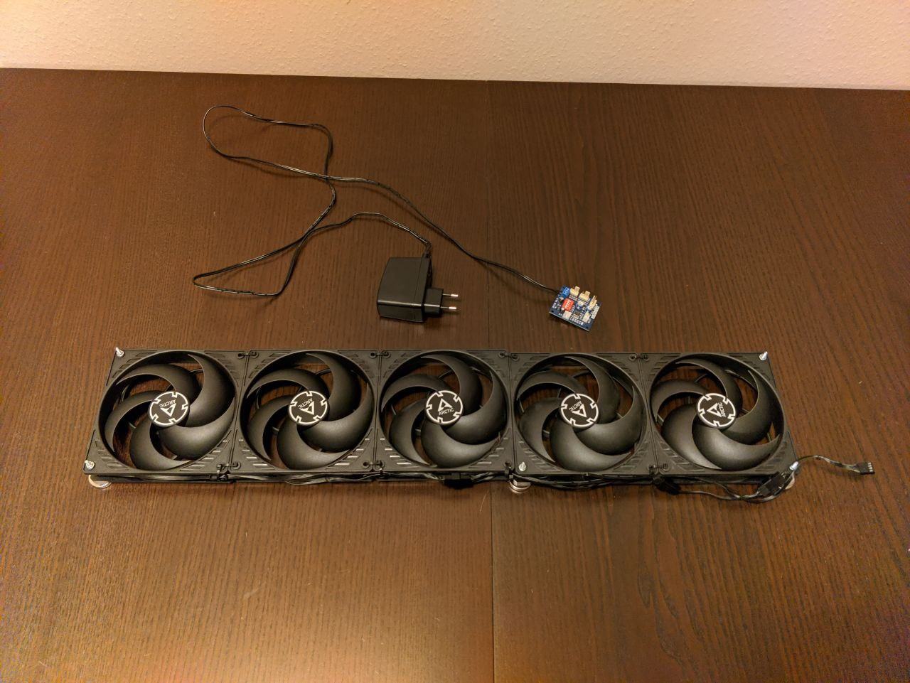

Während ich grad auf einen Thermosphere GPU Kühler für wieder mal was verrücktes warte, hab ich mir grad Deutschlands größte Wasserkühlung gebaut. Äh, hm, naja, so ungefähr... nur wird damit grad eine Ölheizung gekühlt :-)
Ich glaube es wäre effektiver, die Lüfter unten anzubringen und nach oben blassen zu lassen! :d
Jetzt gibt's schon einen Mann mit Buch in diesem Thread, und dann macht er das Bild so klein, dass sich die Titel nicht lesen lassen ....
:rolleyes2:
So ein Addon habe ich auch unter der Heizung im Arbeitszimmer:
Geht 2 Jahre altes LM noch klar?
Ist das von TG.
Wenn es nicht Hart ist und aus der Spritze läuft ist alles gut
Hilft das wirklich?
Bei mir an einem Plattenheizkörper funktioniert das gut. Meine Altbaubude ist sehr schlecht "isoliert" (>250kWh/m²a) und das Arbeitszimmer, was eigentlich ein Schlafzimmer ist, hat drei Außenwände + Flachdach. Wenn es im Rest der Wohnung angenehme Temperatur hat, hats dort 17-18°. Zum Schlafen mag das ok sein, zum Arbeiten aber nicht. Mit den Lüftern komme ich ohne Probleme auf 20°. Natürlich ist das nicht unhörbar silent, aber da eh den ganzen Tag Musik läuft, ist das auch egal.
Edit: Netzteil ist von meiner gestrobenen Fritzbox, China-PWM-Controller + Magnete von Amazon und die Lüfter gebraucht hier ausm Forum.

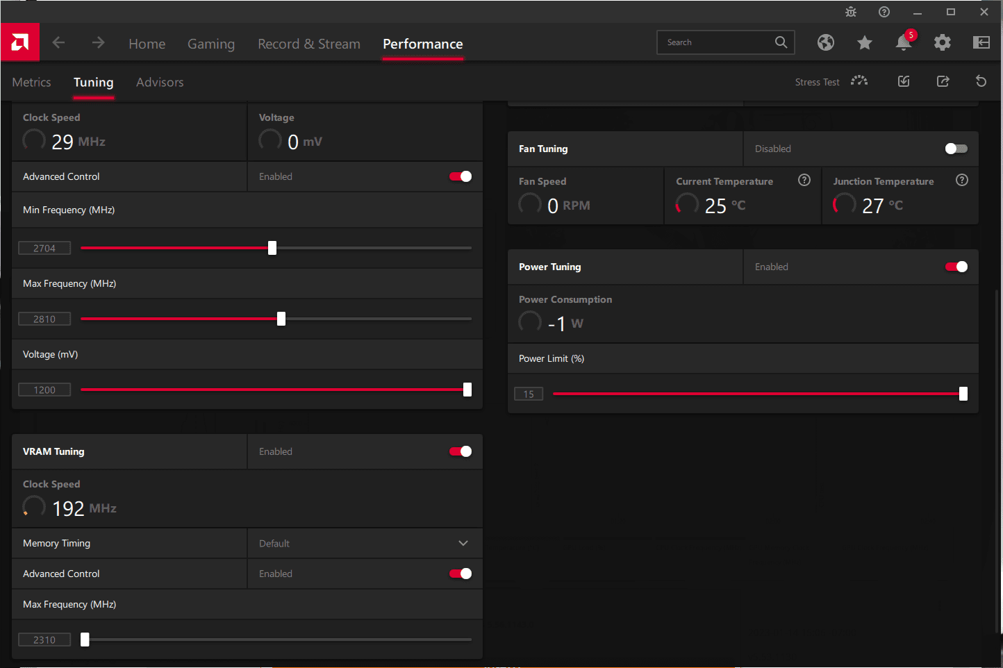

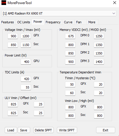

Heya guys I'm gonna do away with adrenaline and use more clock tool ..if I set the temp vmin in mpt to what I want then I use more clock tool do I have to adjust the gfx voltage in there to what I set my voltage to in mpt? At the moment in MPT I have it set to 1.275 but MCT shows it at 1.200...cheers for the info!
MCT asks the driver and got the correct answer, the maximum voltage is 1200 mV. It is no hardware monitoring. Since you use TDV, this setting overrides the maximum voltage, so the actual Vcore is higher than maximum setting. Everything is fine.
