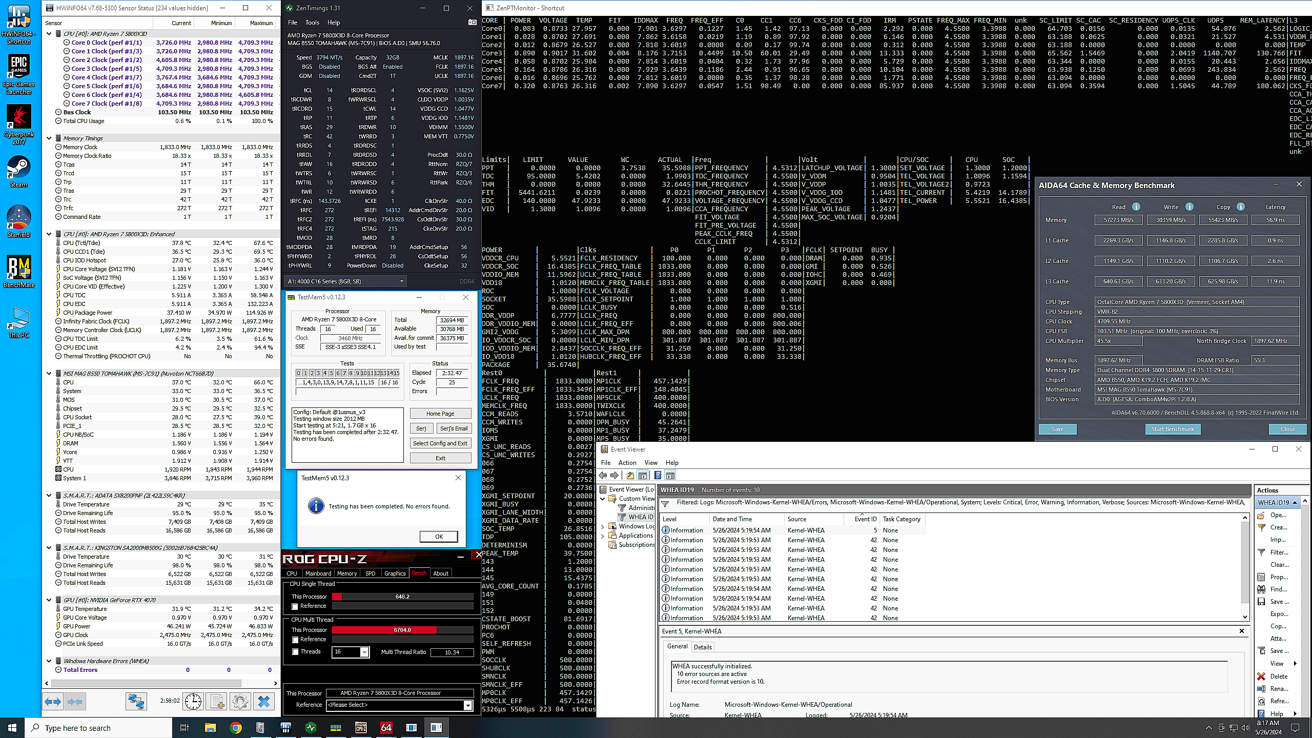

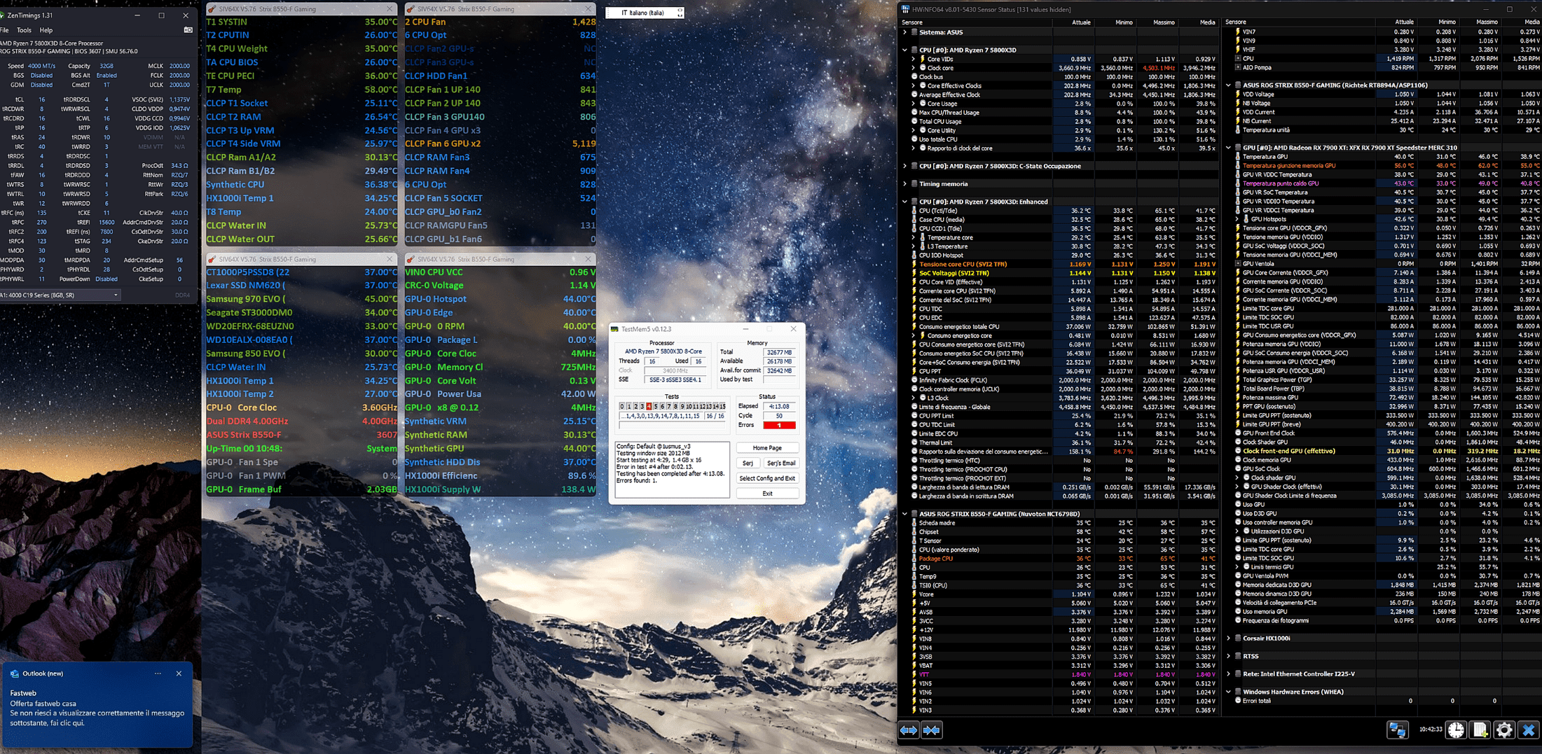

Sure, got 10 pieces Kernel eachtime after boot 9x 42 & 1x 5 here screen after boot,
Yea each #42 counts as one sensor-loaded log
a #5 counts as sensors utilized log.

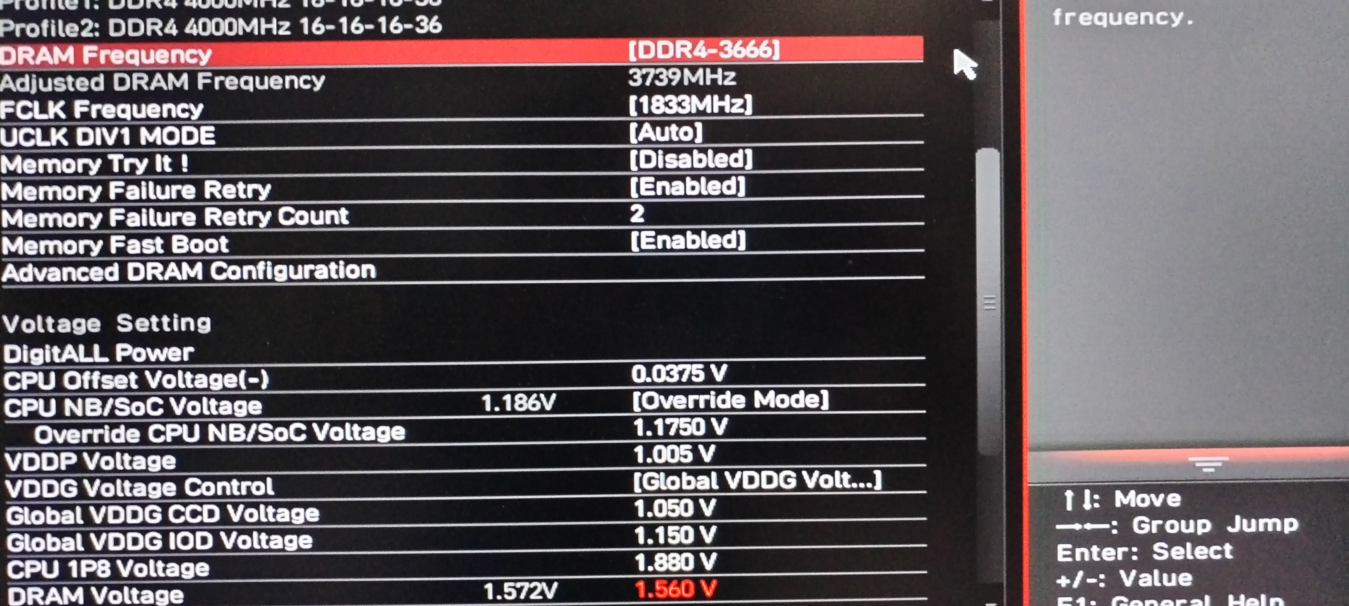

Ah, to the end and just to share some curiosity regarding AM4: I've solved a lot of boot problems (when changing some little voltages as for CCD and IOD, like 0,001V) simply moving the bios ram test from 3 to 5. ;)

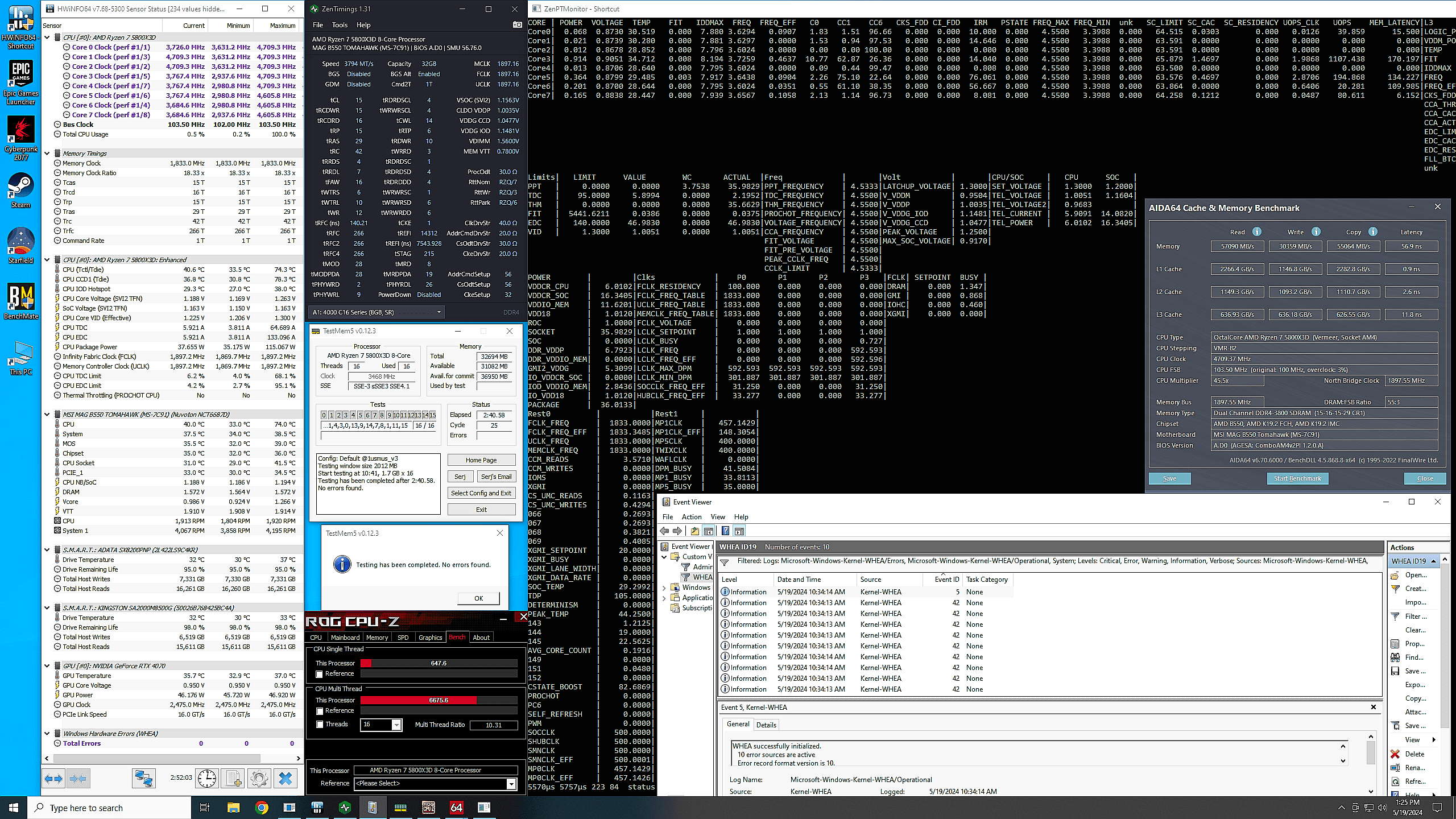

Your last 1usmus #4 error posted in OCN, no.17 wheas in only 1min30sec cruncher Benchmate 2.5b and also thousands in VT3 combo, means a lot IF instability to me, as 14 iteration VT3 failure, guess about how many wheas you can found in N64, if you can be able to pass it, but surely y can not 🤕
So be aware HWinfo can easily lies in wheas report during TM5, don't forget to keep open Event in Verbose checked by Kernel Wheas Range Time next run 👍

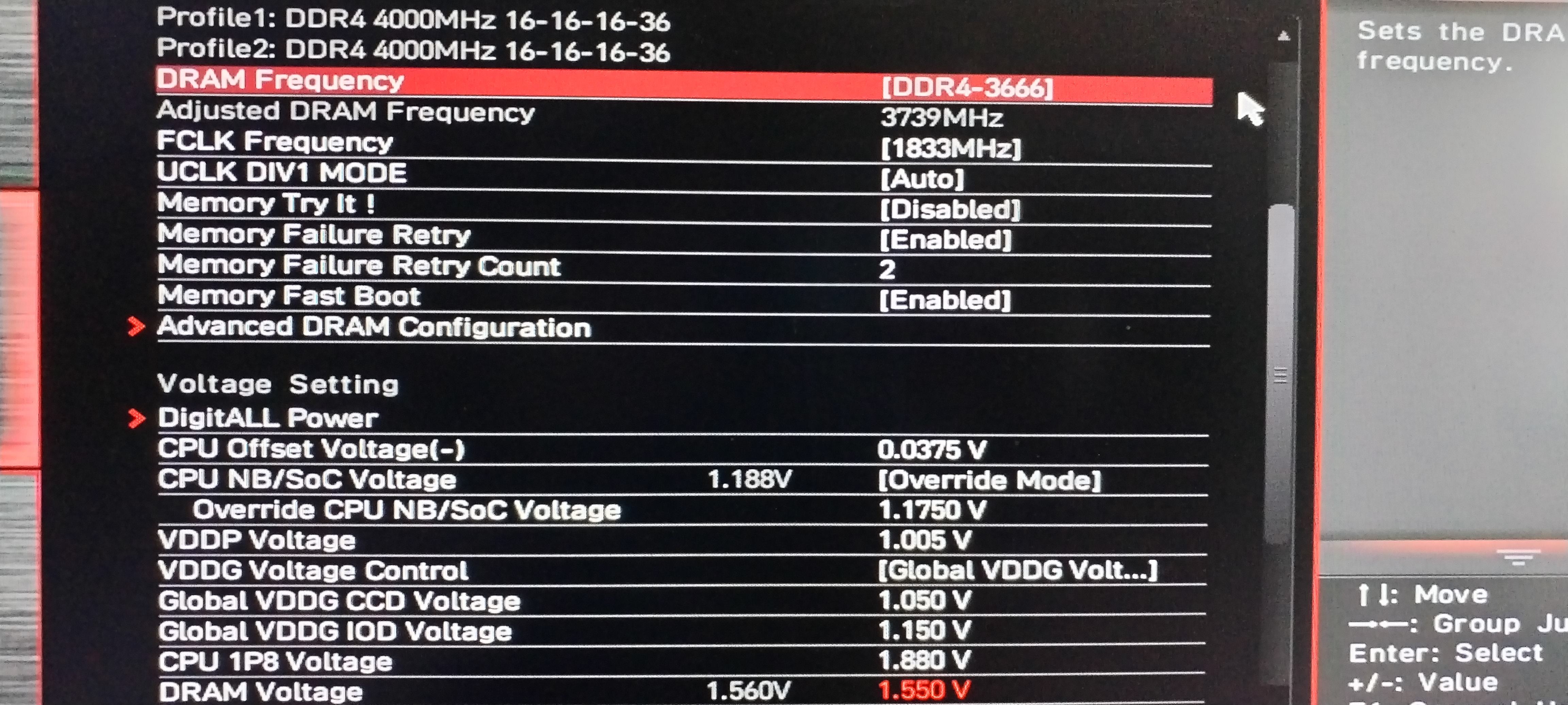

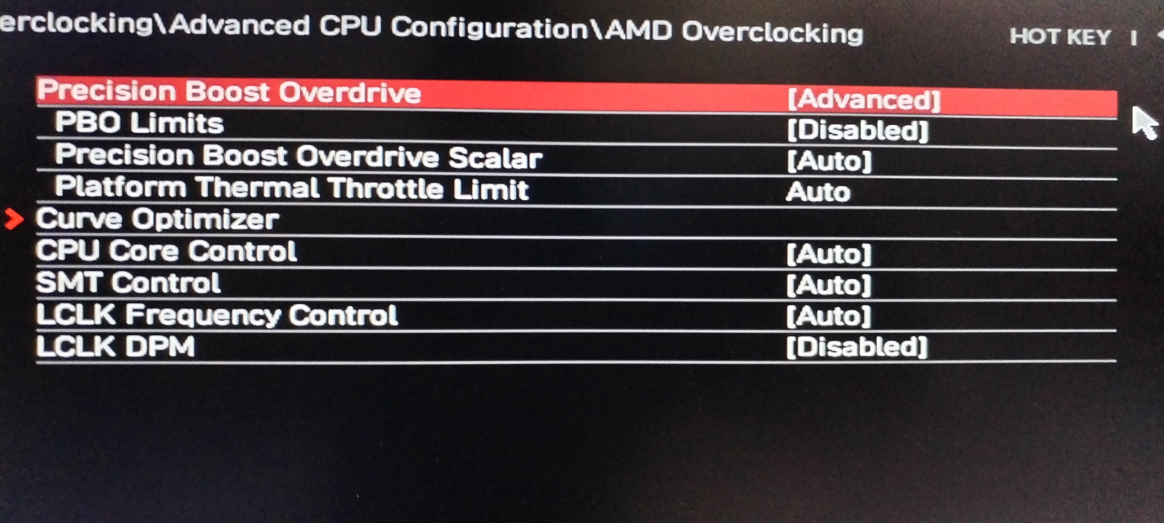

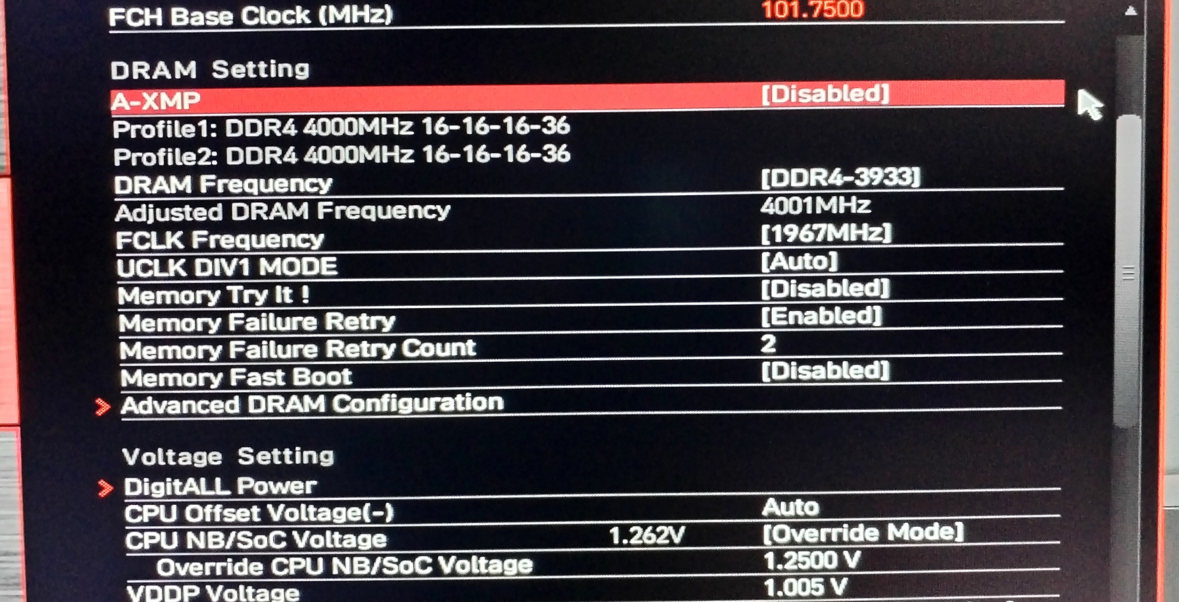

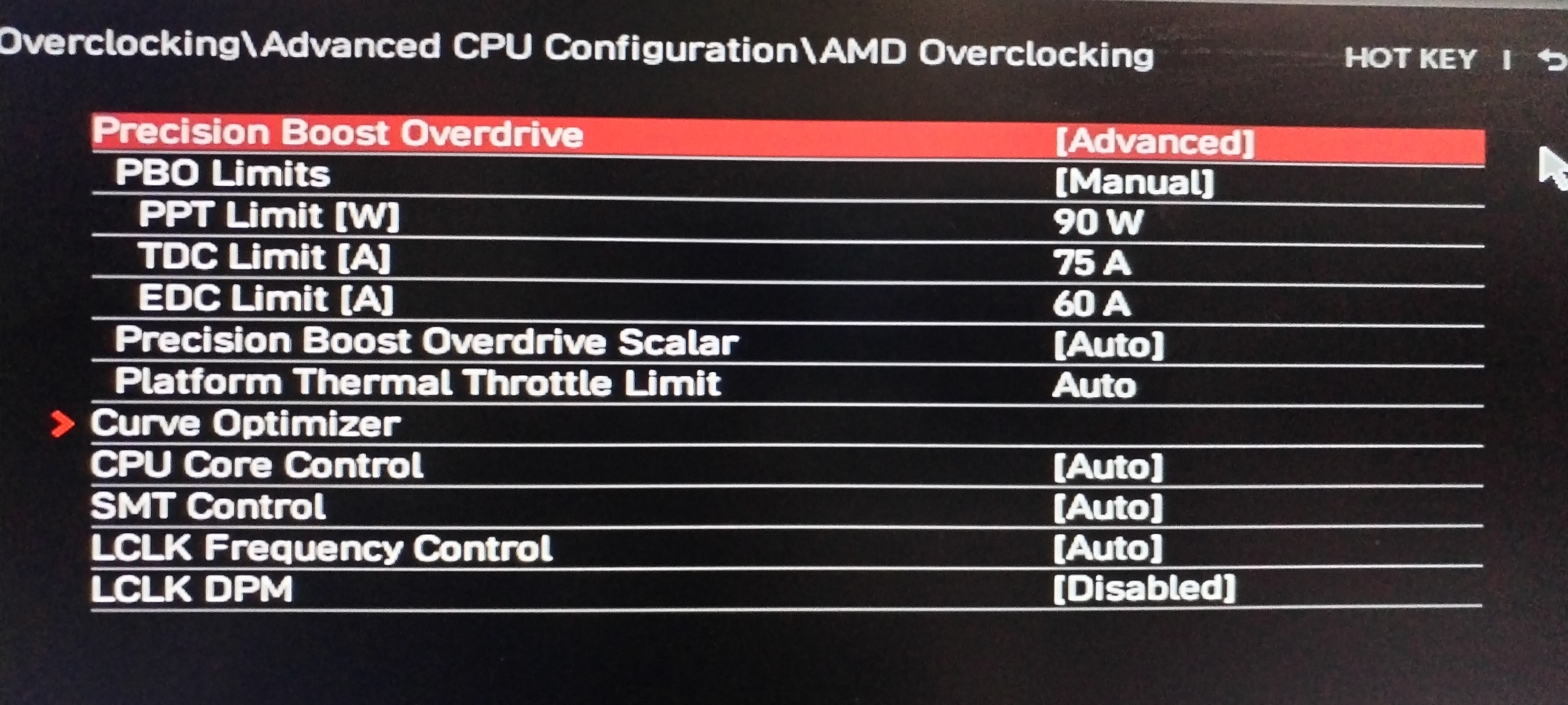

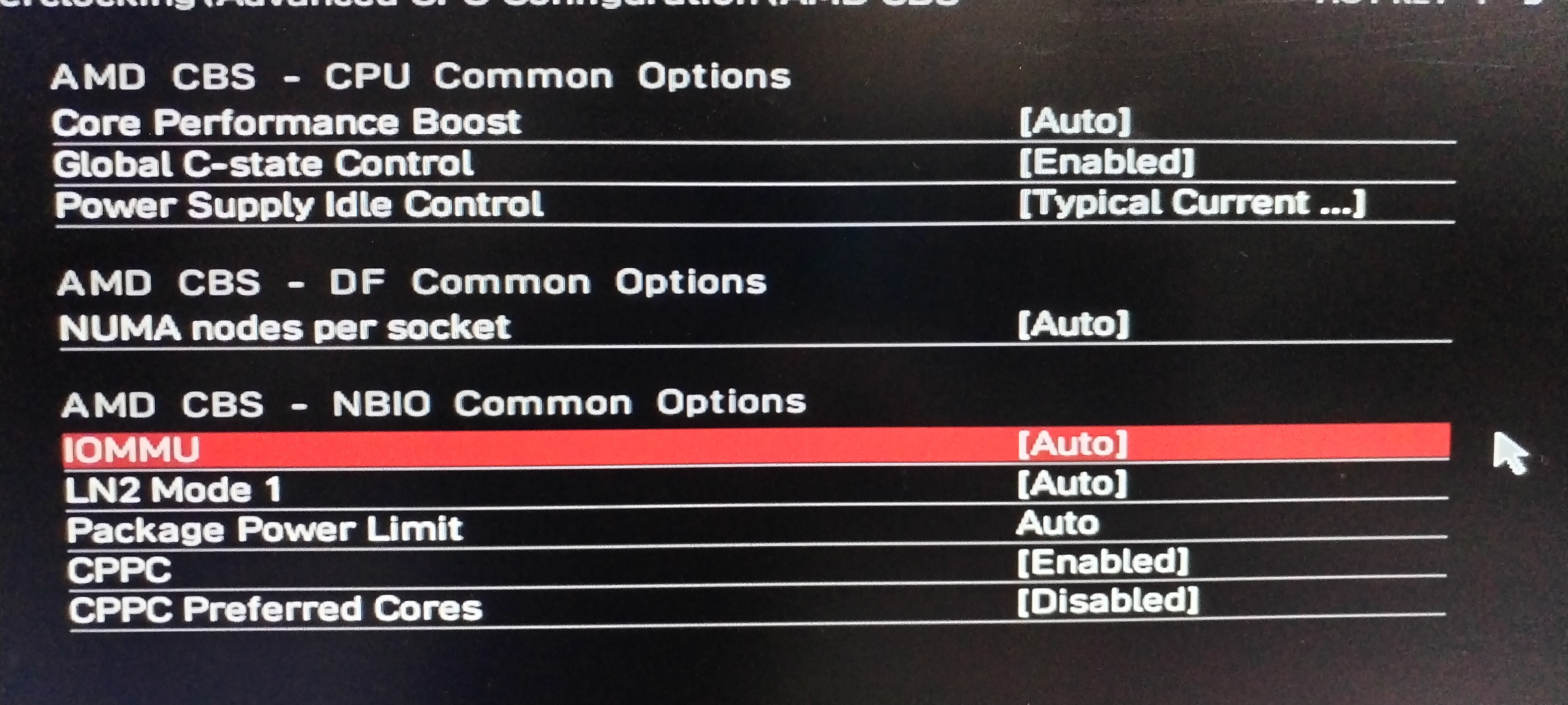

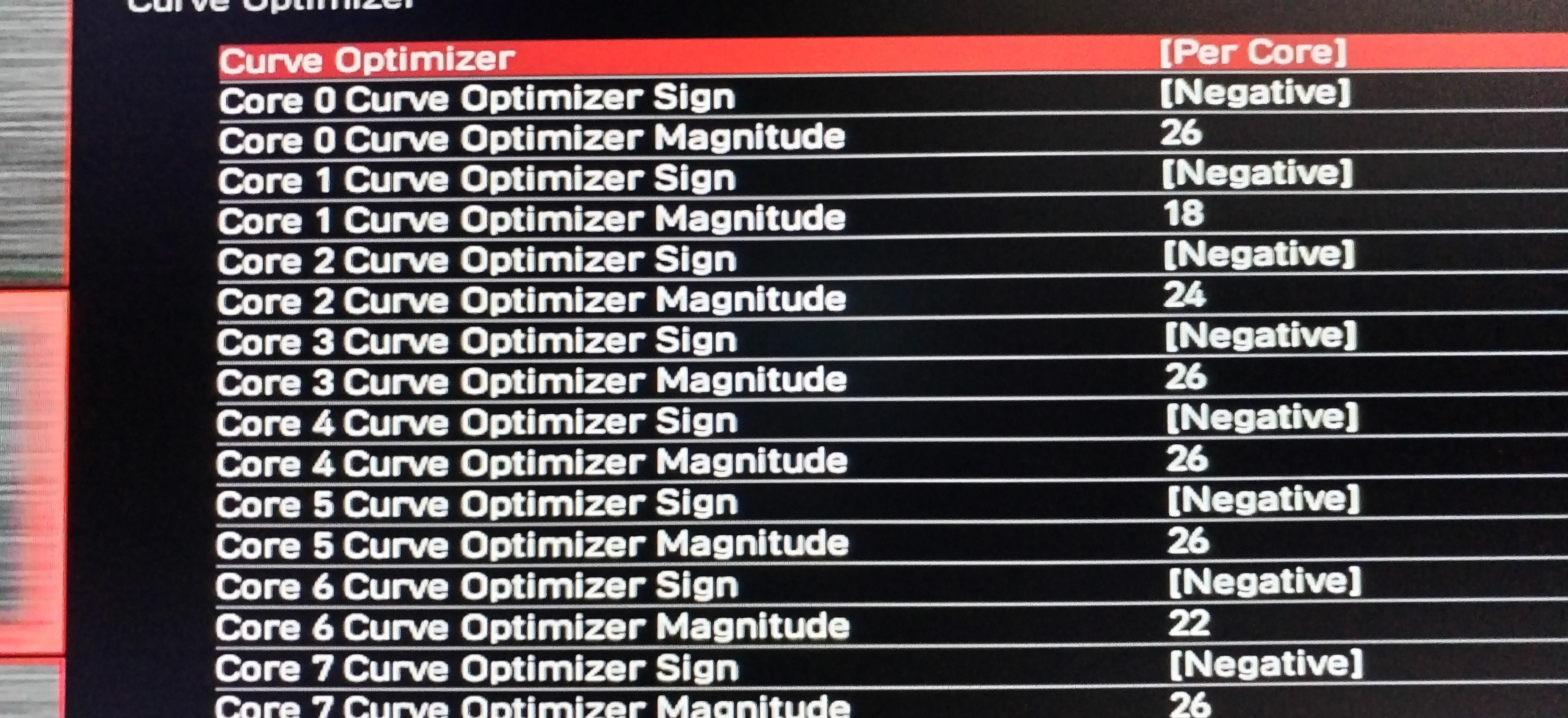

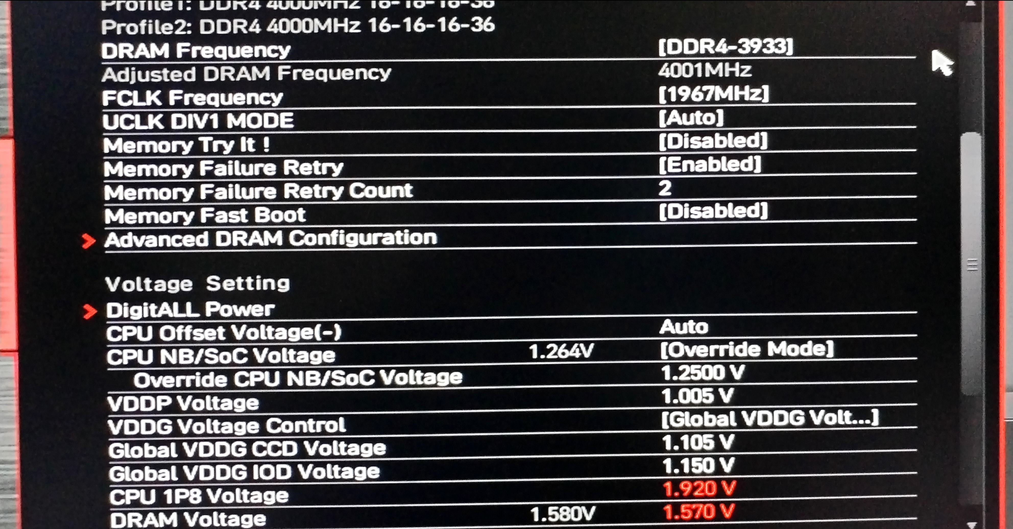

Here some mine's IF2000 Bios settings to compare👍

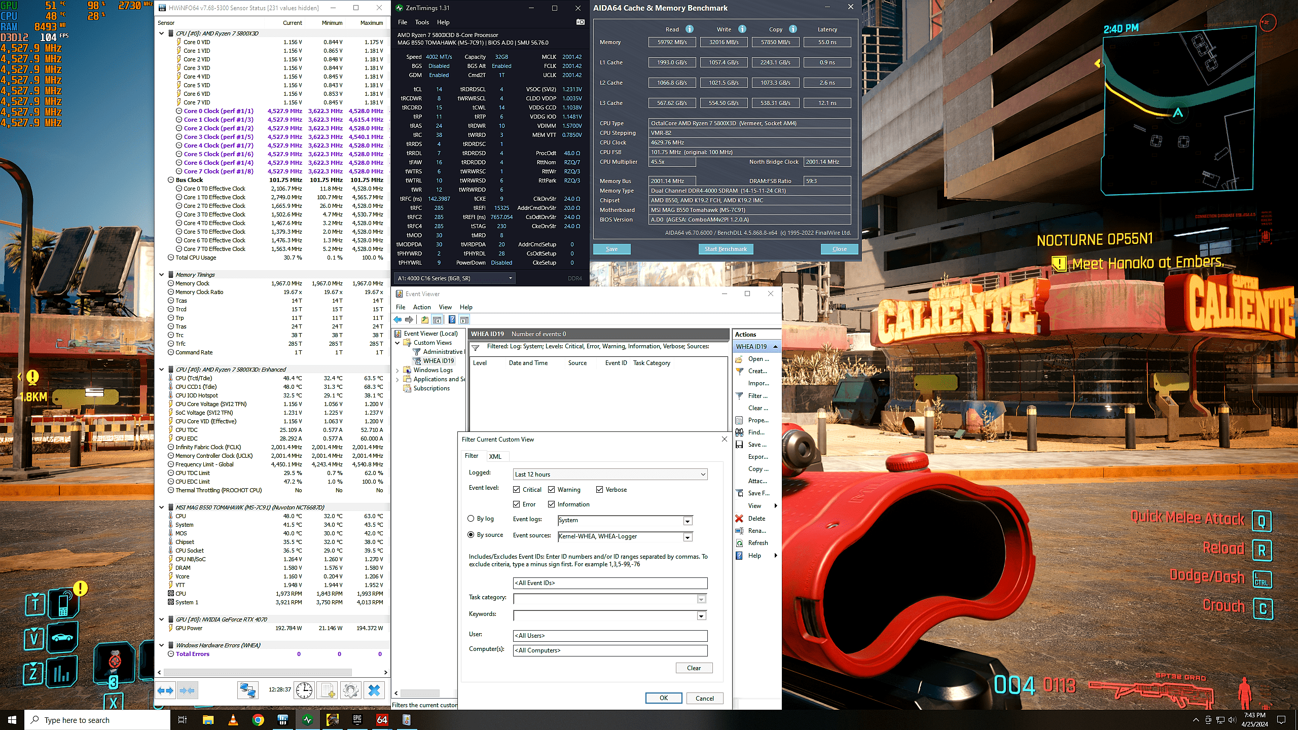

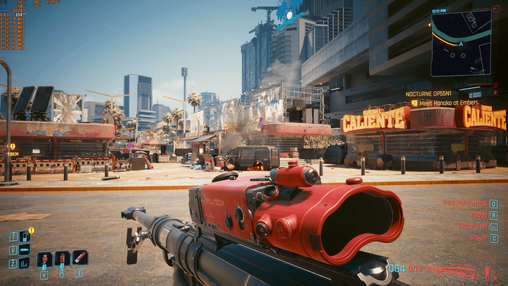

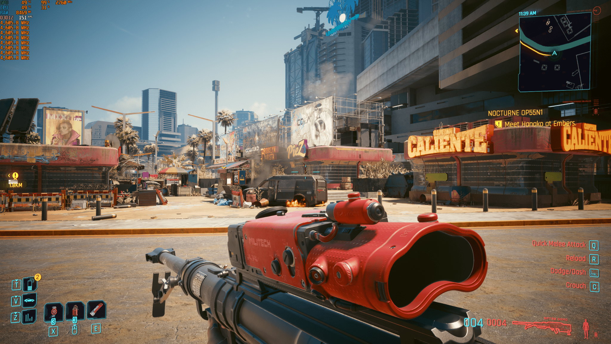

Hi, that's an example for @Lic as IF2000 wheas free for gaming only is possible, as I found EDC limits over 60A will land you in wheas party, surely not for daily or benche's, but just fine for extra FPS, won't hurt from default cpu settings in extra long-gaming session 12h and not limiting performance by wheas penalty indeed, daily apps stick with PBO=Disabled 3800 4,7mhz👍
  • CP2077_5800X3D_4000CL14_GearON_101,75_PBO 100-70-60_CO-PerCore_LCLK DPM off #.png
  • CP2077_5800X3D_4000CL14_GearON_101,75_PBO100-85-60_CO-PerCore_LCLKDPMoff.png

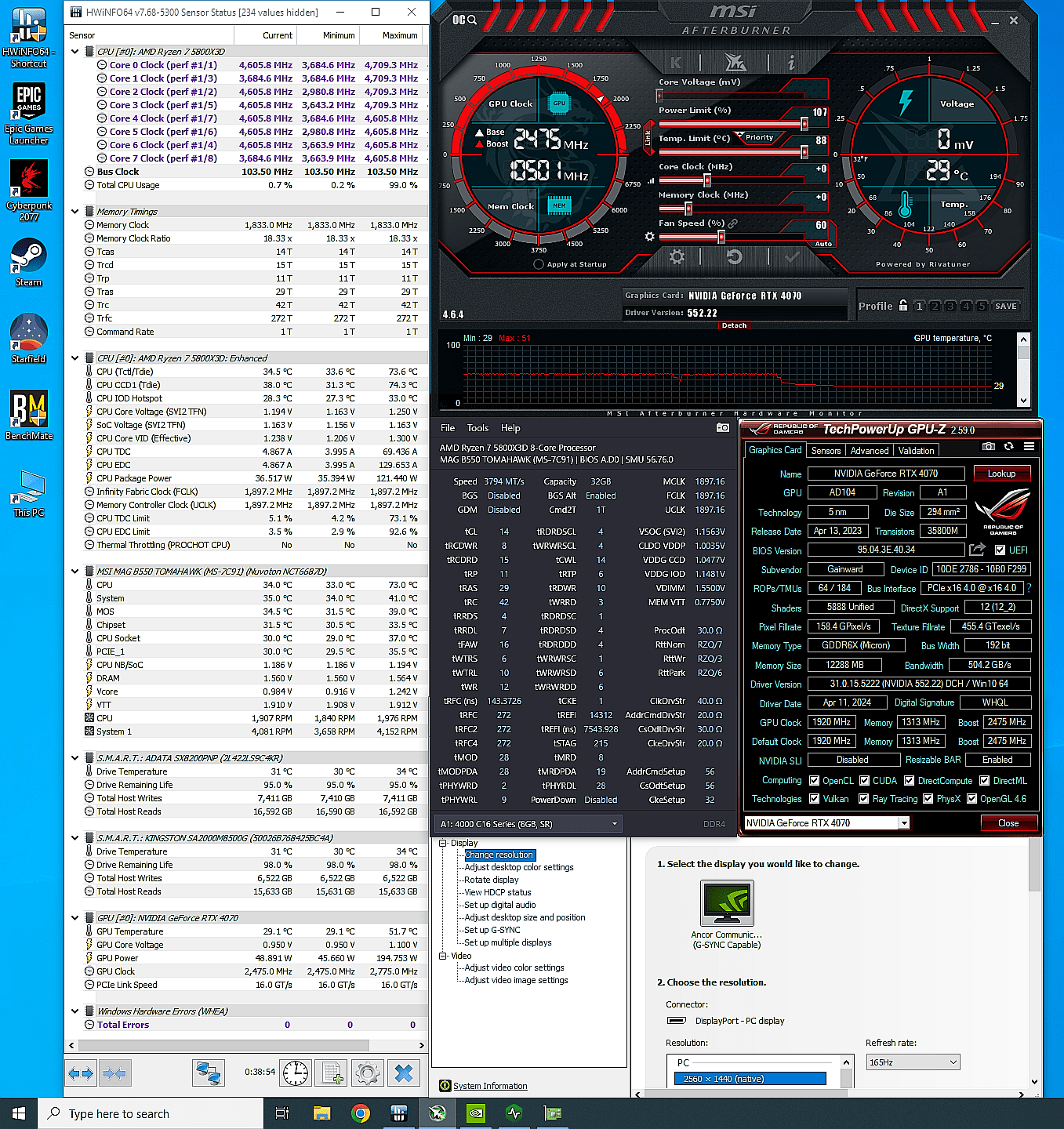

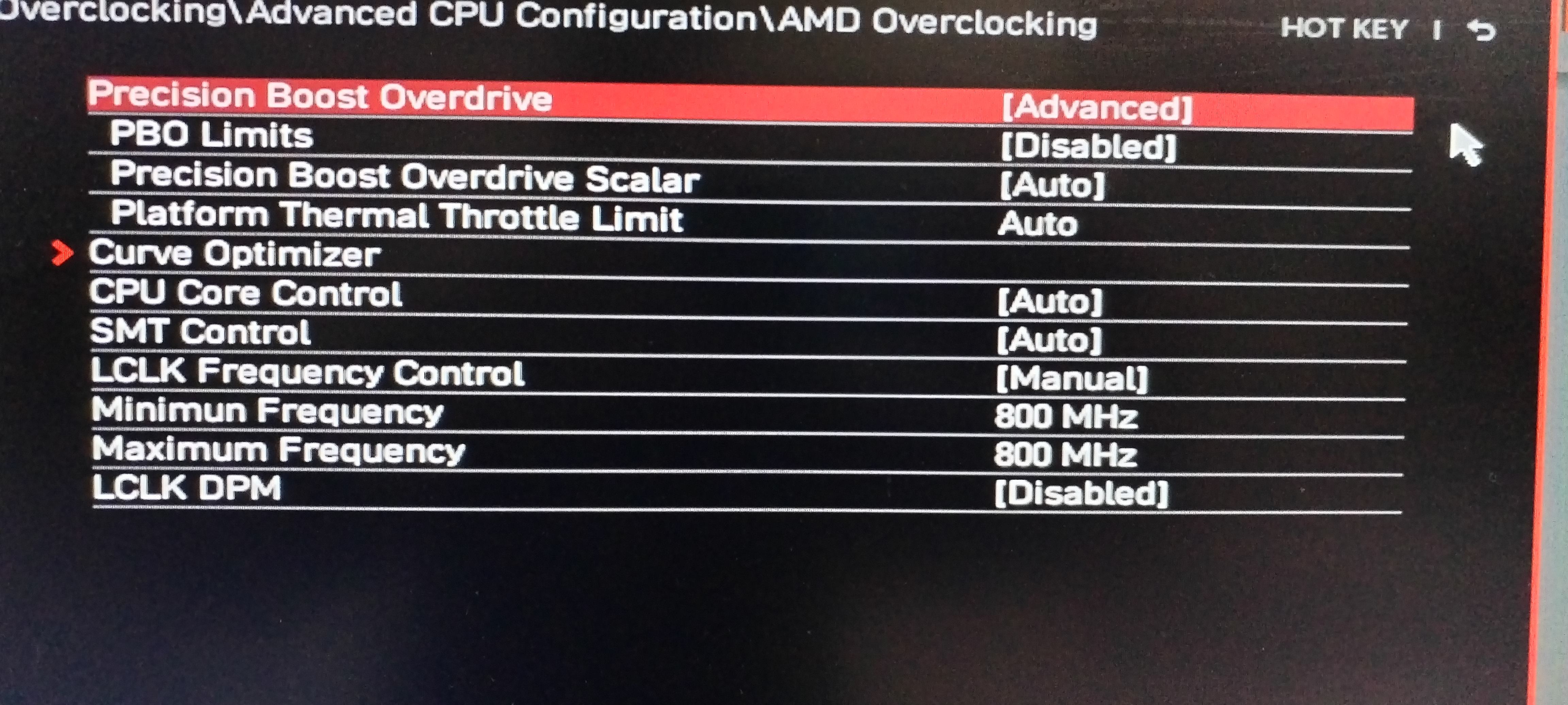

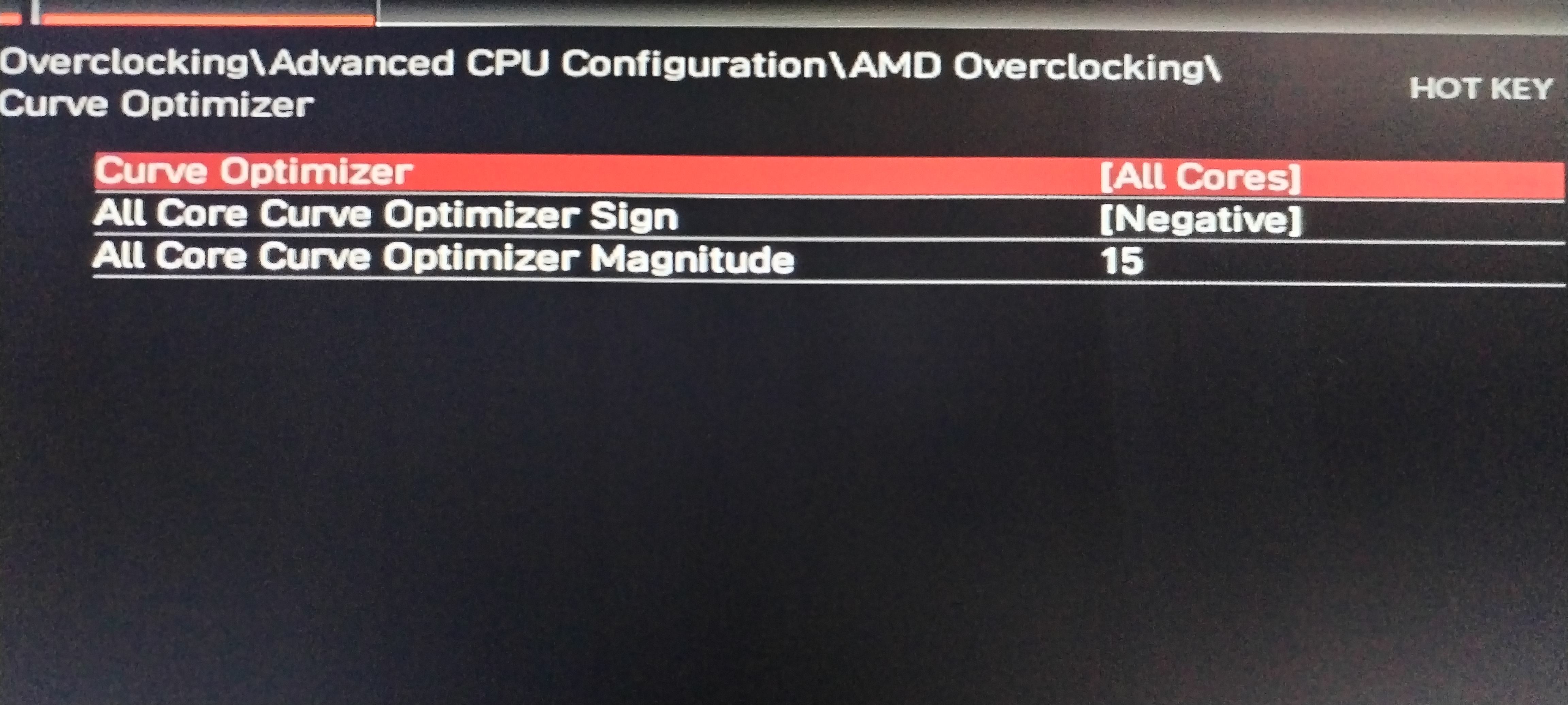

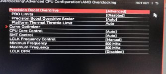

Hi guys, great update, fresh NEW start from origins, 3800CL14 pure 1T LCLK min/max 800 capped out of the box, just reflash same Bios Agesa 1.2.0.A & fresh Win10 reinstall indeed, bring me my precious 4,7mhz & L3 cache back on BCLK route, happy me 🎆
  • 58X3D_3800CL14OFF_103,50 BCLK_ Offset -0,0375_PBO_Disabled_CO-15_LCLK_#800_DPM#OFF.png
  • 58X3D_3800CL14OFF_103,50 BCLK_ Offset -0,0375_PBO_Disabled_CO-15_LCLK_800_DPM#OFF.png

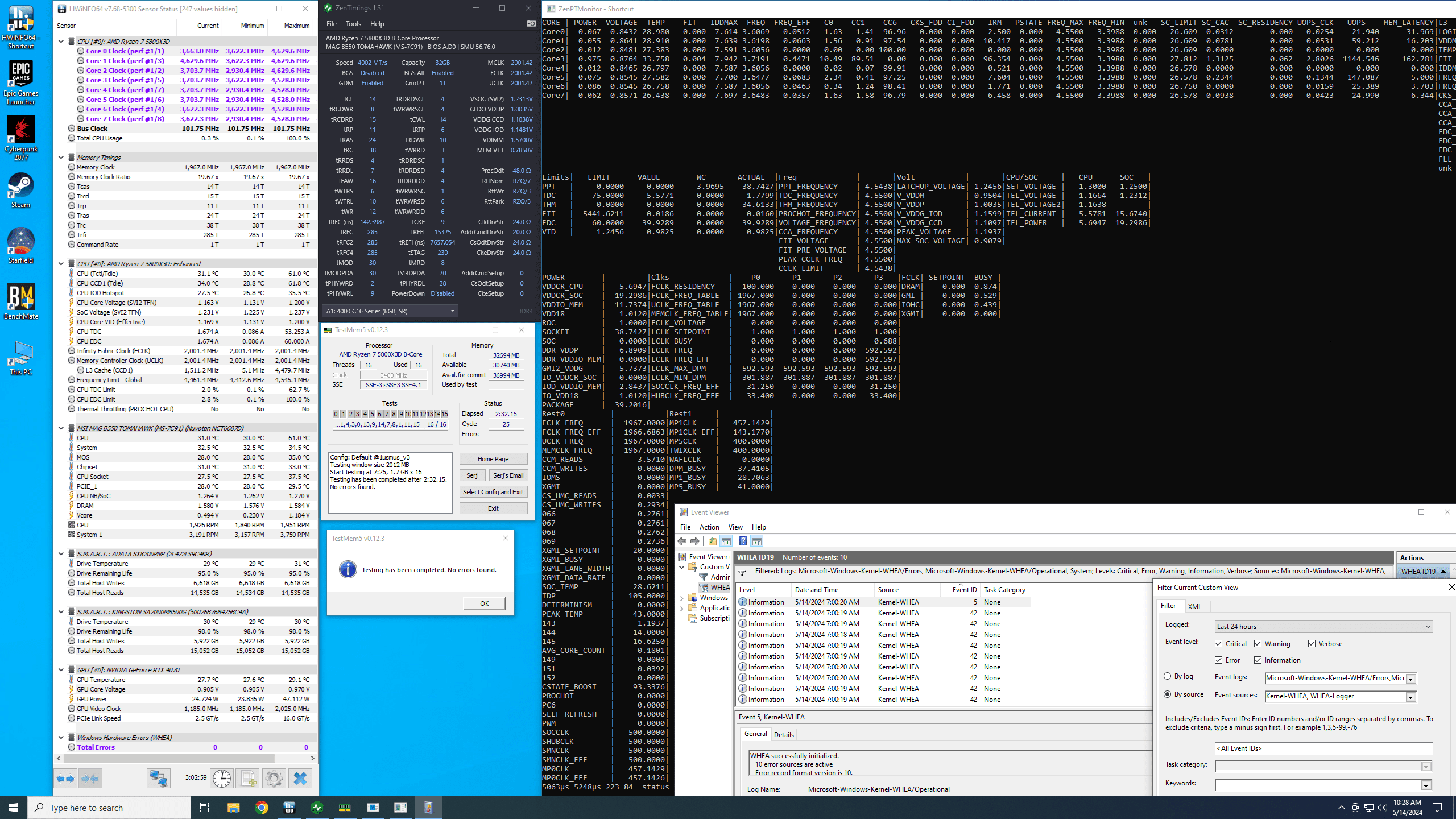

Last one: Why do you now always show the ZenPTMonitor screenshot now? Can you recognize and interpret something from it yourself - and thus, it's a benefit for you? Or are you hoping that Veii will praise you for it? I can't interpret anything here and I doubt that anyone here can.
I find it interesting how you approch the IF 1900 from the lower end. Did you ever try to see what happens if you overshoot the exact IF1900?
2. You slowly exceed IF1900 by you BCLK method (requires 103.7 MHz and higher) and investigate when do WHEA 19 start to show up. It is really the very next step after IF1900?
Hi, long story short version, done with researches:
I'am capped to use only 103.5 bclk but not cause of wheas fest, my sample can run just fine straight IF1900 & 1933 wheas free, tested before, it's just I cannot pass +1mhz over 1900 with 103.75, will do instant reboot, not from bclk, mem freq will fall into 1900-1933 hole, so no boot at all in range 👎
Tested already my sample 104.5 bclk with 6600XT, cause RTX40 new architecture cannot hold that much, only Radeon gpu's can do it, already got my 4070 in 4000mhz scenario with earlier stable 3866 +103.75 bclk, but wheas are invited, so nope thx 🤕
As for ZenPT screen, I did not posted for you, no ofense here, was for me, I opened it from the beginning of TM5 run, as @Veii teached me to stay under MP5_busy=40 for cpu, looking for LCLK min/max spikes & more info to follow inline for 🤓
No need for your cpu to be in much autocorectable route (busy) all time, especially when you are testing, looking for most stable Profile, cause already got too much rock stable of them, all mem freq in different BCLK scenario, hard to decide which one is for my needs: IF2000 gaming only, IF1977 bench'es included, IF1900 CL14 & CL15 103.5 bclk daily & gaming 4,7ghz, perhaps last one 👍

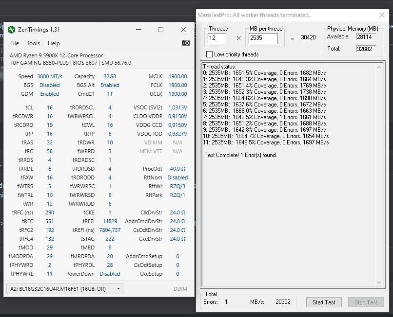

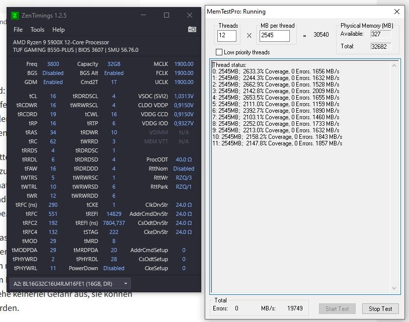

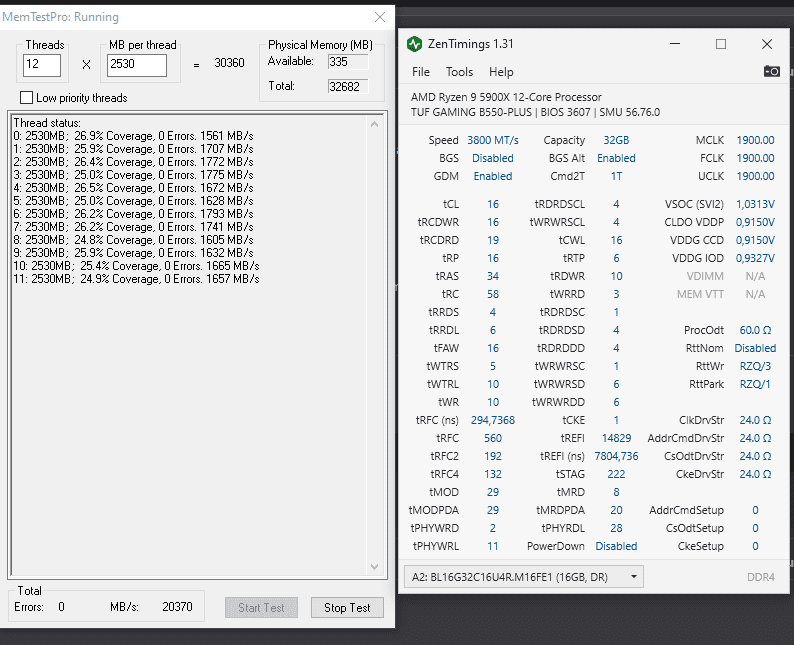

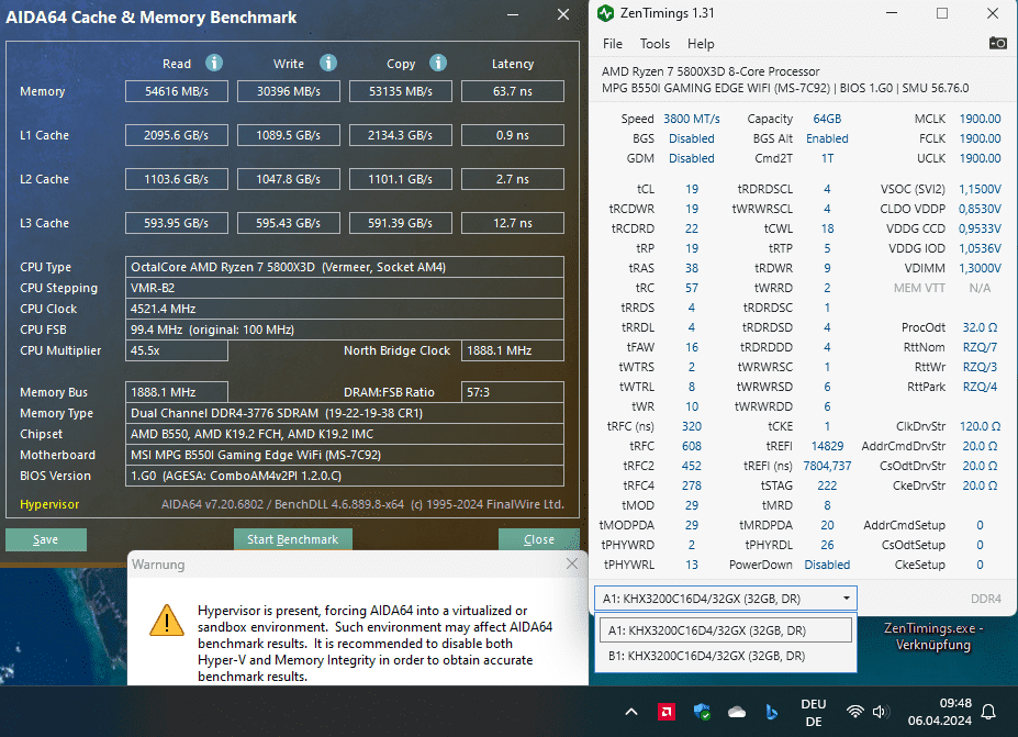

Vielleicht kann mir hier jemand helfen. Damals hatte ich stabile OC Settings gefunden und war damit auch lange glücklich. Leider hat sich mit einem AGESA Update etwas geändert und bei meinen Subtimings ist etwas nicht mehr stabil. HCI und co laufen weiterhin fehlerfrei durch, aber z.B. in GTA 5 gibt es (ab und zu) nach Stunden mal einen kick to desktop. (Weniger Takt scheint nichts zu ändern, daher auch die Vermutung ein Subtiming will so gar nicht. Nehme ich die raus(auto), läufts scheinbar.)
Jemand eine Idee bei welchen/m Subtiming ich ansetzen könnte? Alter HCI Lauf. tRCDWR ist schon auf 16, nicht mehr auf 8 - half nicht.
1900if-3800mem-2000-hci-png.971489
@Mr.Mito Ich seh da einiges, was man sehr schnell optimieren könnte. Wenn es wirklich am RAM liegt, würd ich vor allem mal tRFC auf 320ns setzen (608 bei 3800), das ist das "most launisch & zickig " Setting.
Dann tRCDWR auf 16, Platz 2 der zickigen Settings.
Auch kommen mir Deine Spannungen recht niedrig vor. Ich weiß es gibt Leute, da läuft das so, aber versuch doch mal vSOC 1,05 - 1,10 / VDDP 0,855 - 0,90 / CCD 0,90 - 0,95 / IOD 0,95 - 1,00.
ProcODT ist wiederum viel zu hoch für Ryzen 5000. 30 - 32 Ohm bitte, und RttNom auf 7 = 34 Ohm. Rtt dann mal 7/3/3 oder 7/3/4.
AddrCmdDrvStr auf 20, also 24/20/24/24, oder gleich 20/20/20/20.
Abgesehen davon geht bei den Timings einiges. Fangen wir mit den tertiären Subs an,
tWRWRSD auch auf 6.
  • tRTP = 6 (wegen tWR = 12 / 2, siehe nächster Punkt)
  • tWTRS 4 / tWTRL 12 / tWR 12 (mit tRTP 6).
  • tRRDS 4 / tRRDL 6 / tFAW 16
Damit ist mal das alles bei den Subs "geradegezogen".
Am Schluss noch die primaries mit tRC auf 48, also also 16-16-19-16-32-48 (tRC 48 = tRAS + tRP mit tRAS 32 = 2x tCL).
tRC 48 packt ev Dein RAM nicht, dann ist die safe Variante: 16-16-19-16-39-55 (tRAS 39 = tCL + tRCDRD + tBL 4 / tRC 55 = tRAS + tRP).
Warum diese Werte? Weil sie sich bei den allermeisten Usern bei DDR4 3800 bewährt haben, also praktisch empirisch erprobte Best Practice sind.
Natürlich geht immer noch mehr, und es gibt hier Gurus, die unterschiedlichen Setting-Kombos noch viel mehr Zeit widmen würden - aber mit dem obigen hast Du mal 95% des erreichbaren. Sollte ggf sogar mit 1T GDM off funktionieren wenn Du darauf Lust hast - bringen tut es halt recht wenig, fühlt sich aber gut an ;)
Ergänzt oben: tRC 48 packt ev Dein RAM nicht, dann ist die safe Variante: 16-16-19-16-39-55 (tRAS 39 = tCL + tRCDRD + tBL 4 / tRC 55 = tRAS + tRP).

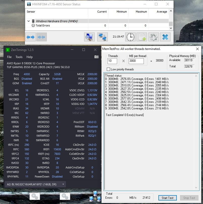

tRFC kann ich ausschließen, die geht selbst bei 2000 1:1:1 <=290ns.
tRCDWR ist bereits auf 16, wie geschrieben.
Die Spannungen haben bereits eine (ordentliche) Sicherheitstoleranz nach oben drauf, hatte ich aber dennoch schon versucht und daran lags wie zu erwarten nicht. Die CPU schafft die 2000 1:1:1 stabil, Screeni mit 2500% HCI kann ich auch noch reinpacken - geht aber am aktuellen Problem vorbei.
Ich will das jetzt nicht aufdröseln und verstehe deine Ansätze bei den Widerständen, aber es liegt nicht daran. Die sind ja auch je nach Board/CPU/Speicher einfach anders.
Ich vermute aktuell die tRAS (bin von 32 auf 34), aber das Problem ist halt, dass ich nicht einfach ein Testtool anwerfen kann um es festzustellen. Ich muss eher 8-10h spielen, pro "Durchlauf". :-[
Vielleicht kennst du noch ein Tool/Grafikbenchmark, den ich nutzen könnte? Karhu, TM5 (config egal), HCI ect. laufen ewig.
tRTP interessiert mich jetzt aber wirklich wieso man hier tWR/2 nehmen sollte. Das ist mir neu. Wobei niedriger ggf. gehen mag, aber mich einer Lösung für mein aktuelles Problem eher nicht näher bringen wird, oder?
Das gilt auch für die anderen Subs. Ich will ein Problemtiming finden und indem ich andere Subs straffe, schaffe ich mir da nur mehr potenzielle neue Probleme, aber nicht weniger.
Wenn ich weiß wo mein Problem liegt, klar, dann gehe ich gerne nochmal ans Feintuning. GDM off mag die CPU/IMC leider gar nicht, wobei ich mit der ClkDrvStr noch schauen könnte, ob der IMC sich "überreden" lässt.
Aber wie gesagt, das geht ja am aktuellen Problem vorbei. Ein Timing ist bereits jetzt schon zu stramm und die tRFC kann ich leider bereits ausschließen.
Als erstes würd ich mal die Proc runter setzten, wie bereits erwähnt viel zu hoch. 36,9 isn sehr gängiger Wert.
tFAW 20 hatte ich auch nur Probleme mit, runter auf 16 (tRRDS 4 *4 =tFAW).
Es muss nicht zwingend an zu scharfen Timings liegen.. können auch einfach aus der Reihe tanzen was dann Probleme macht.
AddrCmdDrvStr 20 würd ich auch empfehlen.
Ansonsten SC/SD/DD mal wieder auf 1/5/5, 1/7/7... scheint bis jetzt jeder RAM zu schaffen.
Ich finde die Spannungen für IOD/CCD für nen dual CCX auch recht niedrig, aber seis drum wenn das wirklich stabil läuft...
Na dann mach doch mal das hier wie beschrieben mit tRAS 39: 16-16-19-16-39-55 (tRAS 39 = tCL + tRCDRD + tBL 4 / tRC 55 = tRAS + tRP).
Kostet kaum Performance, ist "nach Lehrbuch", und dann weißt Du es - und kannst den Rest optimieren ;)
Wg Tests: ich nutze TM5 AbsolutNew@anta777 , und ggf Y-Cruncher VST / VT3 für RAM. Härtester Test CPU / Gesamt bei mir ist bisher CoreCycler mit HNT / C17 / VST im Hintergrund während dem Zocken. Crashed nach 5-60min, wo einzeln alles stundenlang läuft.
Da heißt es in den Foren immer, das wäre nur für Micron relevant - aber auch bei Micron funktioniert auch tRTP = tWR fehlerfrei und performant. Allerdings gibt es etliche User, die berichten, dass bei ihnen Spiele gefühlt deutlich flüssiger / responsiver laufen bei Einhaltung von tWR = 2x tRTP - auch ohne Micron ICs. Einer davon hat sich hier auch schon mal ausdrücklich persönlich bedankt für den Tip, weil´s dann viel besser lief - also wird schon was dran sein.
Zu stramm, oder einfach nicht "stimmig"? Hatte wie @F|Marsman tw bei lascheren Timings wie zB tFAW 20, tWR 18 auch mehr Probleme / schneller Fehler als mit 16 / 10.
ProcODT ist halt default. Vermute ASUS geht da einfach ans obere von AMD empfohlene Ende und da die 2000 damit auch liefen, bliebs einfach so. Ich war da einfach pragmatisch unterwegs.
Vor Jahren, als ich eben am testen war, bin ich damit auch mal testweise runter - änderte einfach nichts (außer ich ging deutlich zu tief). Da die 60Ohm on-die terminierung keinerlei Nachtiele haben, solange die Signale durchkommen, bliebs halt so. (Mir ist bekannt das es Stimmen gibt, die behaupten, dass höhere Werte für mehr Abwärme sorgen - ka obs stimmt.)
Gestern hab ich viel gespielt und es gab keinen kick (tRAS auf 34), daher warte ich jetzt erst mal ab.
Viel auf einmal ändern will ich mit meinem "Nutzsystem"(OS) nicht. Da es keine reine Spielekiste ist, ist das einfach zu riskant. Sollten die kicks wegen erhöhter tRAS weg sein, werde ich wenn die Zeit da ist mal die Werte im Gesamten anpassen und einen HCI Dauerlauf vom WinToGo starten. Vorher halt mit TM5 (absolutenew hab ich auch) vortesten.
Allerdings gibt es etliche User, die berichten, dass bei ihnen Spiele gefühlt deutlich flüssiger / responsiver laufen bei Einhaltung von tWR = 2x tRTP -8
Nicht böse sein, aber das hat Anflüge von Kabelklang. :fresse: Außer halt man hatte vorher schon massenahft Fehler auf dem Bus, was man dann hätte mit AIDA (Latenz) hätte sehen können und das hat durch Zufall geholfen. Aber selbst das dann "zu spüren" klingt halt nach purer Einbildung. Hätte man dann auch in Benchmarks klar sehen müssen, frametimes, scores ect.
Danke auf jeden Fall für die Hilfe/Denkanstöße. tFAW 16 lief damals im Übrigen nicht, wobei ich nicht mehr weiß, welche tWR Kombis ich versucht hatte. Das werde ich bald mal wieder testen. :)
Die 2000 liefen damals eben auch mit ähnlichen Settings stabil. Ich hoffe einfach ich habs mit tRAS direkt getroffen. Wisst ihr wie weit M8E im Schnitt mit der tRC bei 3800/4000 runter können?
Werde ich versuchen, sollte es mich mit tRAS 34 wieder kicken.

ProcODT von 60 auf z.B. 48Ohm sorgt dafür, dass man (geringfügig) mehr Vdimm braucht. Wieso sollte man ProcODT überhaupt drücken, wenn es auch mit 60Ohm gut läuft? Wo liegt denn dann der Nutzen?
Das hier z.B. wirft mit 1,370Vdimm bei 60Ohm beim kurzen antesten keine Fehler. Mit 48Ohm brauche ich dafür 1,380V, sonst gibt es relativ flott vereinzelt welche.

Ich hatte leider eben wieder einen kick aus GTA. Der Witz ist, dass ich So/Mo echt viel spielte ohne jegliche Probleme und eben kegelte es mich nach 1Min raus. Am Ende liegts an GTA ... :fresse:
Nervt mich das ich den Benchmark nicht einfach loopen kann. :-[ (Firestrike ect. loopt Stunden ohne Probleme.)

Wg GTA Problem: und Du bist sicher, dass das am RAM liegt, und nicht an der GPU, an CO, ...? Irgendwelche WHEA im Eventlog?
Ich hatte in Erinnerung, dass sich das durch die bench DLLs auch ändern kann. :-/ Dual CCD ist klar bei write, aber sollte read/Latenz nicht theoretisch gleich sein?
Mein gestern gestarteter HCI Lauf schmiss mir heute morgen leider einen Fehler. Einen ...
GPU bei GTA kann ich ausschließen, CO nutze ich nicht. WHEA hatte ich mit der CPU noch nie, nicht mal bei 2000. Die wirft irgendwie keine. :haha:
Kann durchaus auch an was anderem liegen, würde mich auch nicht einmal wundern, wobei kicktodesktop mir für ein zickendes Subtiming halt leider bekannt ist/war.
Der eine HCI Fehler erinnert mich an damals. Damals versuchte ich bei dem Problem mehr Vdimm/SoC/IoD/CCD ect - das halt alles nichts. Weiß nicht mehr welche Timings ich am Ende entschärfte, damit es lief.
