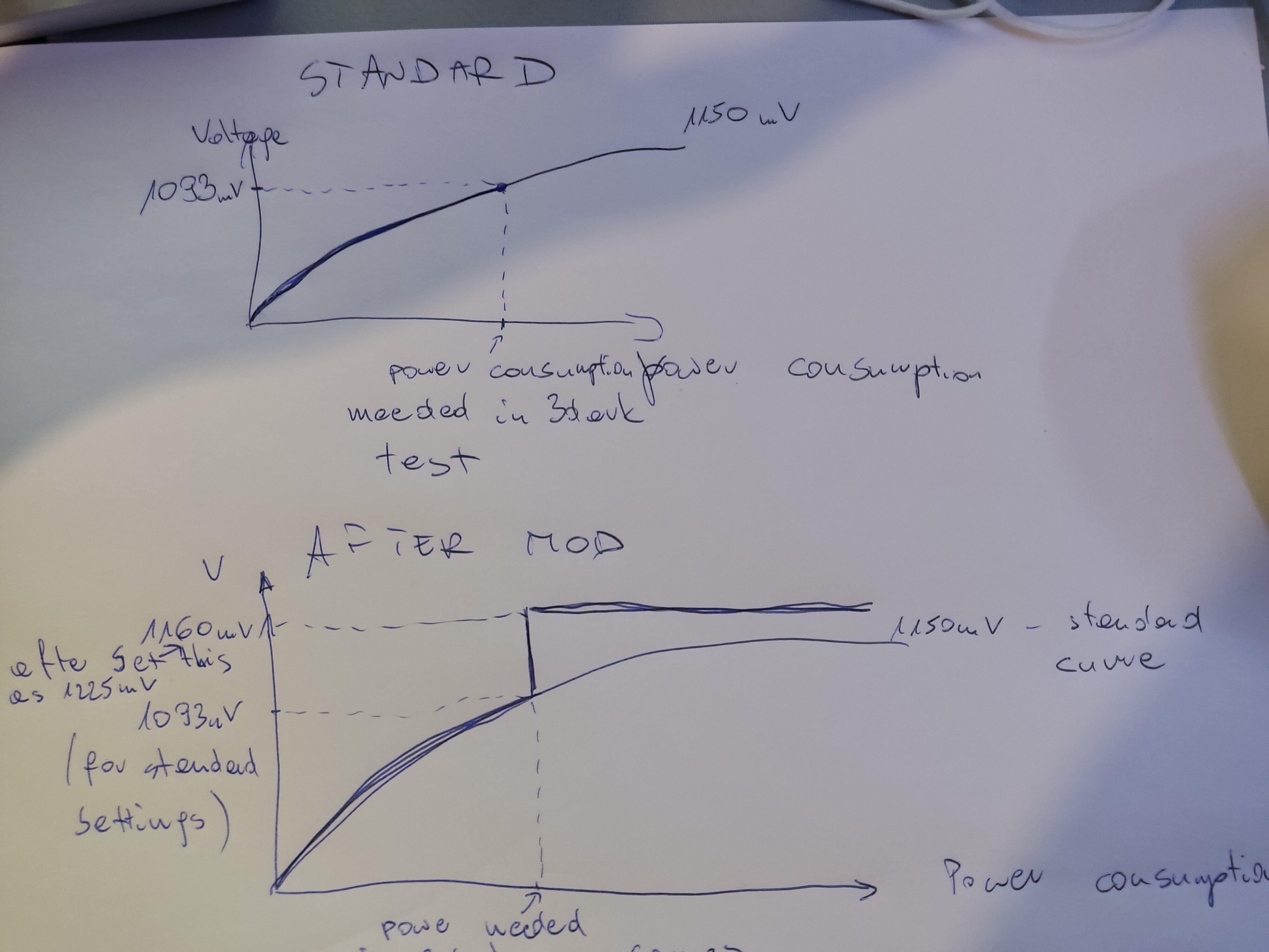

guys something is wrong with this mod TDV in your computers
In my case, during the normal use of the computer card with the modem drops the voltage to normal values, when I start 3dmark and enter the menu, the voltage jumps, sometimes reaching the maximum value, when I run a proper test only keeps the maximum voltage for a long time, and here I also have to note that in games or 3dmark does not have to be a specific value; For example, my card on daily settings with 330W + 15%_(~380W) muzzle and voltage set at 1225mV card is hitting the max voltage of 1163mV
exactly , for records DS need to be turned off , for daily turned on , than cards work normally and take higher voltage only when is nedeed
Just so I'm sure that I'm understanding correctly, are you saying that the TDV mod doesn't just set the card to the voltage chosen and that it instead just raises the upper limit of the voltage curve?
So in essence since the Rx 6800 originally had a max voltage of 1050mV which then got dropped to 1025mV, I should be safe using the TDV mod to set it back to 1050mV since it was initially set at that and the mod is really just setting the curve back to it's original setting right?
6800 and 6800 XT both have a Max voltage of 1.150 mV - right?

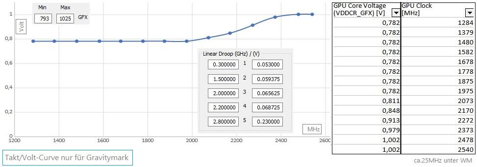

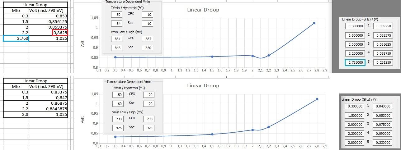

Jo,
LinearDrop State 5 hört nach dem AMD-Treiber-Cut jetzt theoretisch bei 1,025V auf.
(letzte Woche hatte ich ja mal die Volt bei TDV und LD5 hochgezogen, ... sollte mit 1,05V kein Problem sein)
Diese Woche wollte ich TDV net soo sehr erhöhen, habe daher mal andersum die MHz bei LD5 gesenkt.(x)
LinearDrop-Curve sollte evtl. zusammen mit Fps-Limit in Games wirksam sein.
(x) mal in die xls von redF eingegeben
Curve oben ist modded
Curve unten ist default
... man wäre in beiden Fällen@2600MHz noch deutlich unter 1,0V !!! (xx)
Wieso man im Gravity trotzdem>1,0V boostet, who knows (ist halt Teilllast, ... und das komische Spannungsplateau)
(xx) ganz klar, das die meisten Chips das net schaffen können, selbst wenn man sagt 2600-ca.30Mhz wäre der "takt"
(Bild 2 zu Gravity ist von letzter Woche mit mehr TDV; Bild 3 mal ne ältere echte Messung der GFX-Volt in HWinfo)

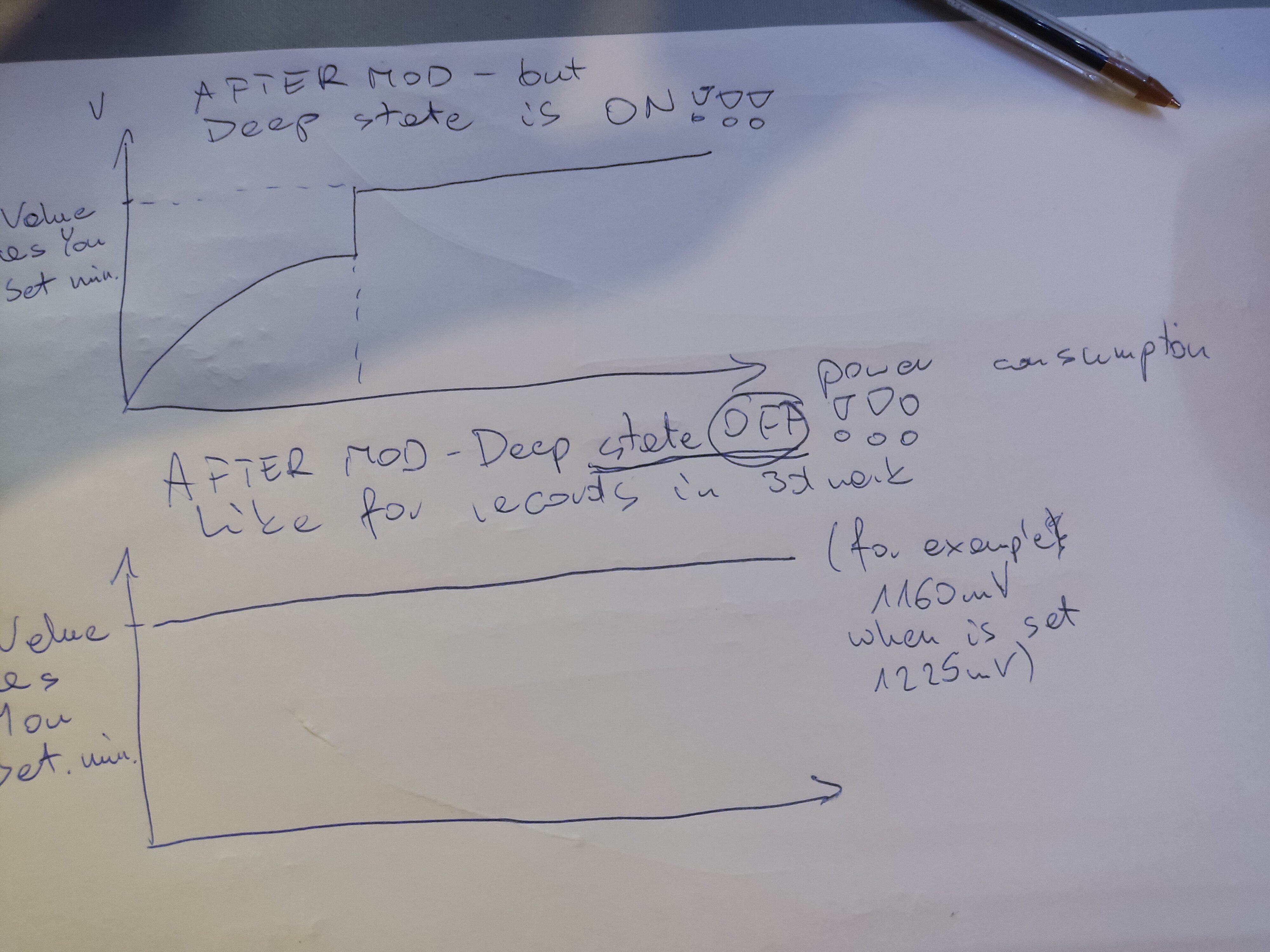

@Sylwester. What happens if we set the Vmin low to a lower value? Is it necessary für our way to overvolt the card - has anybody tried? I have also thought about using the higher voltage (similar to yours) as the higher limit, but let the card go down to normal values. So far I haven't tried this. But it seems interesting, what your card does in normal ops.
and @MisterFerro
In fact only the minimum value is important to set, and it raises the voltage curve at load, without it from the factory 1150mV after applying the voltage curve, the card under load gets max 1089-1093mV, changing the TDV value causes that after setting for example 1225mV card under load after applying the voltage curve does not get less than 1160-1163mV
something like this :
and also when You dislabed deep state:
if DS i turned off , You get constant 1160mV no matter than card iis doing something or not
