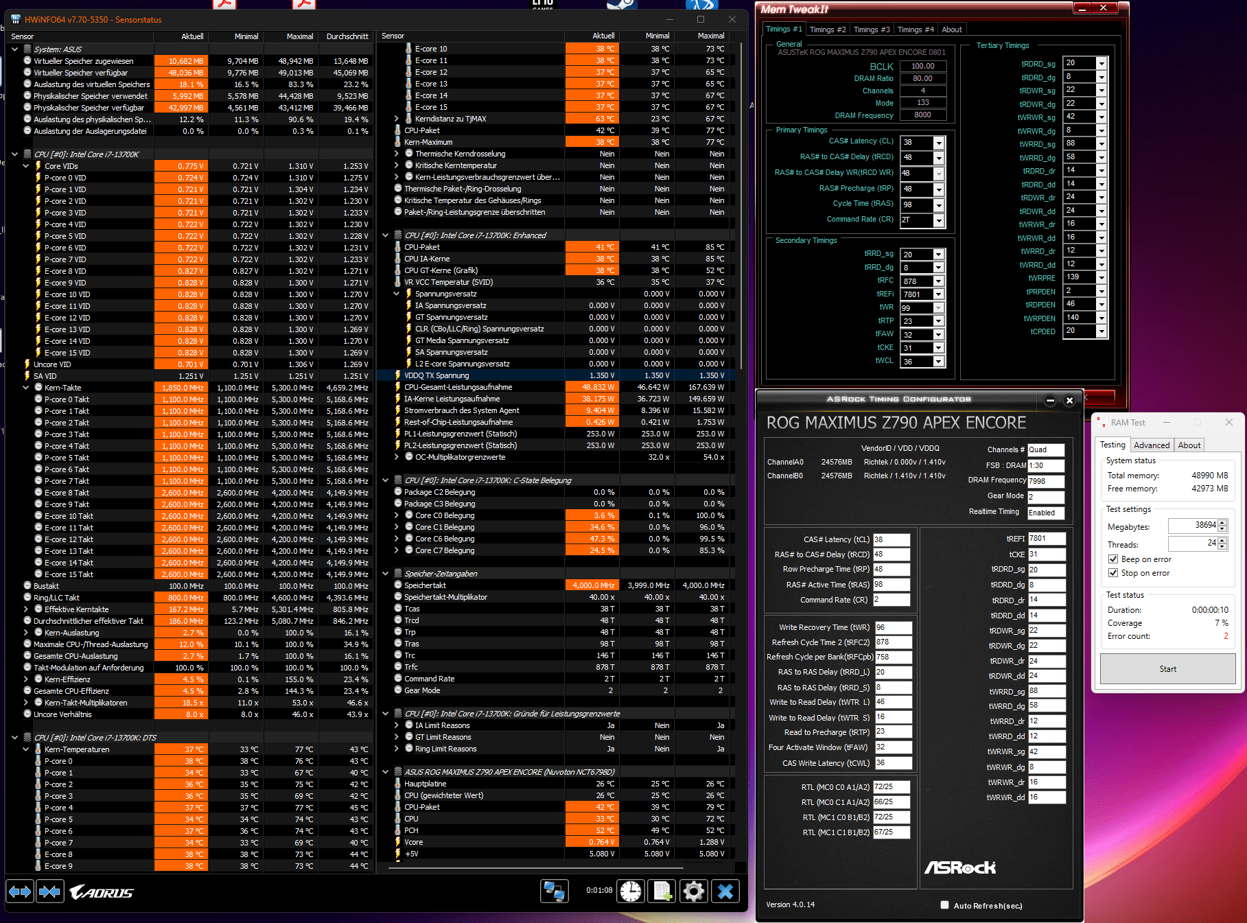

das gute ist, windows wird gestartet, dann hört es aber auf ^^
Spiel mal ein wenig mit der SA.
1.175v zb oder 1.275v- 1.3v ob das Besserung bringt.
MC hast du auf 1.4v gesetzt oder das Board?
Den mc wert hat das Board gesetzt. Ich weiß nicht mal wo ich den finde 😥
Der SA wert ist, CPU System Agent Voltage?

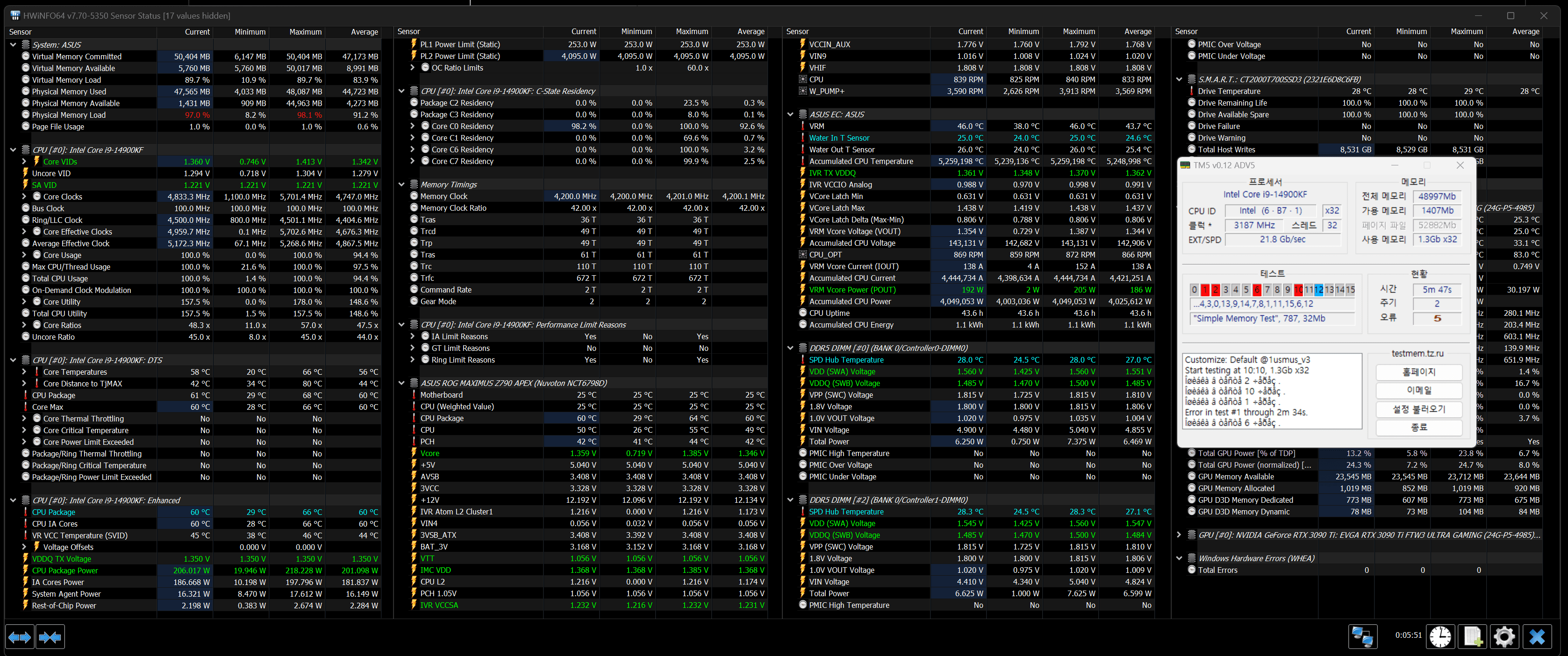

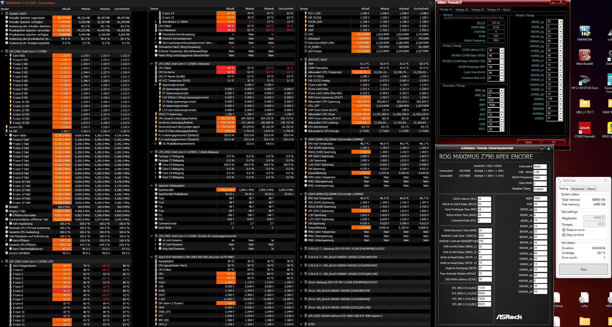

folgende Settings sind aktuell scheinbar stabil, habt ihr noch Tipps
Bei 6 Minuten Karhu kannst auch nen Run Y-Cruncher machen, da biste vermutlich schneller schlau. Lass das mal zumindest ne Stunde laufen, dann kann man von scheinbar stabil reden! :)
vorher war meist nach 10 sec ein Fehler oder direkt crash
werde den Cruncher mal durchlaufen lassen

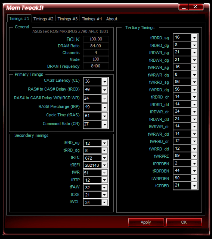

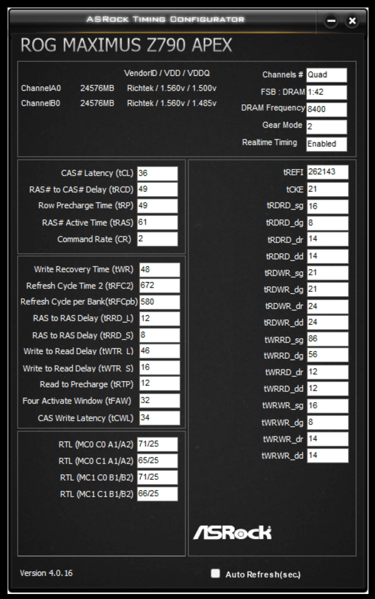

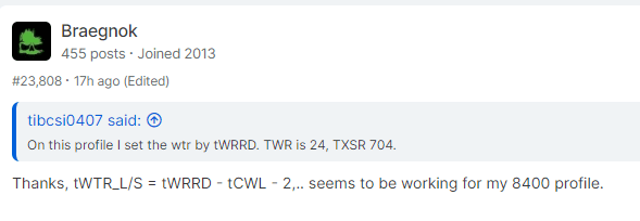

I'm jelly that your RTLs train correctly. Mine only train correctly at 8400, no other frequencies train RTLs correctly. The funny thing is, 8400 won't stabilize on my CPU.
I'm working on 8400 CL36 profile today, been fixing TM5 errors all day. :LOL:

C-can you push a correction please
Its tRDWR SG/DG = CWL+ BL/2 + 2 + X
X = tWTR_
In OS in ATC or other tools, it is detected as BurstChop 4 instead Burstchop 8
Soo ATC thinks its CWL+4+2+X , not CWL+8+2+X.
I think actual formula would be CWL+ BL/2 + tAL + X
Unsure why its that way (logic). But it looks correct.
I can not talk about this logic part either.
Unclear if due to dual MC, Bios input is split by CPU nevertheless = has to follow specs
Or Bios is configurator and some timings can be down to 4nCK instead of 8nCK.
I really can't say. Roundtrip timings for sure need to follow hardware limitation of 8nCK Burst.
Writes have benefit of happening in the middle of 8nCK long Burst ~ but its just one,. not all.
RDWR_DG at "bios calculated 8nCK burst" ~ is already at value 4 (minimum)
Maybe it doesn't matter much when CPU does command queuing for writes.
But i think it has to matter. As hardware limitation still is 8nCK burst. Can't go lower than 4 WTR_S without conflicts.
Even if (cpu) access to both subchannels (for writes) is without delay. Memory itself will struggle with burst alignment.
I don't know.
Guess things are just how things are.
Math in bios is correct, math in OS is correct.
Reason unclear. Logic is missing or flawed.

Thanks Veii, post edited. https://www.overclock.net/threads/o...memory-stability-thread.1794772/post-29292272

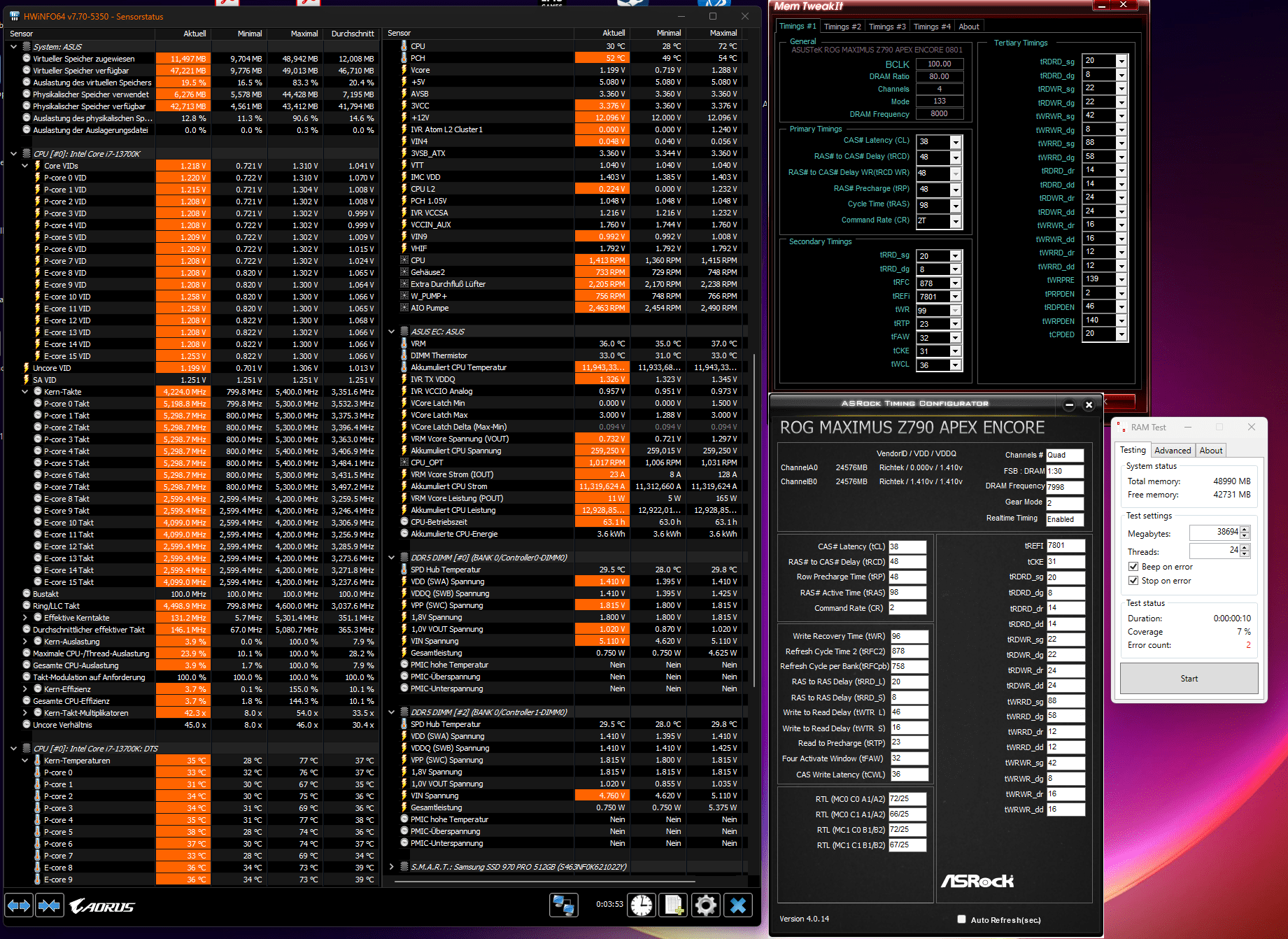

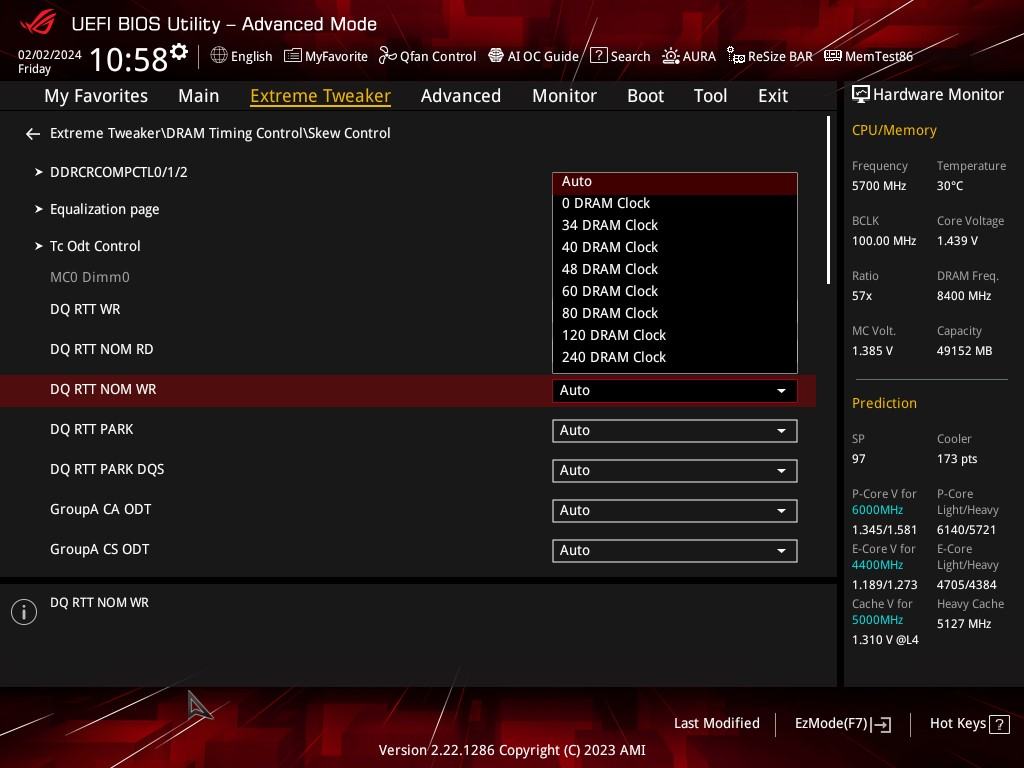

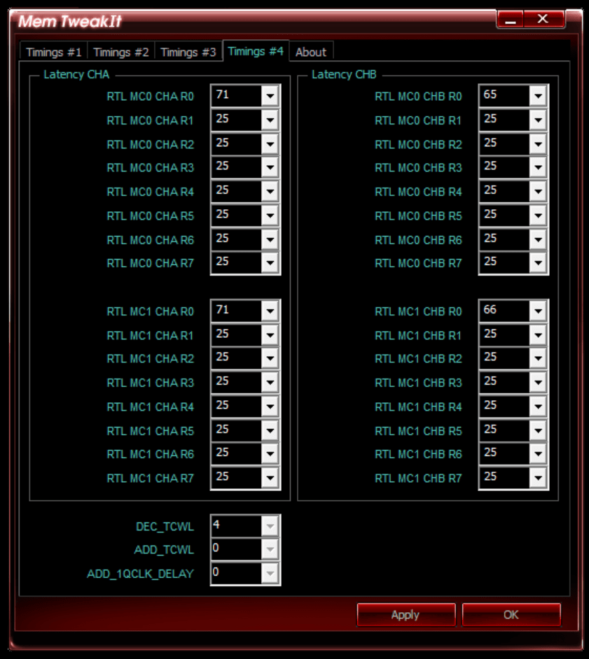

I'm stumped with Error #12, can't shake it. #12 shows up early in cycle 1, with error #2, sometimes error 12 - 2 - 10,.. always in cycle 1. I have spent three days adjusting VDD/DQ, SA, IMC VDD, IVR TX VDDQ with 36- 49-24-49-61 primaries, adjusting RRD, WTR, WTRL/S, WR,.. even setting to Auto, no love.
I have not found Proc ODT, or RTT_NOM settings, or safe adjustments to use, also have not tried weaken ClkDrvStr & increase VDIMM slightly option. I think it is Proc ODT, or RTT_NOM,.. any advise for adjusting those, thanks.
Screenshot 2024-02-01 195745 8400 CL36 TM5 ERROR 12.png Screenshot 2024-02-01 200022 8400 CL36 #1.png Screenshot 2024-02-01 200057 8400 CL36 #2.png Screenshot 2024-02-01 200144 8400 CL36 #3.png Screenshot 2024-02-01 200221 8400 CL36 #4.png Screenshot 2024-02-01 200425 8400 CL36 sensors.png
RTT issue
Its automatic with a lookup table ~ on Intel.
Yes that's an SA issue.
Drop SA to 1.22v ~ keep 60mV delta inside mem.
Afterwards its an RTT issue.

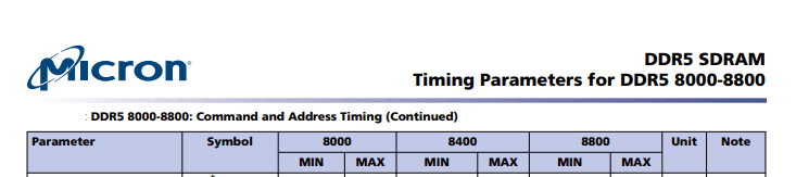

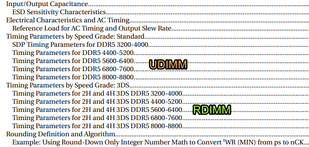

Meanwhile micron's own defined specifications:
"They are bad" ~ very doubtful.

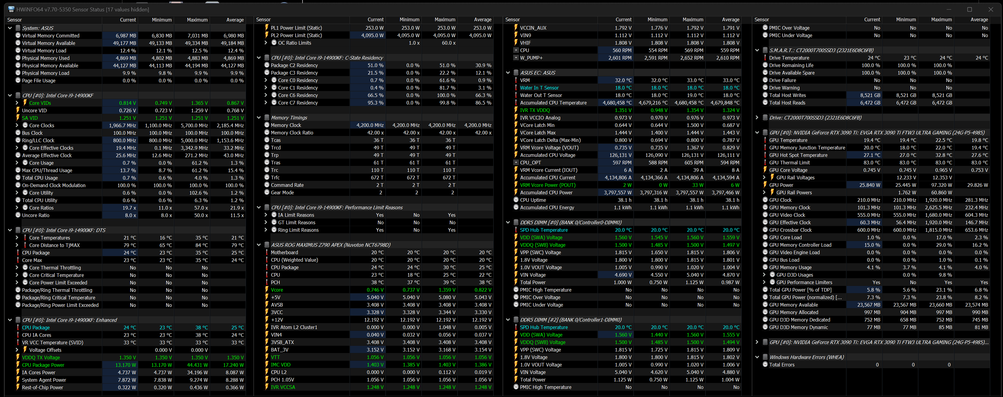

Thanks, looks like dropping SA to 1.22v resolved error #12 in cycle 1.
Unfortunately I have a host of new errors in cycle 1,.. error #6 came early in cycle 2.
Unfortunately I have a host of new errors in cycle 1.
2, 10 = RTT issue
6 = IMC
but maybe push MC VDD a bit.
How does y-cruncher look
VDDQ_CPU at 1.32 for now.
Maybe 1.33
Please share a bios.txt too

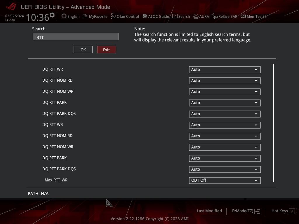

2, 10 = RTT issue. I'm still unsure how to adjust RTT_NOM.
BIOS shows RTT settings in Auto, I do not know which RTT to adjust, or current values to increase. Looking for page showing current RTT_NOM clocks.
