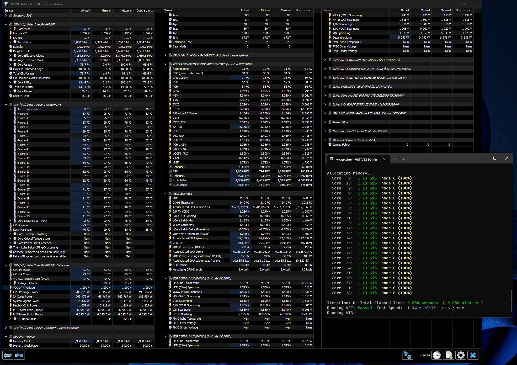

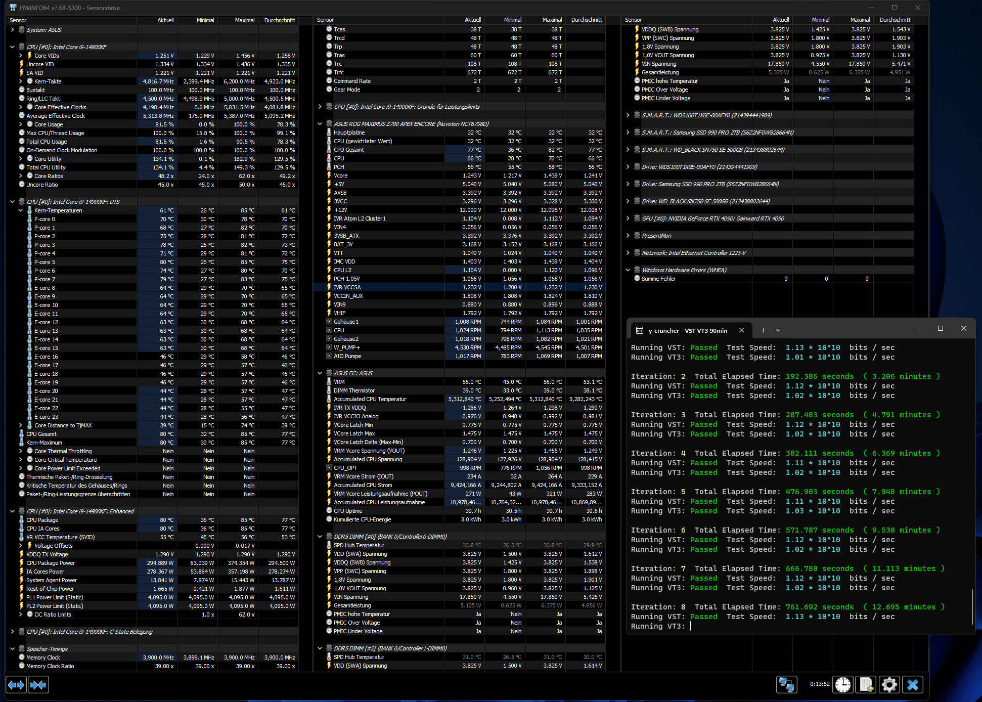

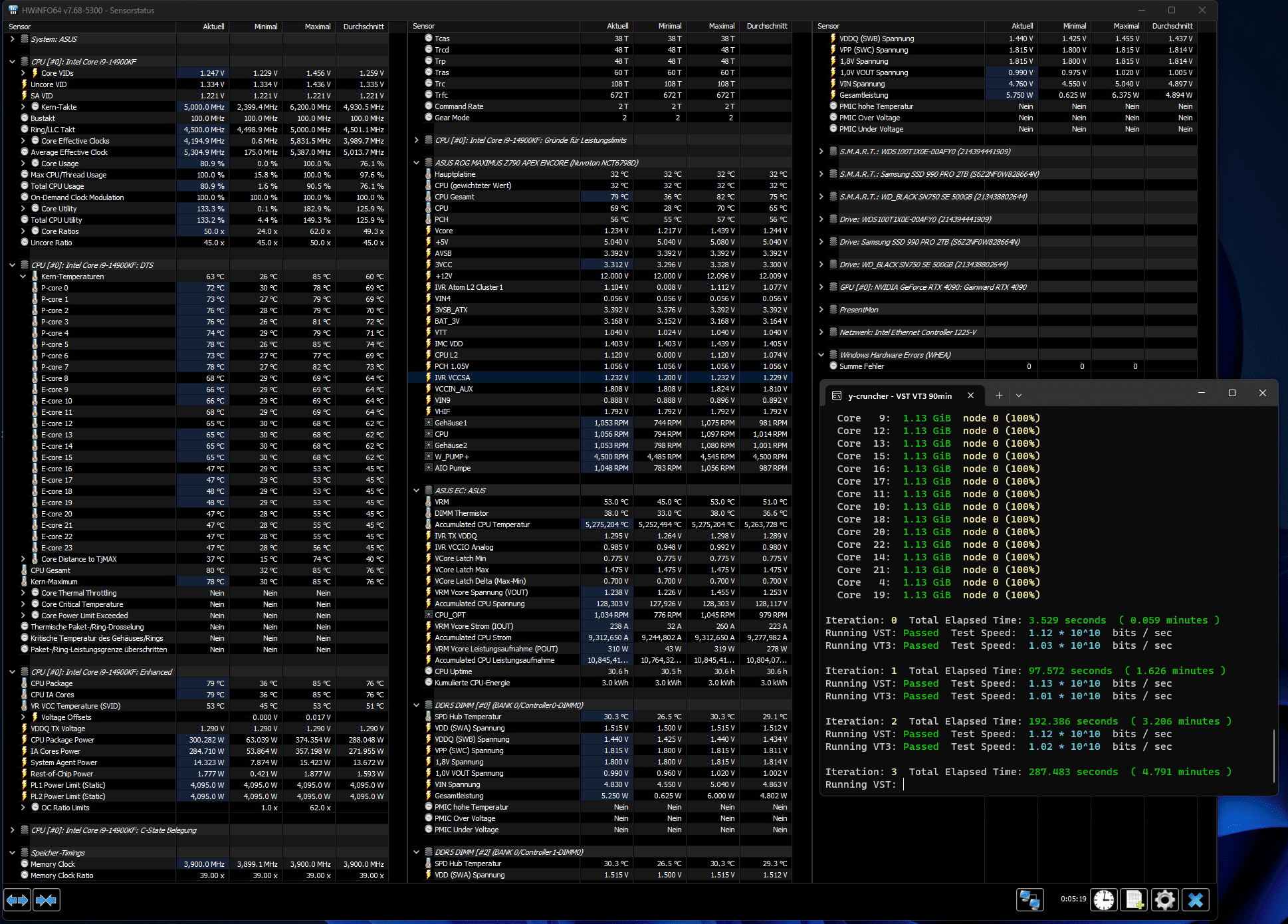

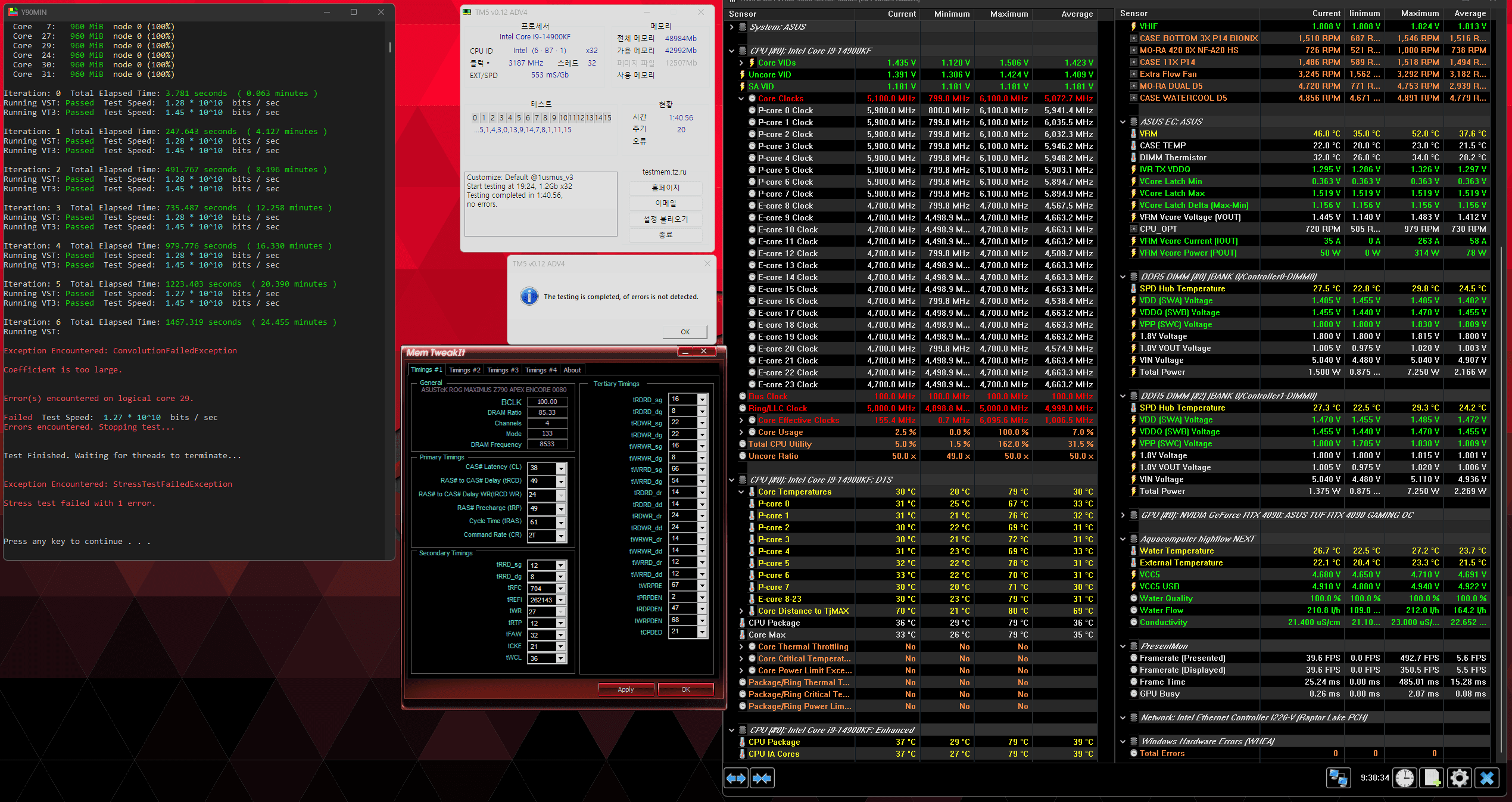

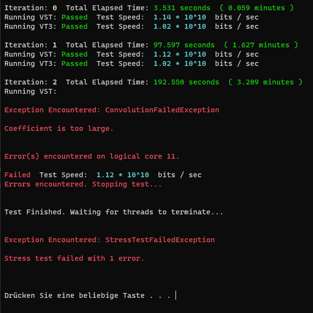

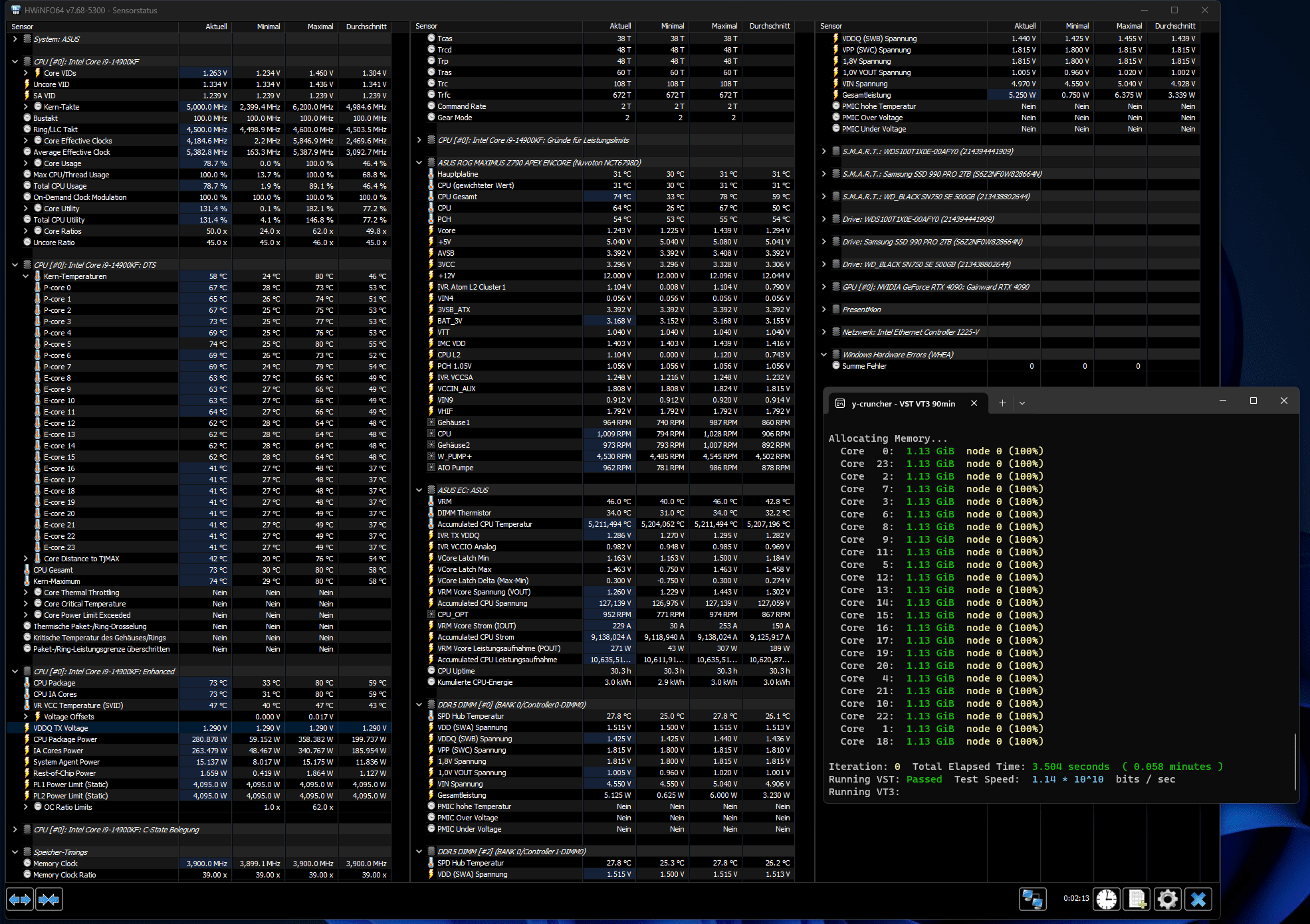

Yes, you were right. I am starting from scratch, memory all auto. So far LLC 4, AC 0.3 / DC 1.02 and it is fully stable. This, with my old 8000 memOC, was unstable. However I am not yet playing with the V/F curve and SVID is still AUTO. Want to solve LLC AC DC first. Sorry for not posting any result yet, it will come.
So sorry I doubted the reason for the instability as you said. I am not going to do it again!
Hey, i make mistakes too.
If memOC is/was ok, then its ring messing with it.
I believe the curve is fine.
Tho i am human, i can make mistakes 🤭

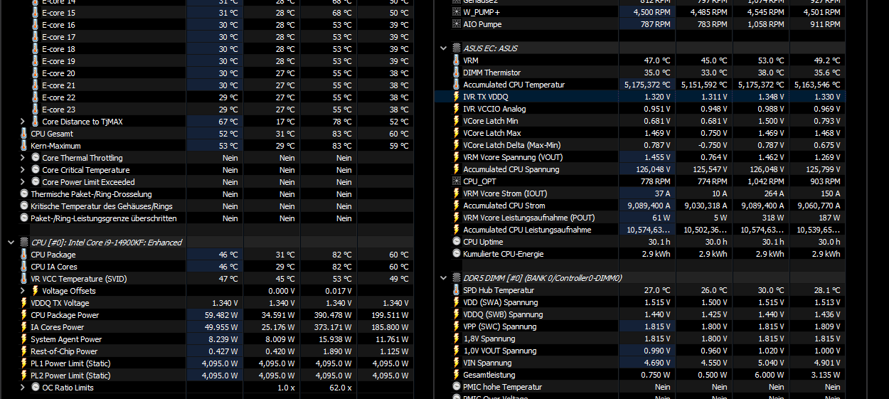

Kannst du mir bitte nochmal 50mV von VDDQ_CPU entfernen und VDDQ Training auf aus
Oder anstelle dem Training auf aus (gehört sich eig so), ein PSU off ~ 1min, coldboot anschmeißen ?
Just logically, if IA supply is a chunk
Ring takes from it, e-cores take from it, cores take from it, imc takes from it
It is kind of logical that IMC may lack voltage. Or ring clocks higher, and steals too much.
@Abtrünnig
If IMC lacks voltage, lower target SA.
Sounds counterproductive, but IMC actually knows how much to take
Soo strengthen VDD MC Link too, if you think you need more
And then just get VDDQ_CPU to VDDQ_MEM with around 120mV delta. 75-200mV .
Range will depend on many factors for Vref. One of them is if MEM side uses delta or not.
Mem delta of 60mV is healthy. Max there is 300mV not 200mV ~ correction for X who reads it.
Mem delta of 100mV always works ~ but always, means user can be a variable and bad RTTs will prevent this "always" factor.
60mV is nothing and should work for everyone
Higher delta on mem side = higher delta on cpu to mem link.
Müsste ok sein.
Es gibt margins
Im schlimmsten Fall, SA runter. 1.22 klingt ganz ok, anstelle 1.25. *
Das ändert das MC und TX verhalten.
* 1.18 klingt sogar noch besser, aber schritt für schritt~
1.4 VDD(2)_CPU ist halt auch eher für +8200MT/s gedacht , haha
Du hast noch Spielraum.

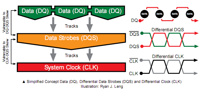

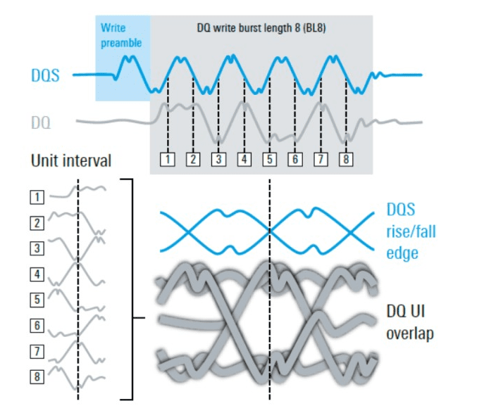

www.hardwareluxx.de
Der Post, bzw der Rücklinkende erklärt es gut.
Q heißt zwar Daten
S wäre strobe ~ "strom" , der Differenzstrom (differencial-current)
VDD ist die Spannung
DQ ist die Datenverbindung
DQS ist die Stromverbindung.
VDDQ baut den Vref. EDIT:
Halb.
Vref für DQ & CA wird durch ein Gain Factor und % von VDDQ bestimmt
Dies geht durch CTLE (optional), durch DFE am TX (eventuell) und landet auf DFE am RX ~ bevor durch write leveling , optimal alle korrekt "alignen"
Da DQs durch die Distanz immer etwas verzögert sind. Besonders bei zwei subchannels., pro Dimm. DQS und Clock syncronizieren sich schon bei dem Training.
DQS & Clock synchronisieren sich. Alle DQs synchronisieren sich.

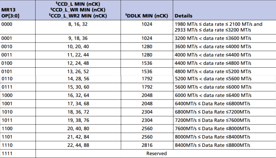

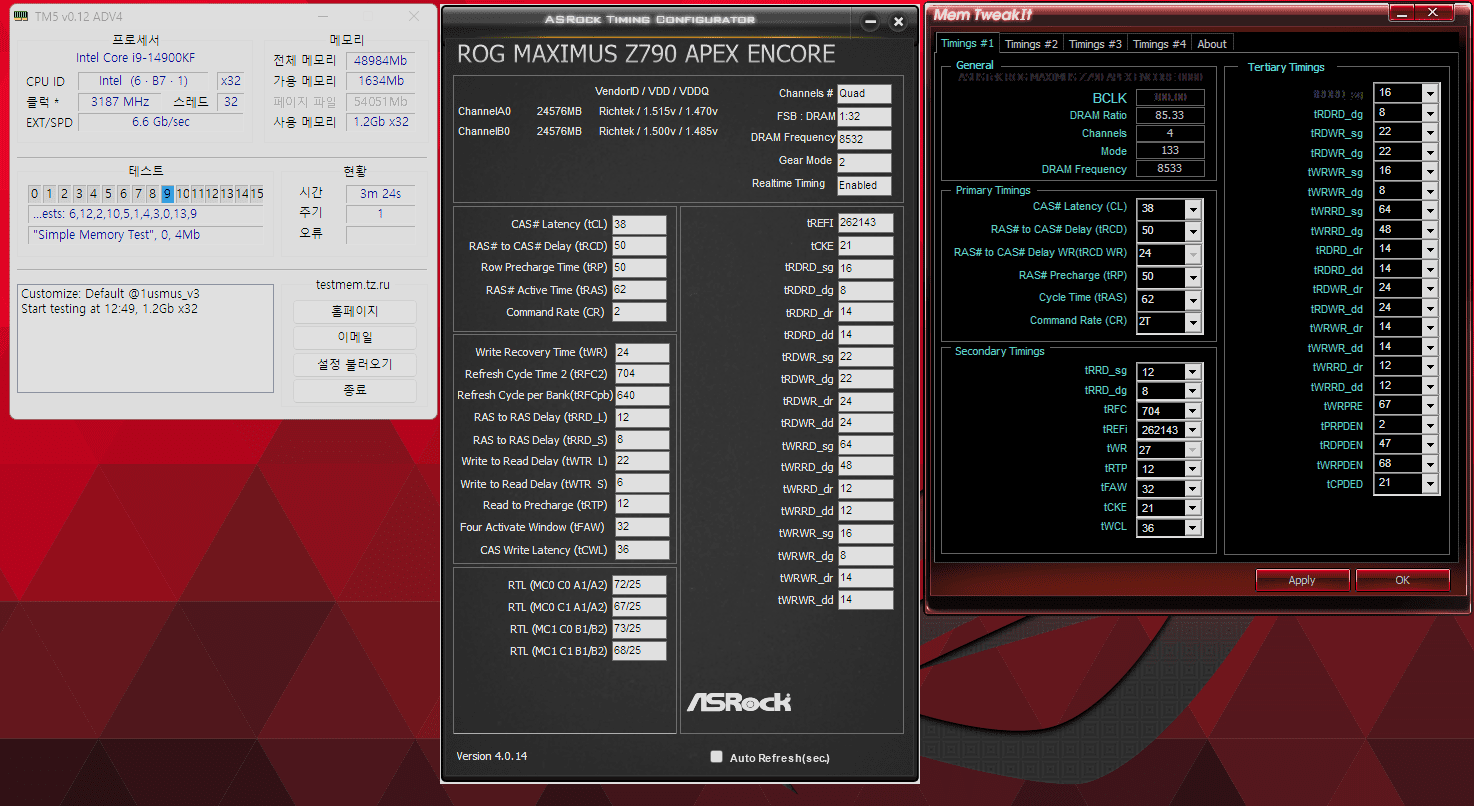

@Veii

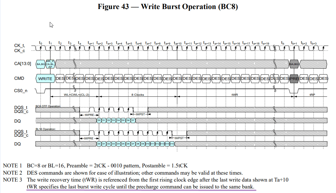

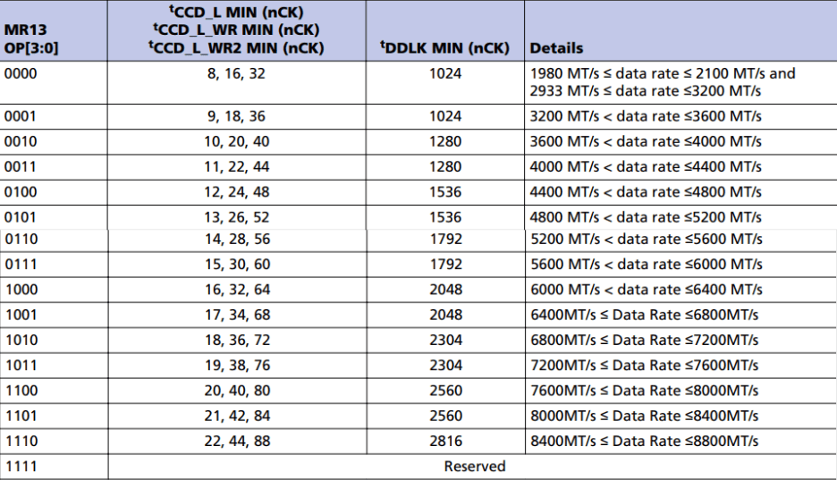

Could you please suggest me a good tWRRD_sg dg pair?
Is this too low?
Afaik ASRTC math is not correct for tWTR values.
I can't boot with 62/48 but didn't try 62/50.
Acc. to the rules for getting TWTR L / S = tWRRD-tCWL-2
Am I right?
I want to first set the timings to perfect before even playing with the voltages.
Don't touch that, just fix tWTR_
Board is intelligent.
Bothersome to make 4 changes and offset of CAS/CWL change ~ every clock.
tWRRD_X = tCCD_L
This table is fine
"recommended" but lower is faster.
No real limitation. Users lower tWTR_L by default to run tight terts or tight WR
Common seen behavior. Its wrong.
Math has no need to be tWTR_L either.
4 ways exist. tWTR_A is a thing. Past first write is instant, 2nd WR is delayed by BC8.
Real duration depends if command ends with autoprecharge or not.
tWR wont just start if conflict is happening.
WRRD = CCDDL
This table is fine Anhang anzeigen 960472
Common seen behavior. It's wrong.

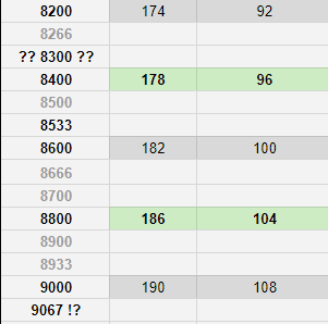

For both "it depends"
CCDL lower = perf win, in exchange of instability.
AP end commands have fun behavior.
WTRA & WR topic is very fun. 4 answers are correct.
Or jump to 9600 for Gear4. Easy Game. (on your & zebra's CPU)
Or take a break.
Sugi plays in 9000 Club.
Its fun.
Also RCD 49 is quite tight . Maybe too much for 8600, if i compare other results.
If you want to spare time with 8600, i would recommend to invest time working with DFE and CTLE.
Then 8800 might become in reach.
Because 8400+ with bad DFE is already ... a fairy tale
It must be at least somewhat ok, to see you can run it higher
But my trust is limited that Board is perfect ~ yet.
Better Databuffer on DIMM soon will make it better
But, eh i dont know. Feeling says its not going around main speed problem past 8400.
Which is Noise and DFE topic.

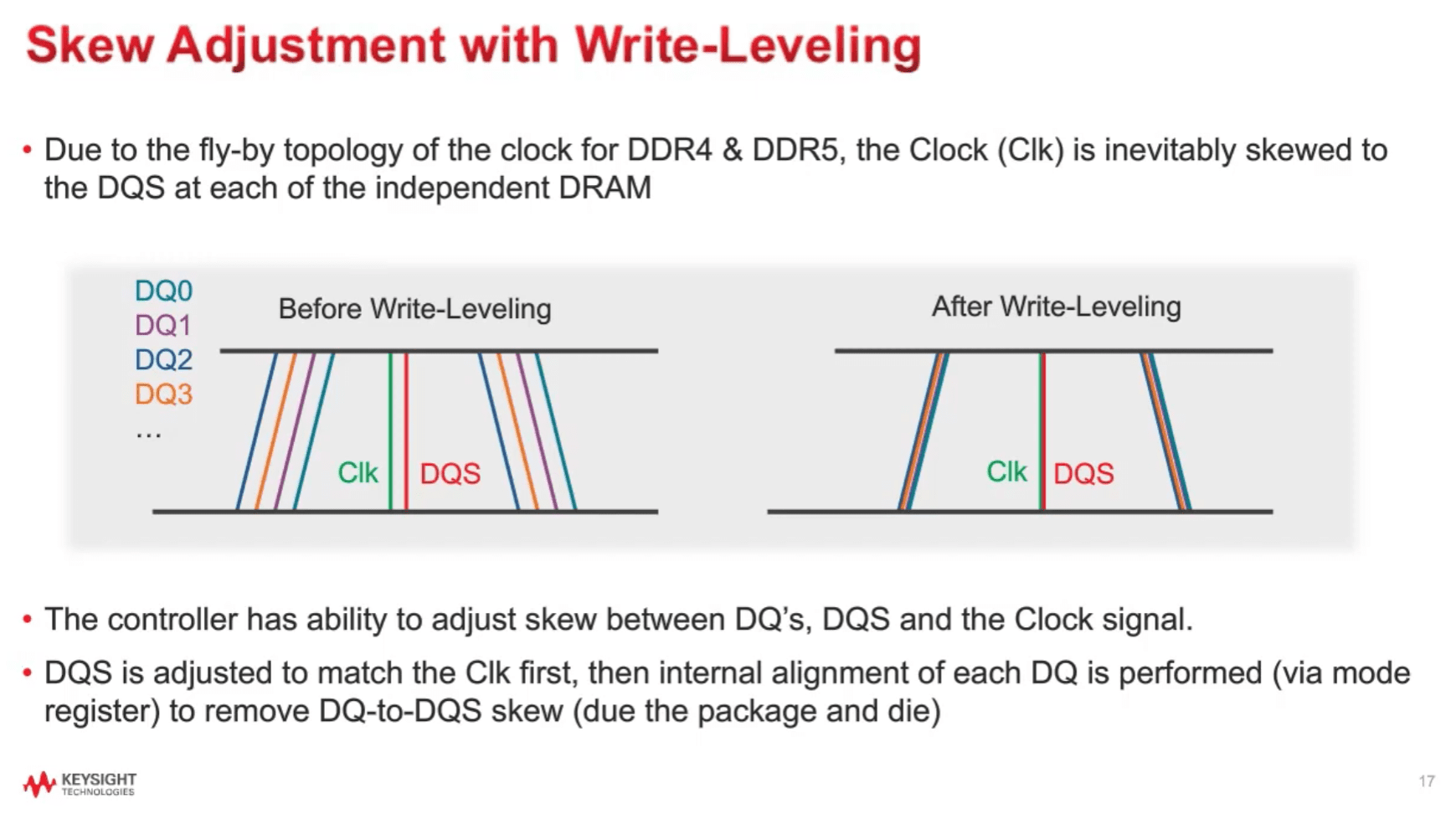

Writeleveling last time i checked was bugged. But i was a bit amateur, soo maybe its on me.

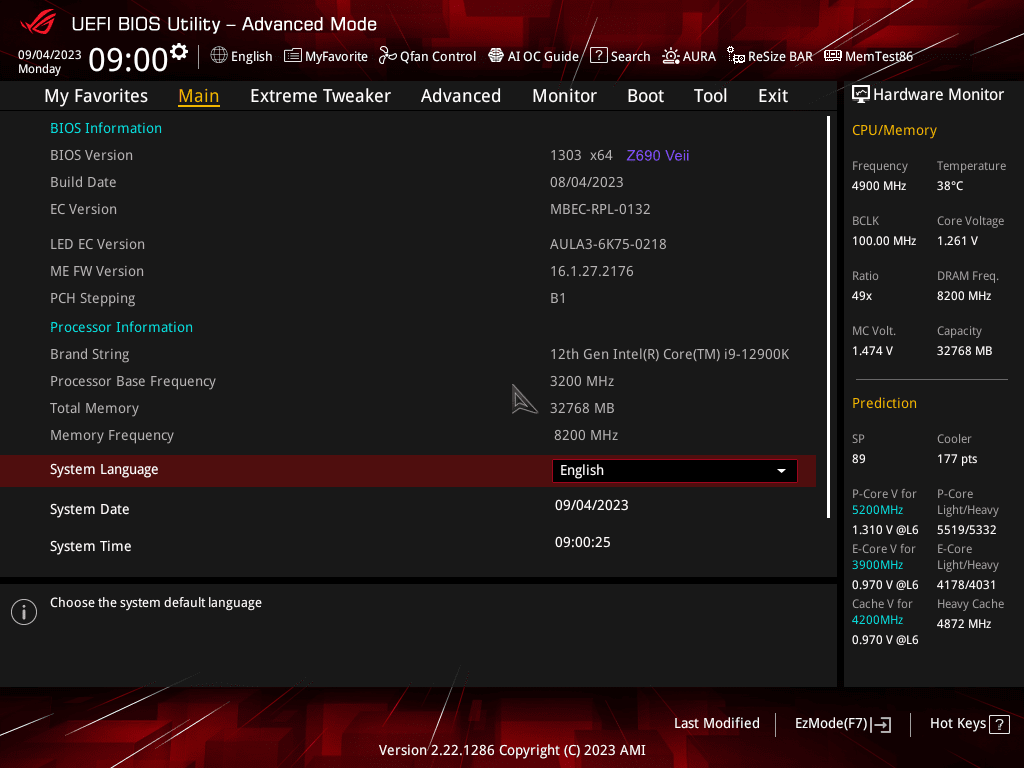

No, it boots, but stability is an other thing. I can even boot and run some bench on 8800.
I passed TM5 10 cycles several times, 10 minutes Y was the max I tried, but with HT is a different story.
I didn't load that profile, set everything from scratch. We will see how it performs.
The TM5 was a strange one, I was able to pass it with 1.47V VDD and 1.56V VDD nothing worked between.
Maybe it's the skew training.
This will be the base of the 8600 profile. Maybe Trc and Trp should be changed later to 50 or 51 we will see.
I left WTR's and tWRRD's on auto and let Tweak mode 2 to set it. It's quite tight actually.
Dqvref set by your suggestion to 182 / 100.
Thanks for the latest ASRTC.
