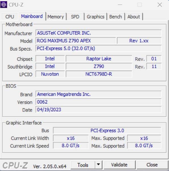

Test BIOS für Maximus Z790 Apex​
BIOS Ver. 0062
-fix S3 resume minor bug
-add Misc. Timings, now you can adjust memtweakit timings sheet #2 #3 #4 in bios.
Download: LINK
Quelle: LINK
Läuft einwandfrei...... (y)

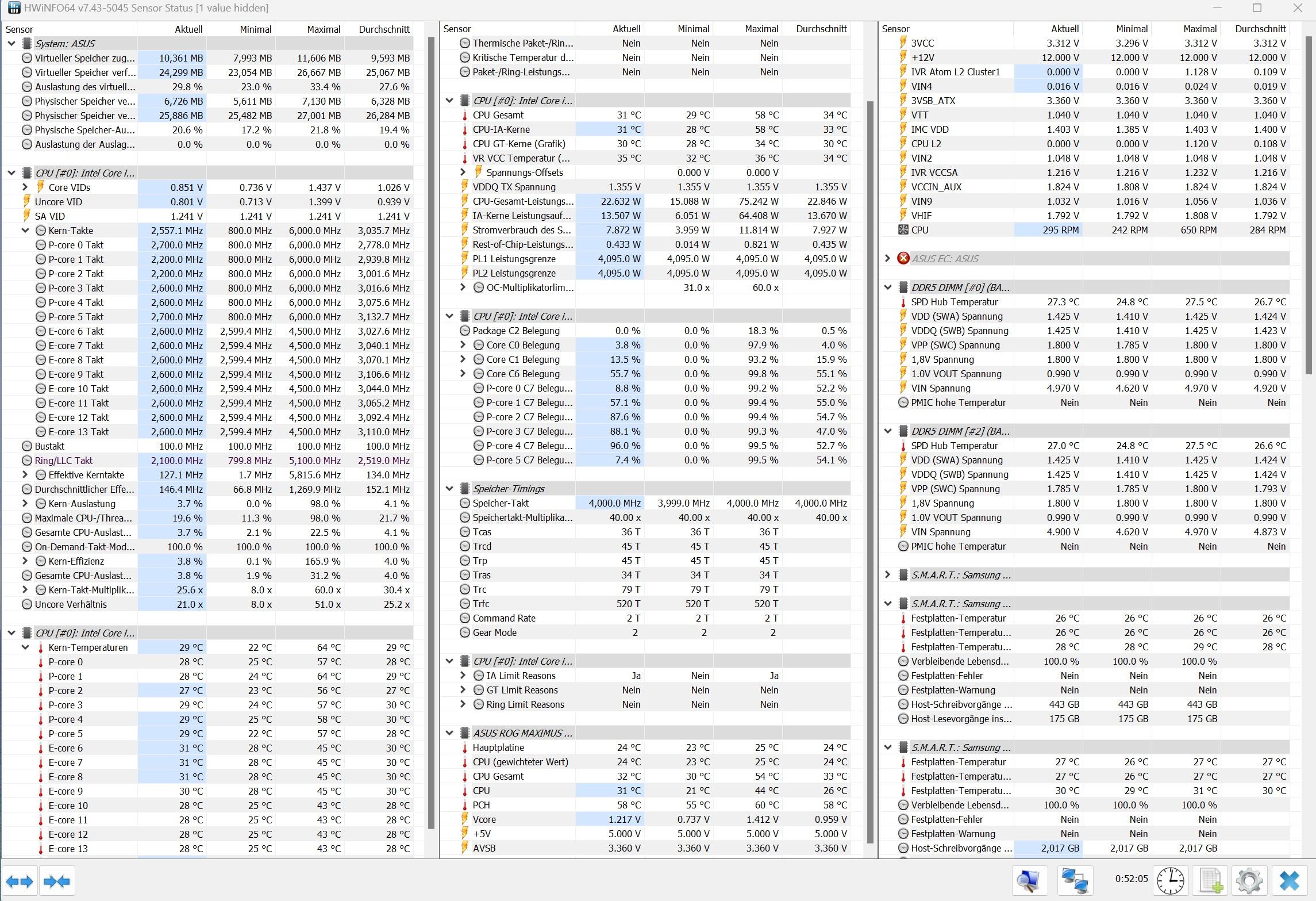

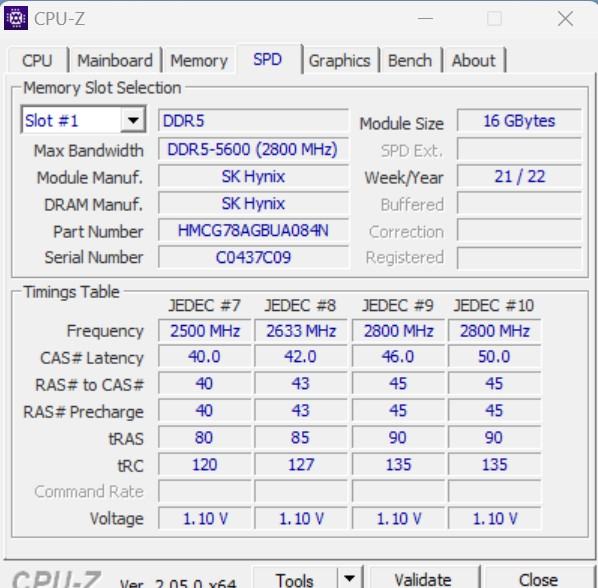

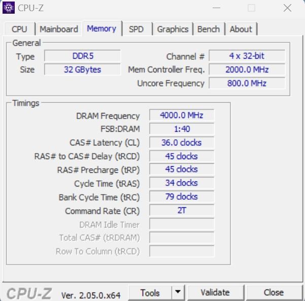

  • 8000-CL36-84N_setting.txt
