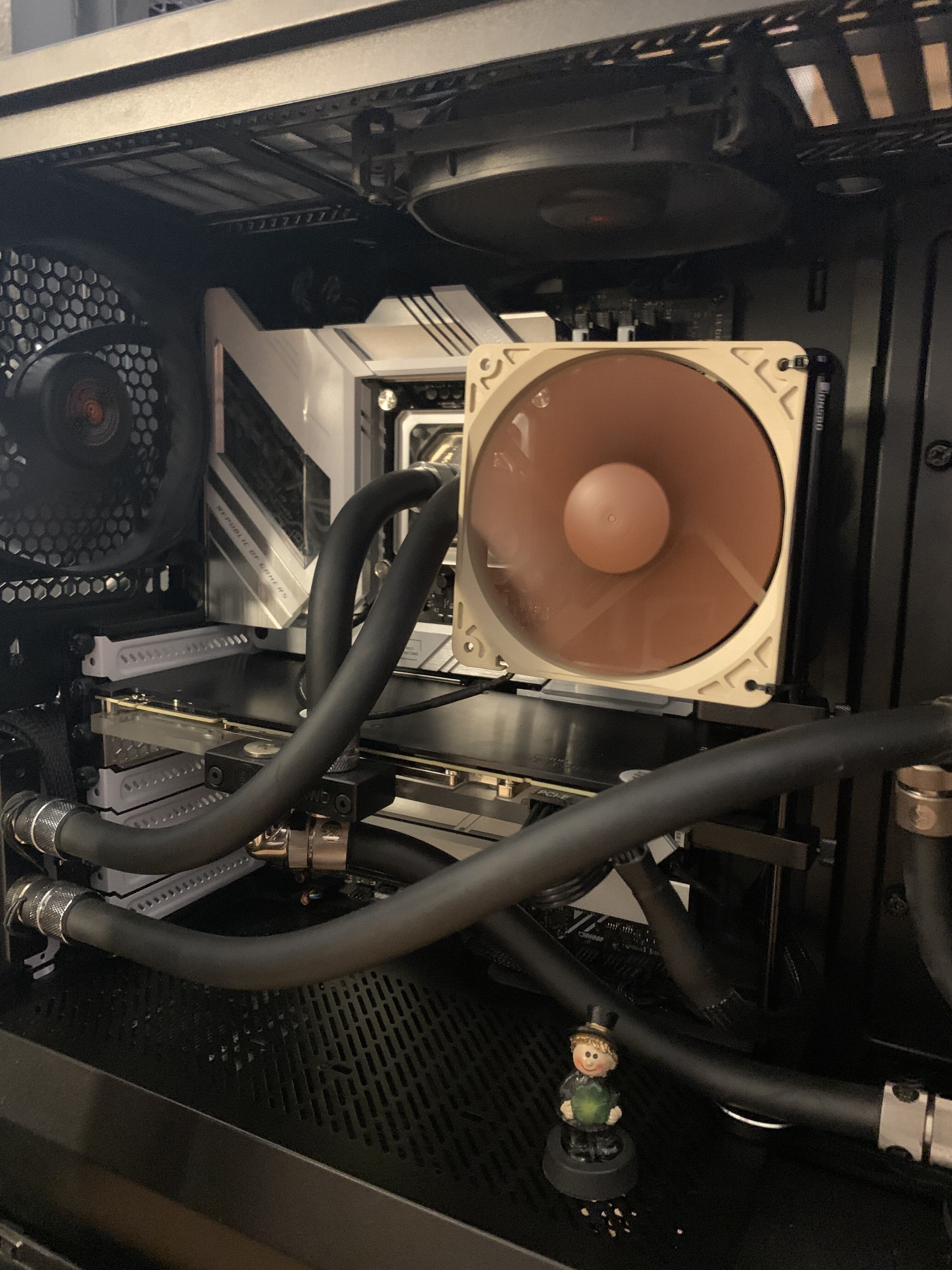

he has no watercooling, only fan with 800rpm on it.
i still call hoax, that kit is not possible.

He only has a Fan on his Rams with 800RPM and no water block.
35c dimm on Karhu, i cant even do that on water with my Mora 420 lol.

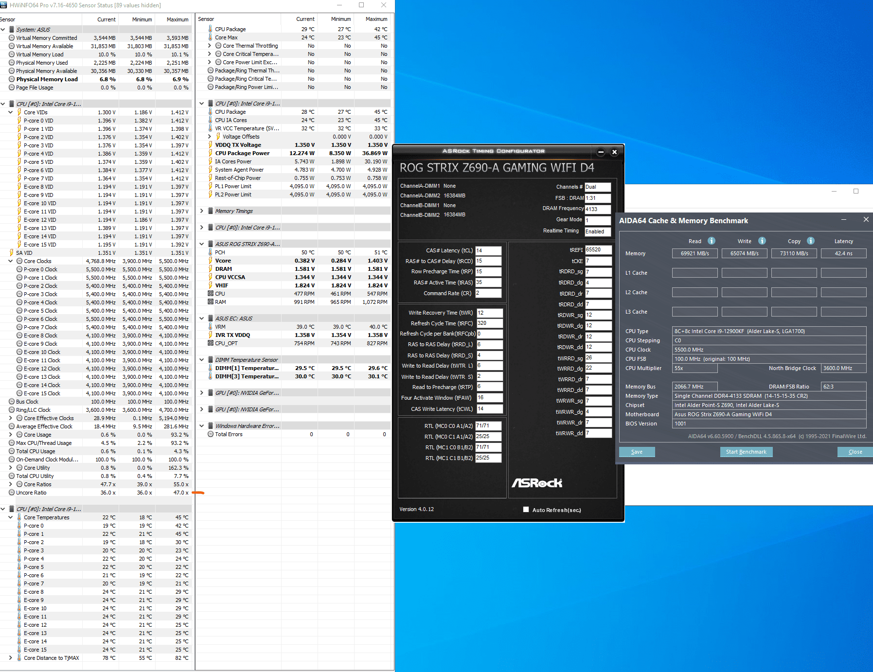

If you look at the RTLS they do not change with the cas latency, also the unchanged TCWL and TRDWR values when Cas is changing is a bit suspicious to me. I doubt that memtest run is real, probably changing timings in os.

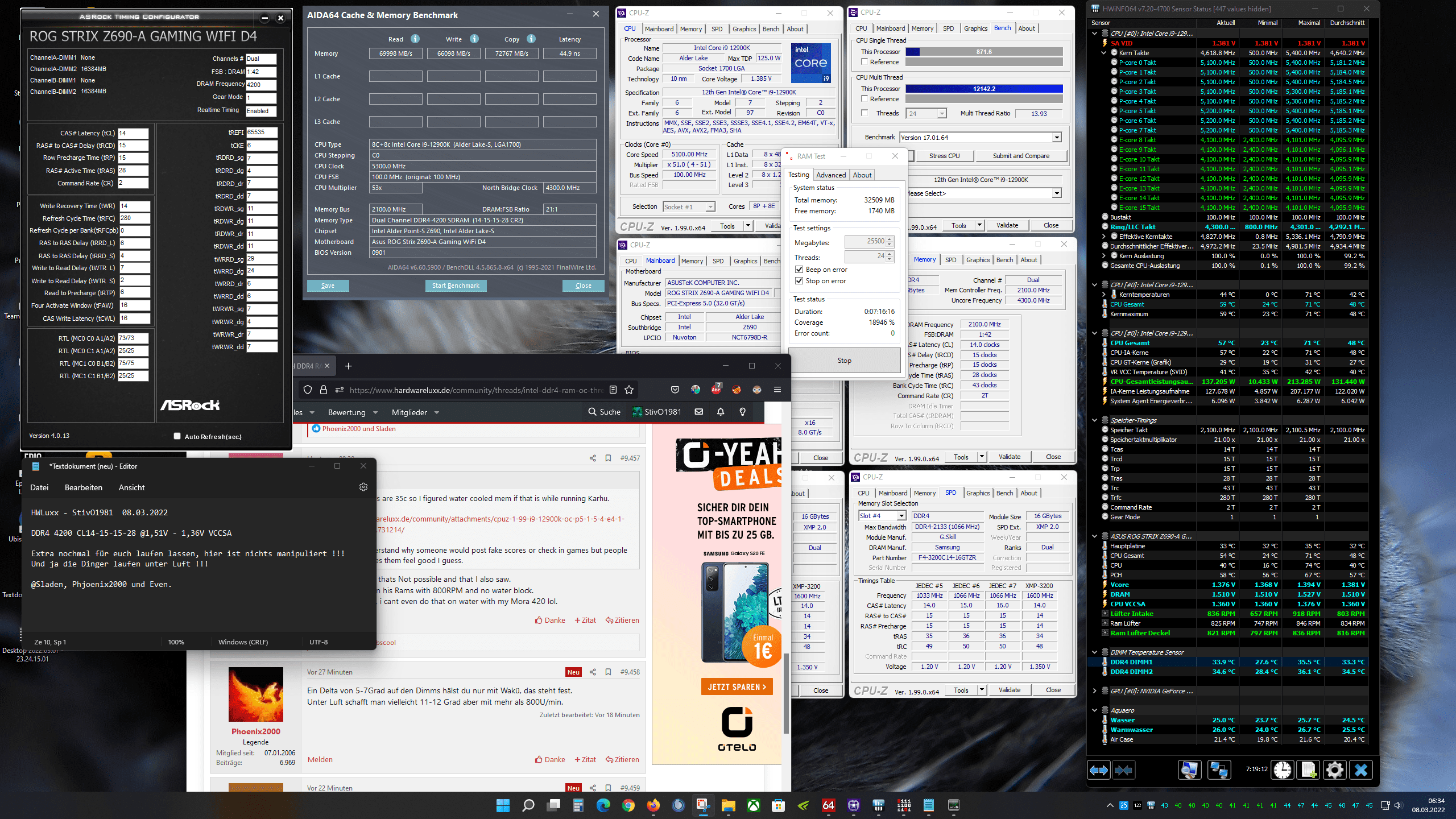

Kanns ja verstehen das ihr mir das nicht glaubt, hier nochmal ein Bild, Test läuft aktuell immer noch.
33Grad unter Luft?
Hast du die original HS ersetzt ?
Maybe I am being naive I think everything looks legit to me. Here are my timings when I was on z690 strix. I never ran 4200 to compare timings but looking at my 4133c14, his timings look fine to me.
His rtls are slightly higher as he is at 4200 vs my 4133.
Also you can "influence" lower rtls on z690. I dont not think I did that in that pic but it can be done and they can train slightly looser or tighter.
