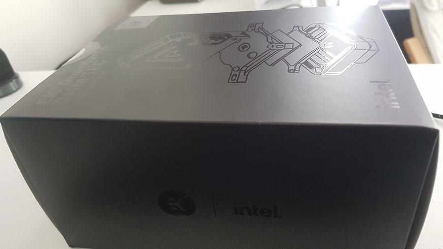

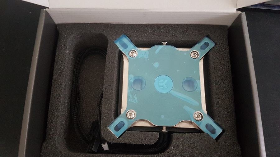

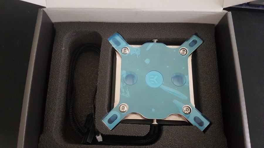

Moin,
time for big changes !!
Monitor; 27"->55"
neuer Kühlkern
