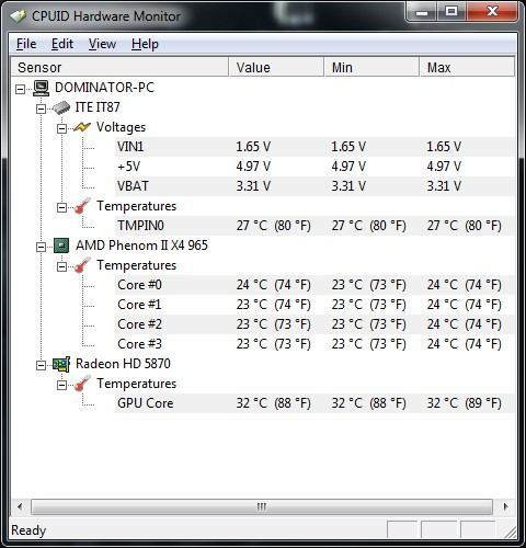

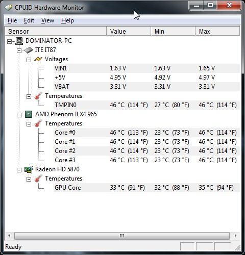

Corsair H50:
Idle Temps -> 42°
Unter Last 64-66°
CPU: i7-920 @ 3,6GHz
IDLE
attachment.php
LAST
attachment.php
