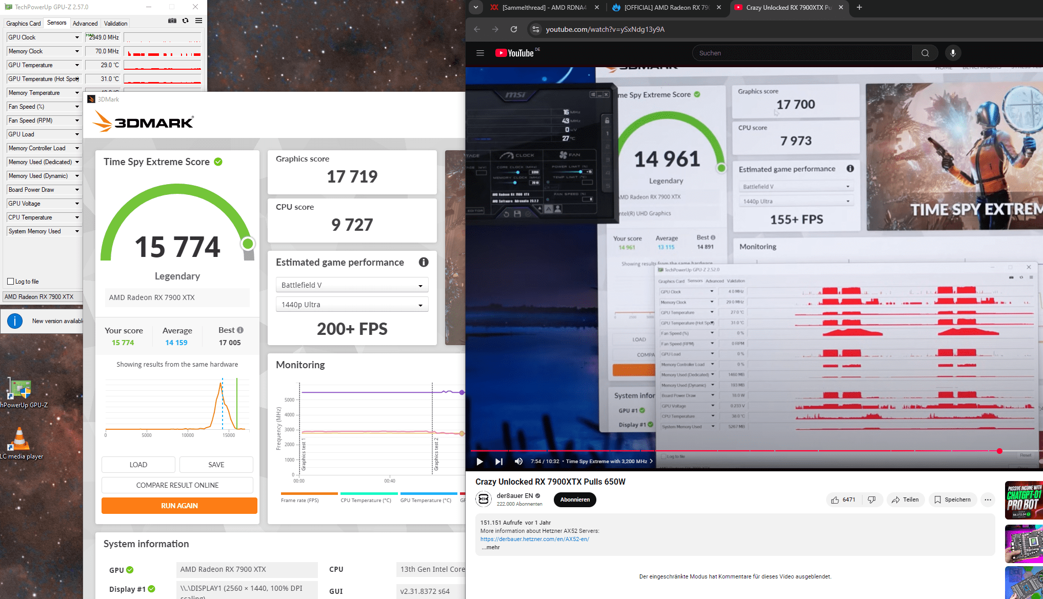

Ah, so tried to break into top 10 in HOF timespy gpu, before its filled with 3000$ 5090s later today... VERY SAD That I only made it to 11th, that run is in timespy rangelist.. and here were the only other 2 sucessfull runs out of 20 hours of benching I got:
#11 HOF rangelist Timespy gpu x1 HOF
43515 and 43418 intake air temp was -15c from outside.
Im going to try a few more runs but its already -8c and climbing fast now so I doubt it...systeminfo wrecks my recorded freqs and temps sometimes when I play with the EVC live as the run happens, but all runs were between 3590-3650mhz Core @ 1200-1300watts, and even with -15c air I was touching 110c at end of part 2 :(

Somehow I beat your 7900XT in TimeSpy Extreme, don't know how that was possible, but it looks like it is. First time ever in the actual top 3. What is top 1 or 2 unmodified in TimeSpy and Extreme nearly a year ago, but beating a modified card is insane. Would repasting get it even better?
And 350w with 8pin is insane, officially rated for 150w. 2x8pin is then definitely better than the 12pin Nvidia came up with.
Yeah that was on july 2023 drivers on my XT and anyone can tell you they were pretty bad in comparison to todays, and I was still on all stock XFX cooler at the time, Made a good run on my XTXs Time spy Extreme on modern drivers tho for comparison

@mantiz with the 12.1.24 driver and that temps score looks legit.
My XT did 1055 points more with 12.1.24 vs 12.1.23 and 6°C less and didn't Clock higher. And in TSE I'm beating Homex by 200 points, with 360mhz less and ~350w less, and scoring 520 points more than before.

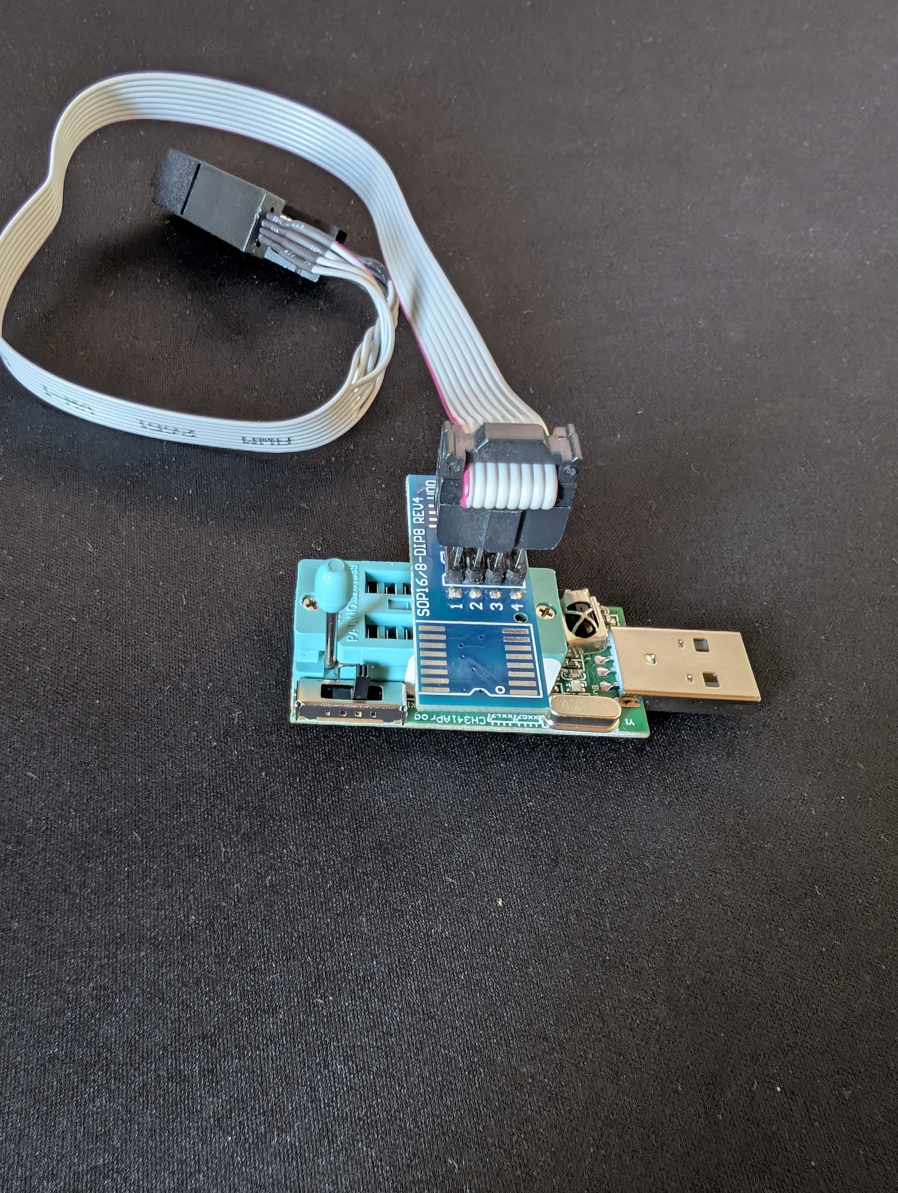

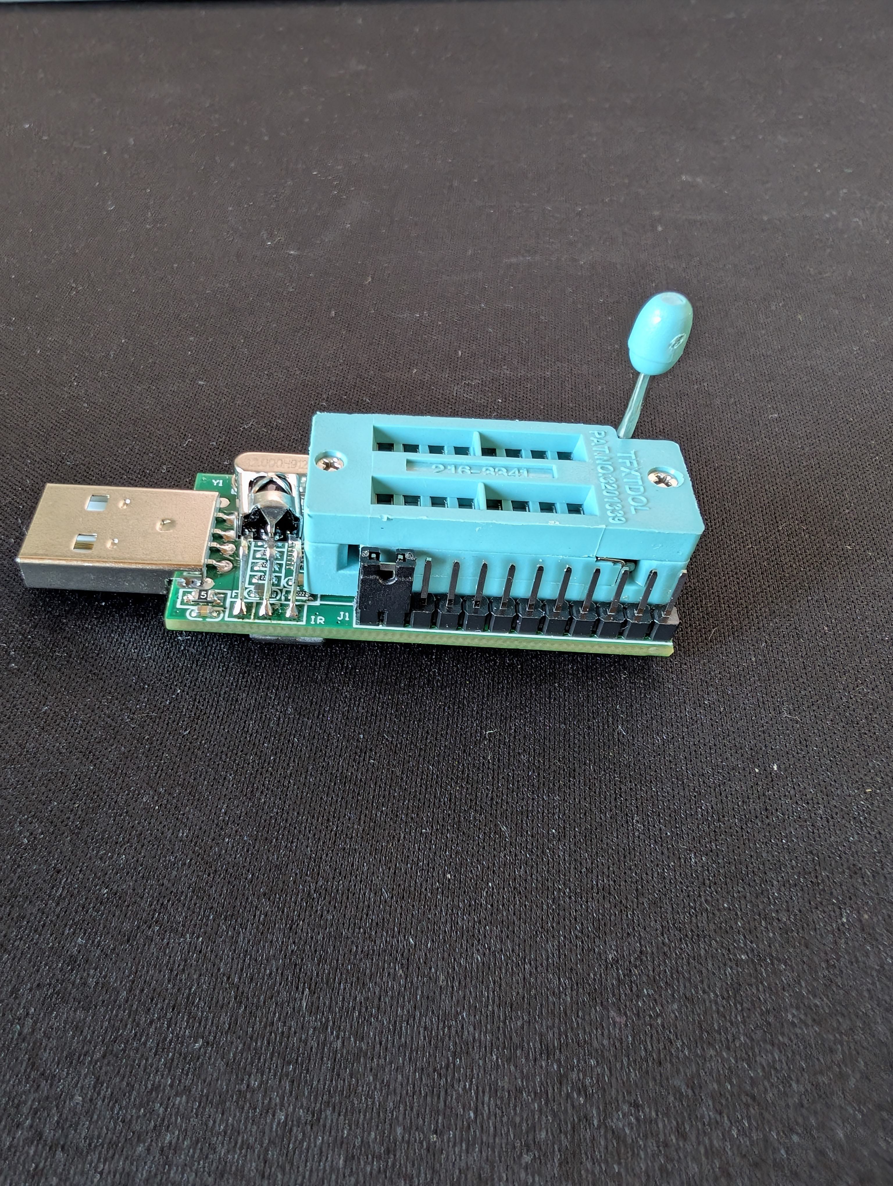

Okay, ne Anleitung o.À. war nicht dabei. Der Switch muss dann auf (vom Bild aus gesehen) welcher Position stehen?
Edit: laut Unterseite wäre 1,8V ganz links, sollte dann auch links stehen, oder?
Auf der anderen Seite ist auch noch ein Jumper, ist der so richtig?
Und ist die Richtung der Klemme auf dem BIOS Chip relevant oder meckert die Software dann wenn's falsch wäre?

Musst drauf achten, dass der 1. Pin (rote Litze) an den Pin 1 des Chips kommt (meist mit nem Punkt gekennzeichnet). Software meckert, kann im schlimmsten Fall aber auch nen Defekt verursachen.
Jumper passt. Zu dem Schieberegler gibts die Legende auf der Rückseite :)

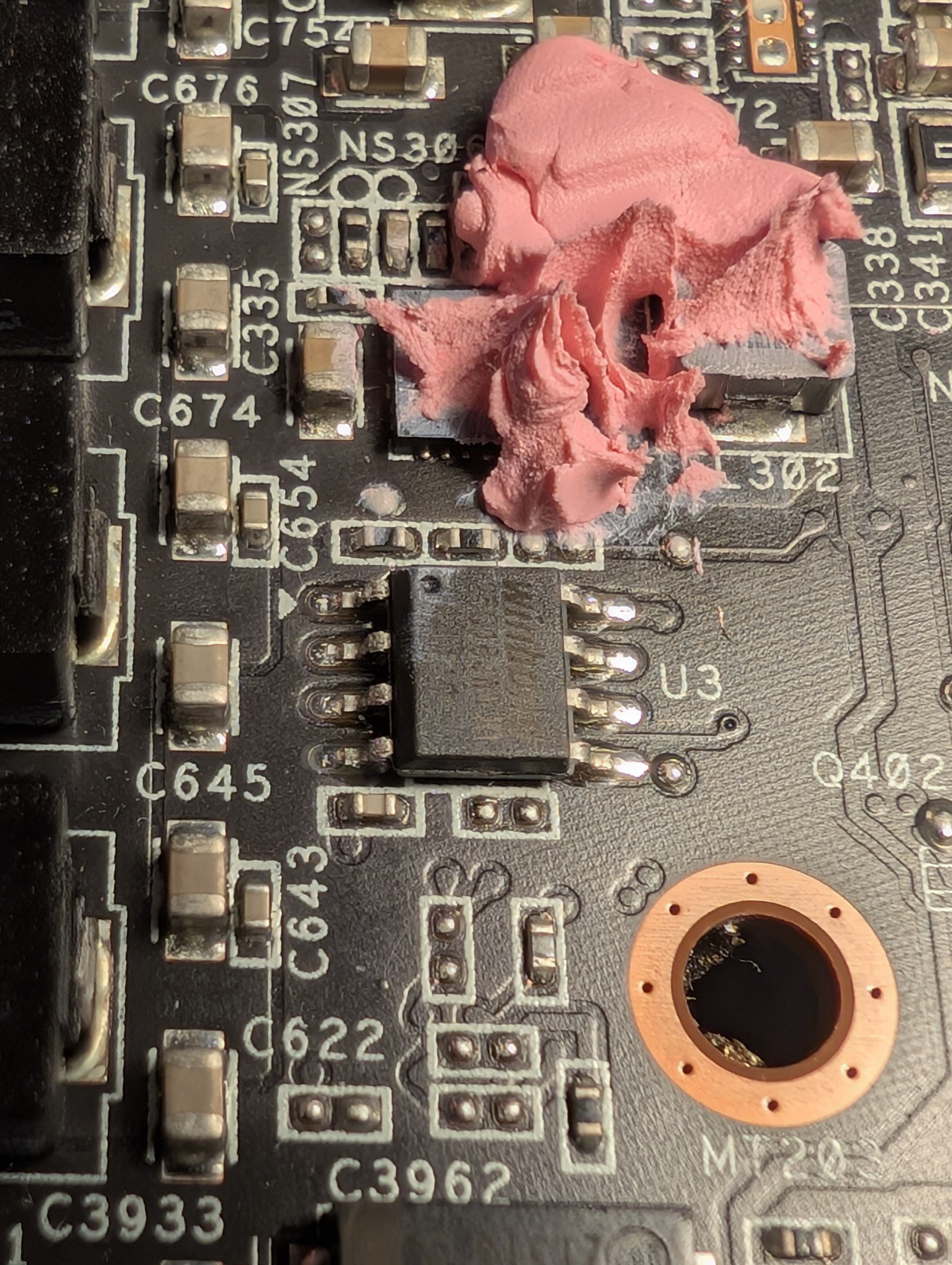

BIOS Chip sollte doch der hier sein, oder?
EDIT: der Programmer hat das hier aus dem Chip ausgelesen: W25Q16FW
EDIT2: DiagnoseLED für VGA am Board leuchtet auch :wall:

Kann auf dem Foto nur winbond 25 entziffern. Live geht das bestimmt besser.

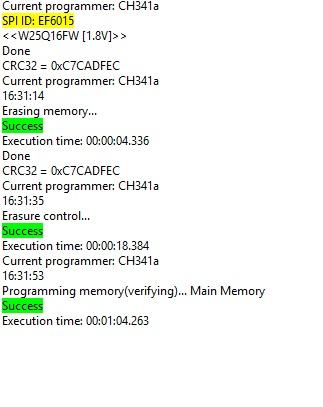

ich hab den Neoprogrammer genommen und, Anleitung wie im Screensot (siehe Anhang), nur halt im ersten Versuch mit dem ausgelesenen Chip und im zweiten mit dem in der Anleitung.
BIOS: https://www.techpowerup.com/vgabios/260050/260050
Chip müsste mit dem übereinstimmen, was der Programmer ausgelesen hat: W25Q16FW
Beim flashen hab ich gelöscht, dann geschrieben mit Blank Check, Write und Verify angehakt
So sieht das BTW im Programmer aus:

Mus jetzt aber erstmal neues Putty und WLP auftragen, der Wasserkühler hält gerade nur durch 2 Schrauben der Backplate :fresse2:
