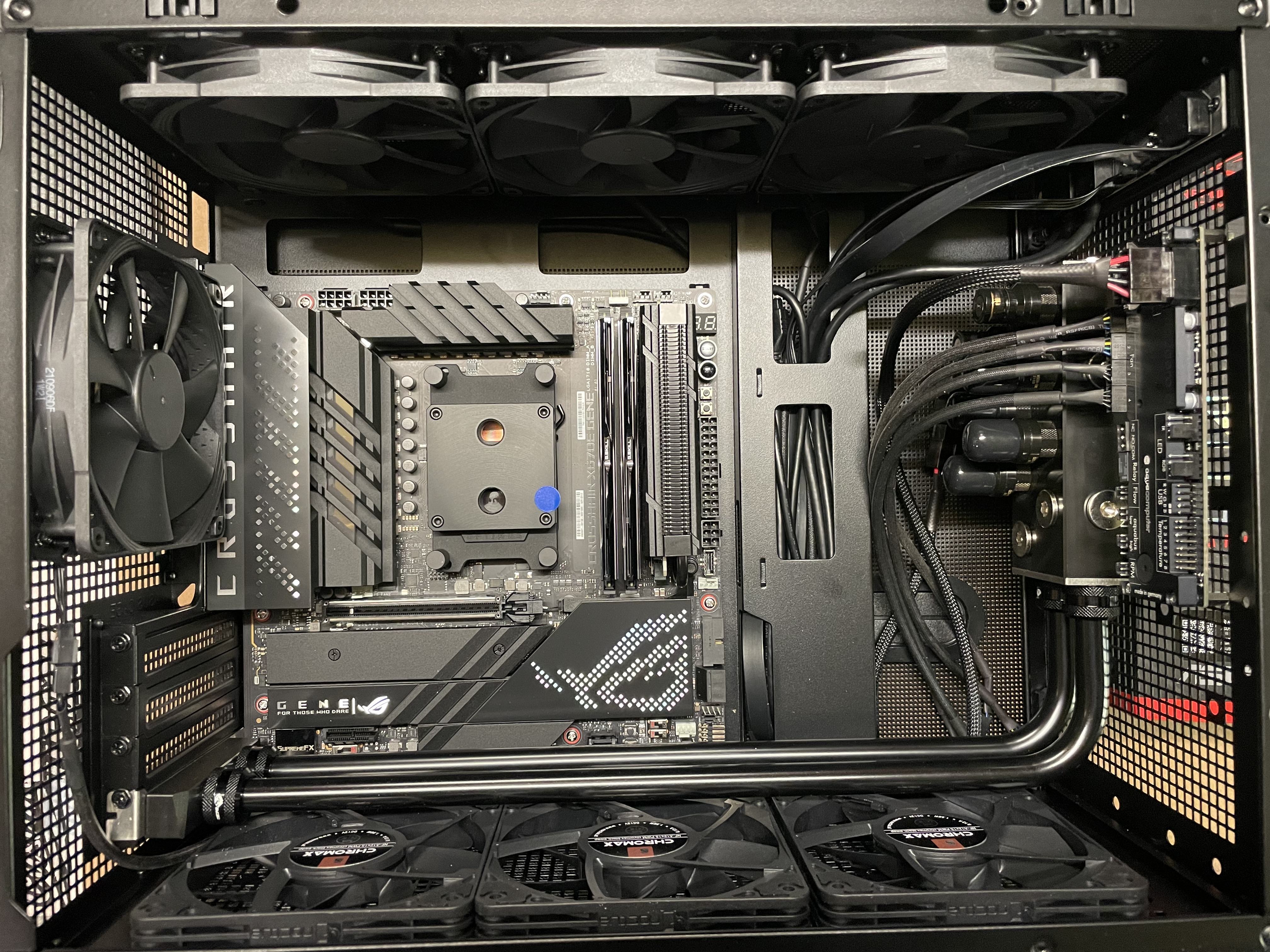

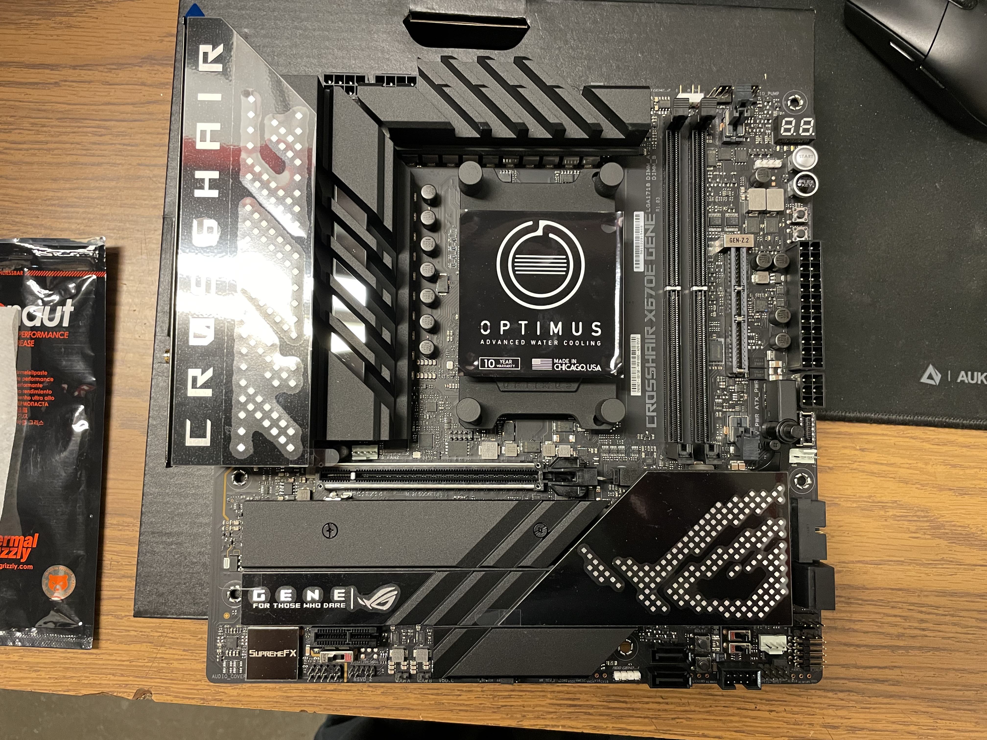

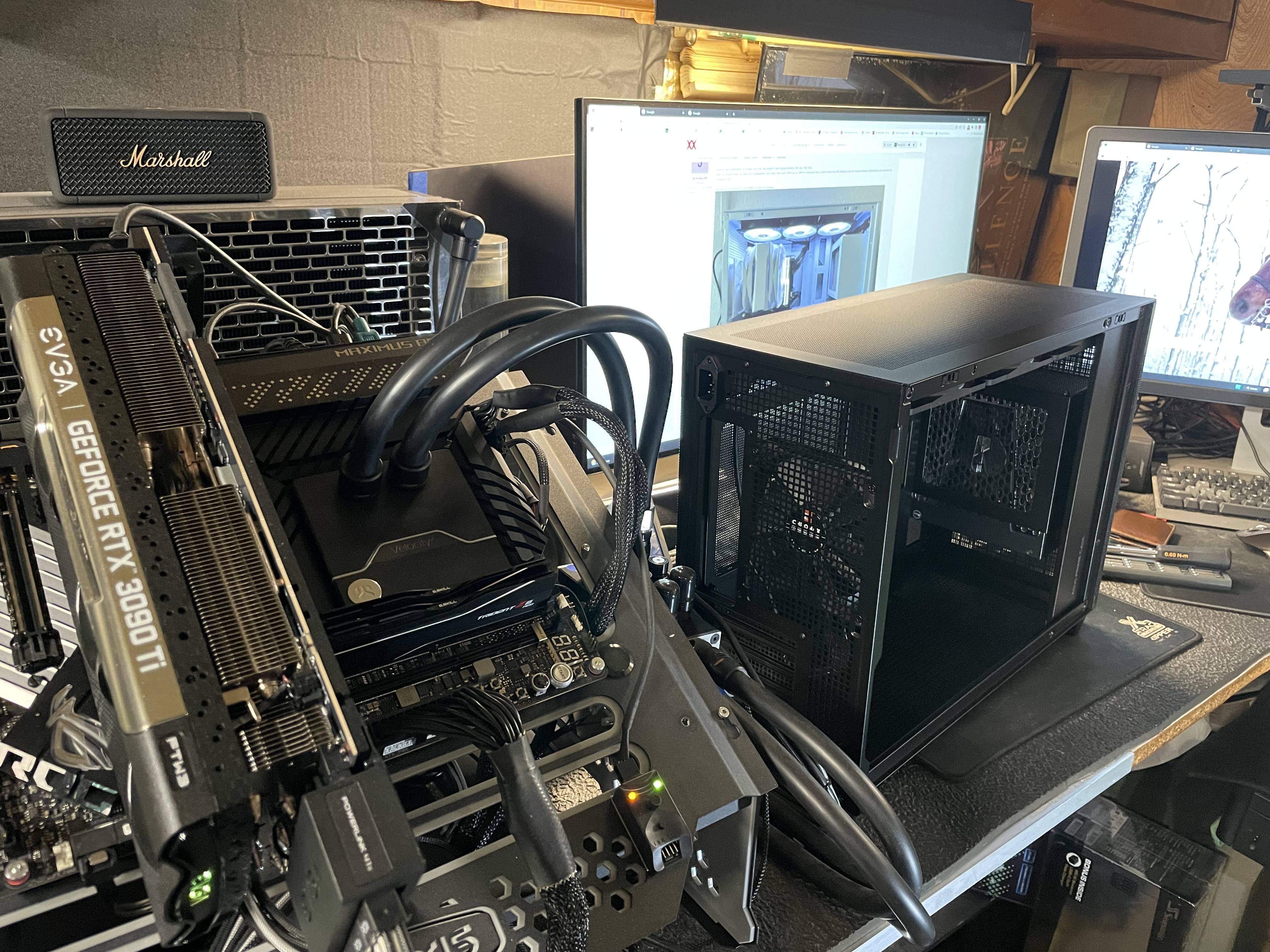

This morning I started a new build in the Asus Prime AP201 chassis.
System Specs without graphics card, I'm waiting on Dec 13th Radeon 7900 XTX launch,.. will be running on Intergraded graphics till reference card arrives, Pre-ordered water block on Nov 4, 2022 from EK with shipping date ETA of Dec 21 , 2022. I might put in a place holder GPU till 7900 XTX arrives, for now just running on IGPU to get system set up, running.

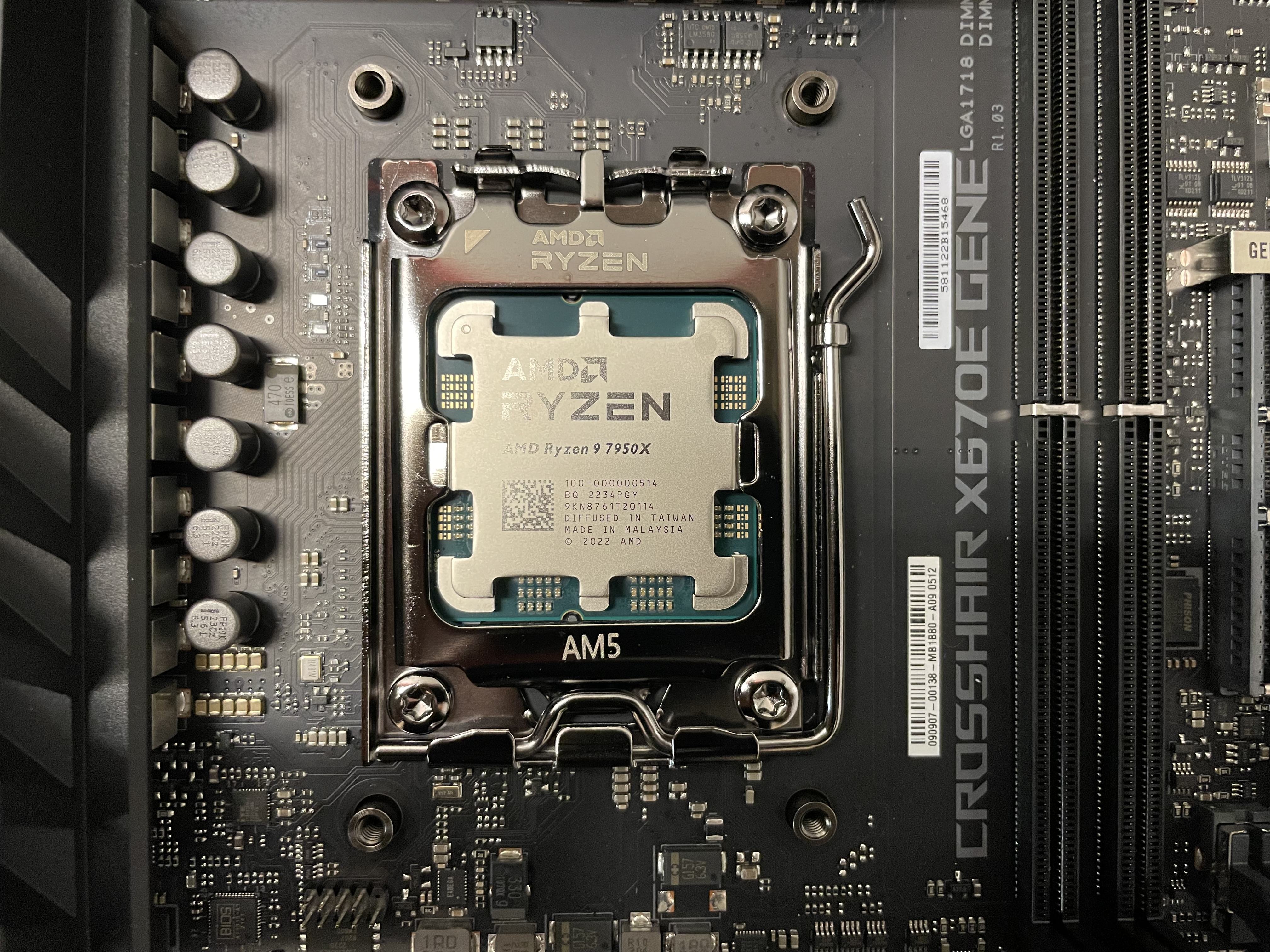

System Specs: Asus Crosshair X670E Gene, AMD Ryzen 9 7950X, F5-6000J3038F16GX2-TZ5N, Samsung 990 Pro 1TB Primary drive, Seagate 530 4TB storage drive, Externally mounted SeaSonic SSR-1600TR, Custom water cooling MORA 420 Pro, Optimus pump/res , Optimus AM5 CPU block, EK-Pro Manifold 2CPU 2GPU- Acetal, EK-RX 7900 XTX GPU block.

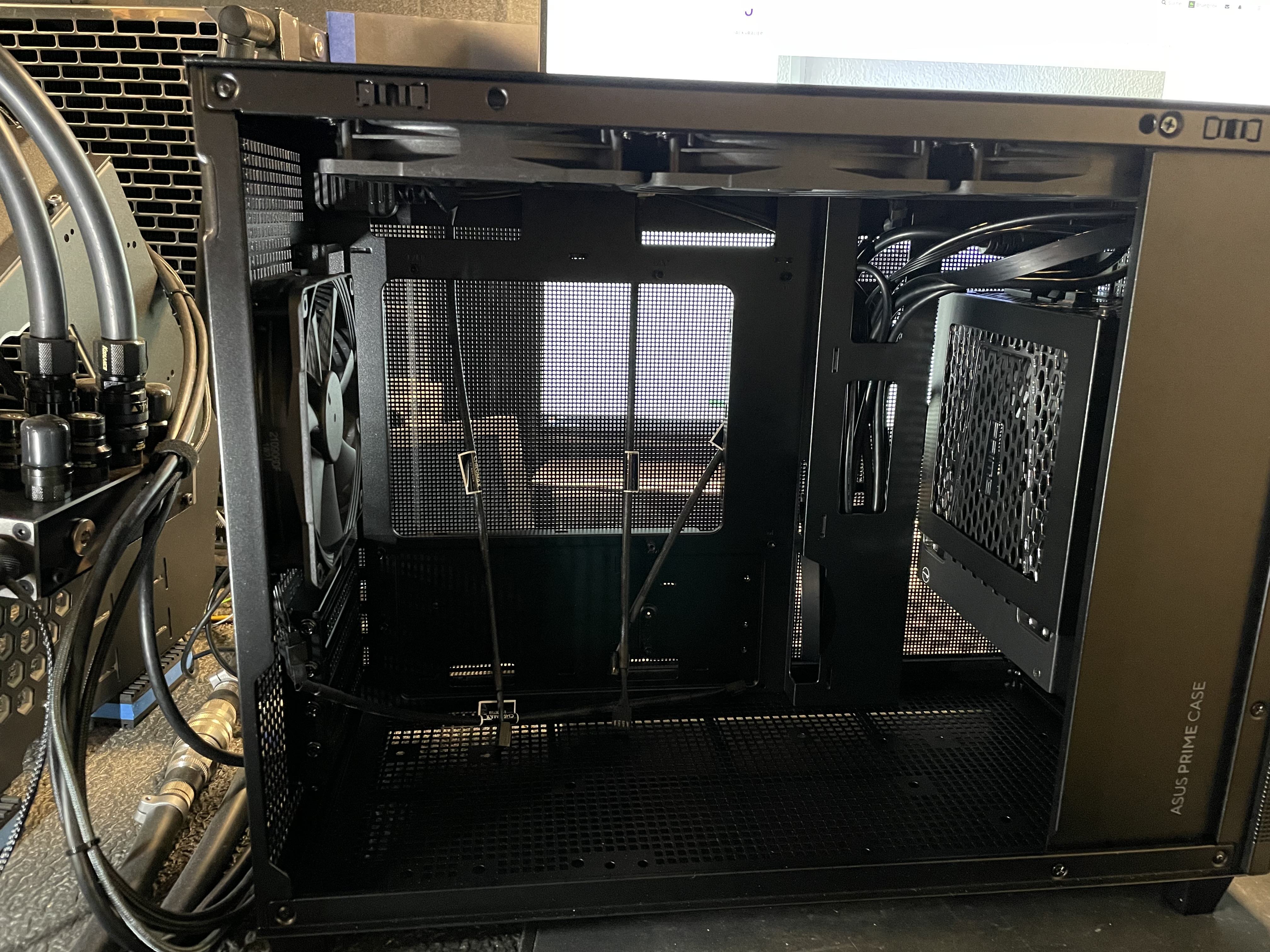

I'm tearing down Z690 Apex system that's on wet bench now, originally the plan was to just drop Crosshair X670E board on wat bench and go,.. but decided to modify the AP201 with 37mm x 75mm rubber grommets for PSU cables to motherboard, I plan on running water lines through lower rear IO Slot with WC-50601 PCI Slot Pass-Through Bracket.
I installed a Seasonic SSR-1000TR in chassis front PSU bracket, it fits but it takes up lots of space. So I decided to pull 1000W PSU, and go with externally mounted 1600W.
I'm going to mount EK manifold on front panel instead of internal mounted PSU.
Prepping motherboard with CPU & Optimus AM5 Block.
Still lots of planning to get water lines ran, going with hard line Bykski Metal Pre-Bent Ridgid Tubing- Black Coated Copper 14mm OD for the manifold, and Watercool EPDM 16/10mm black matt tubing with quick connects for all the hardware blocks.
I'll post some follow up photos after I get the board installed, some water lines ran. Lots of cutting, grinding to do before I install motherboard, lol

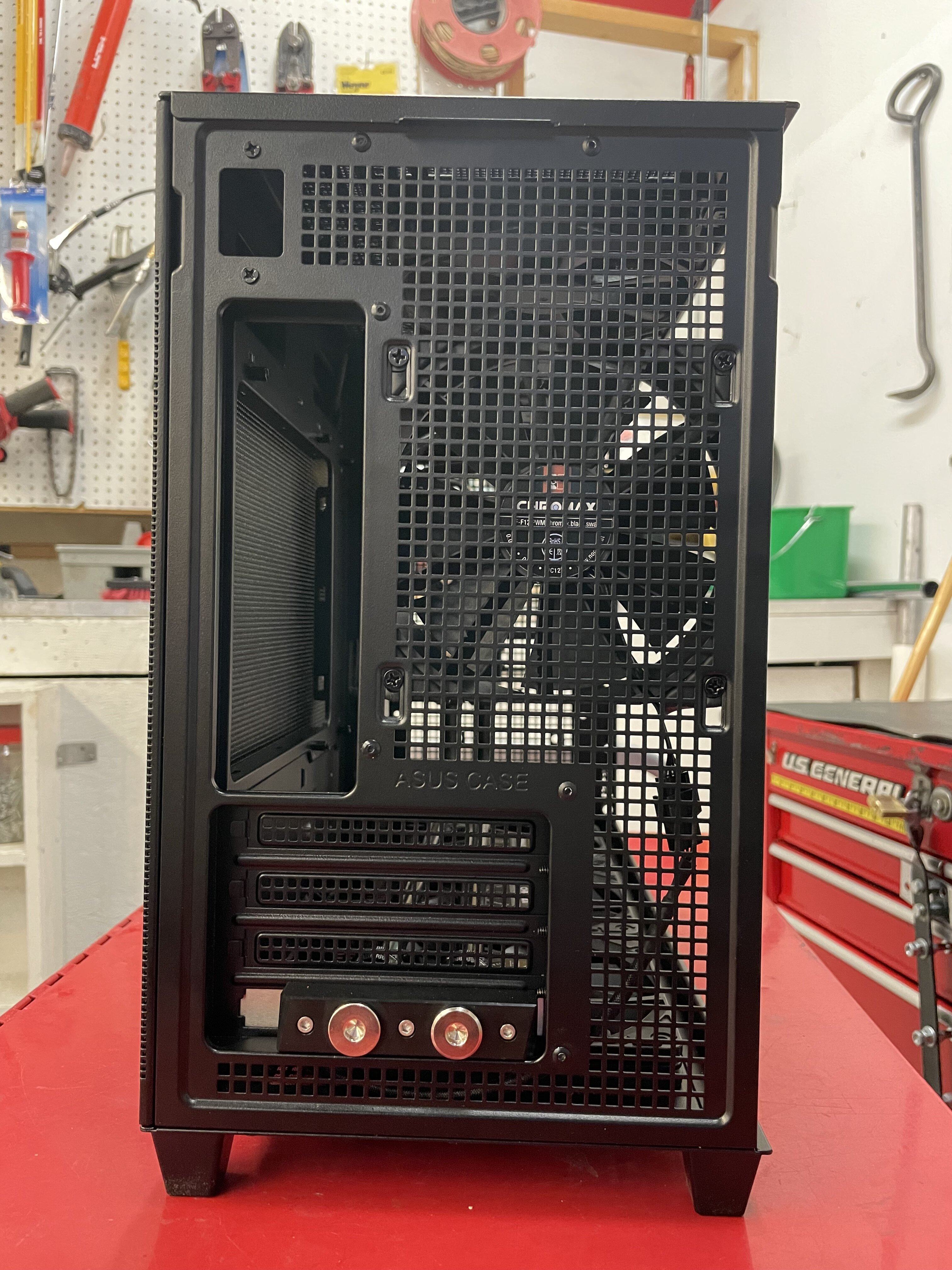

I got the manifold in, and the gourmet for power cables installed on back panel today.
Leak test on manifold was good, ready to install motherboard.

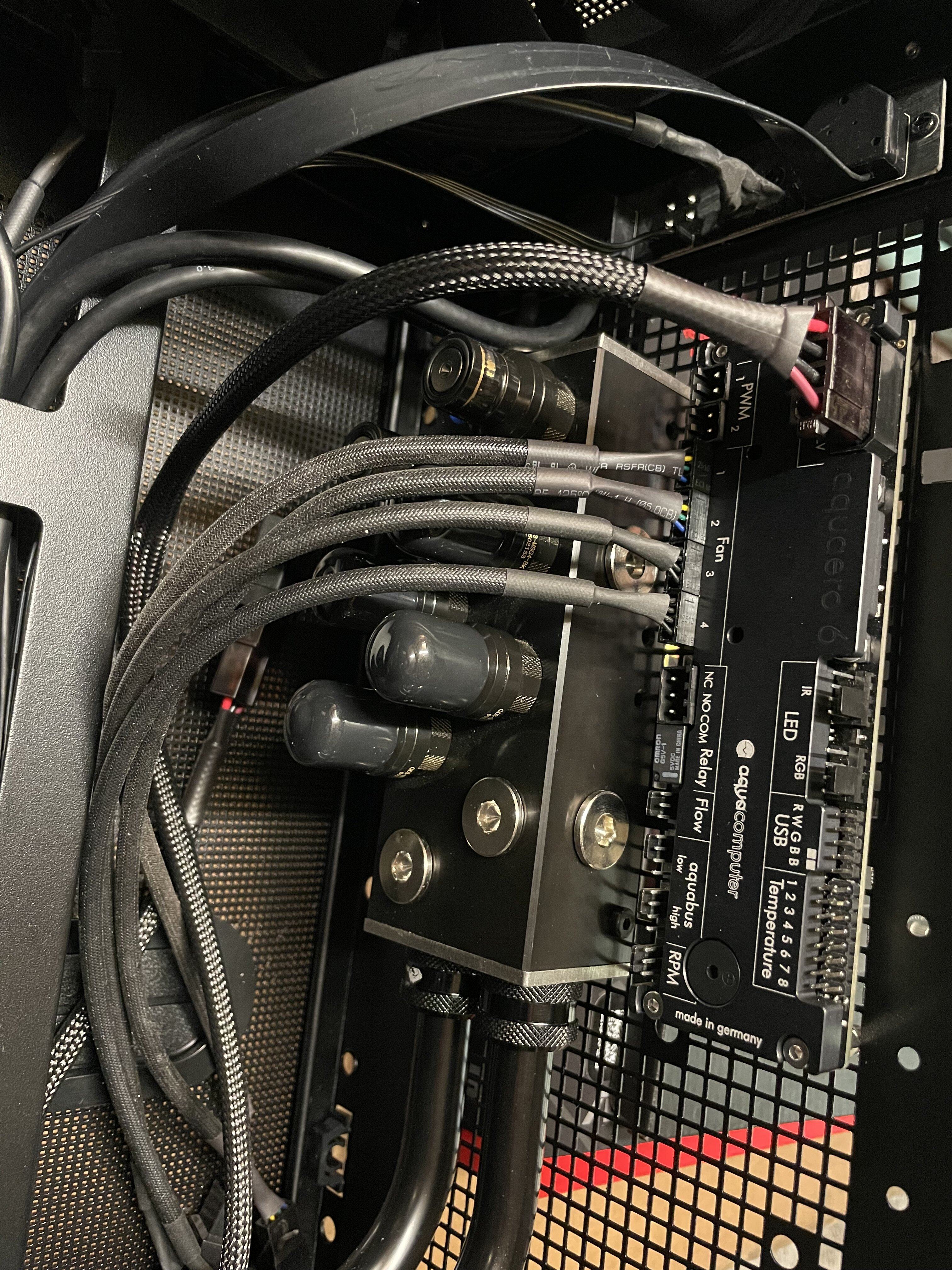

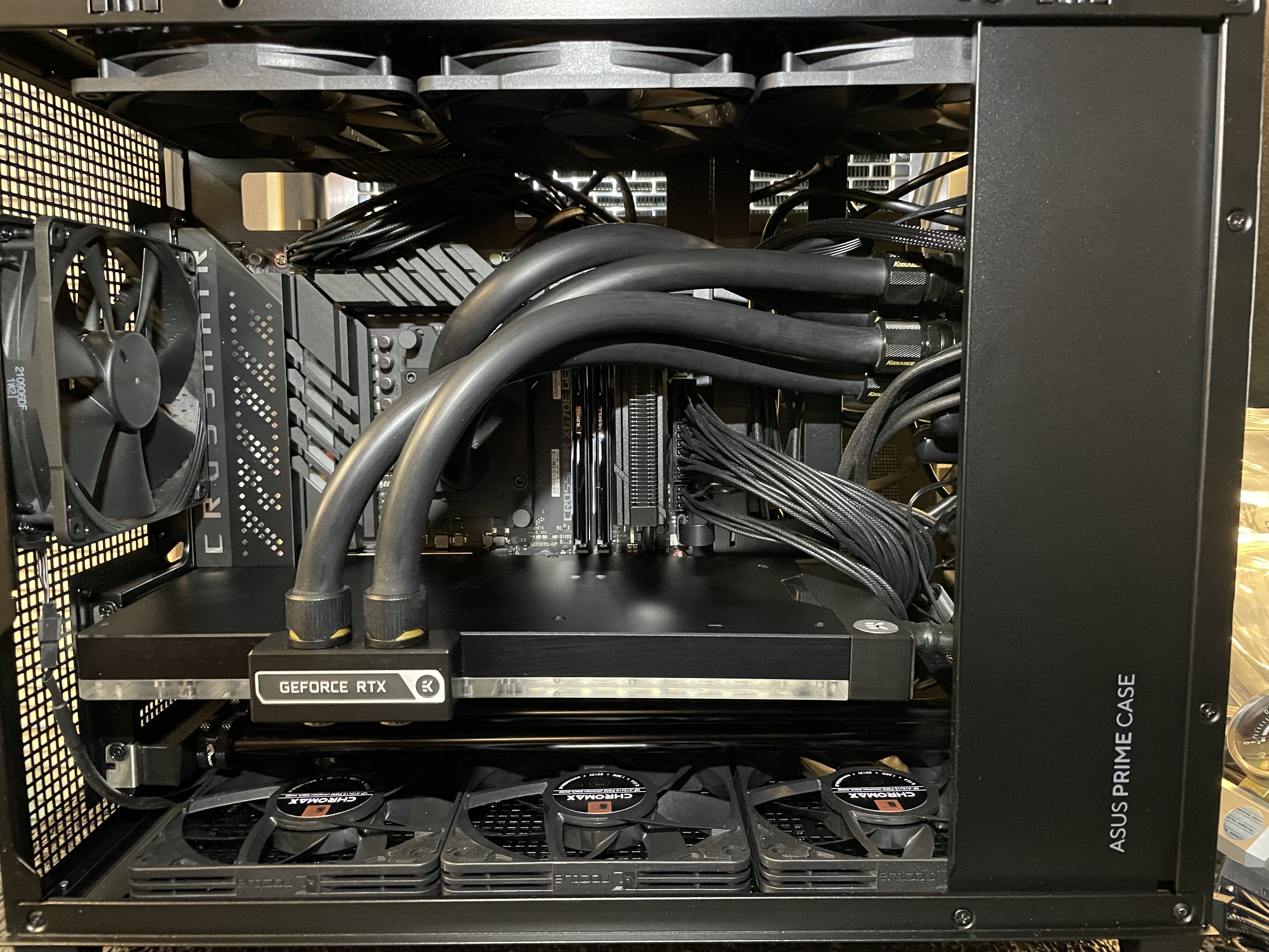

I got the motherboard, memory, aquaero, and primary drive in the Gen-Z2 card today.
Started running fan cables, temp, flow sensors, 4-pin to SATA power and motherboard 9-pin USB to aquaero.

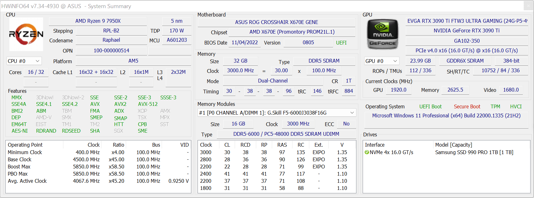

System is up and running, with no issues.

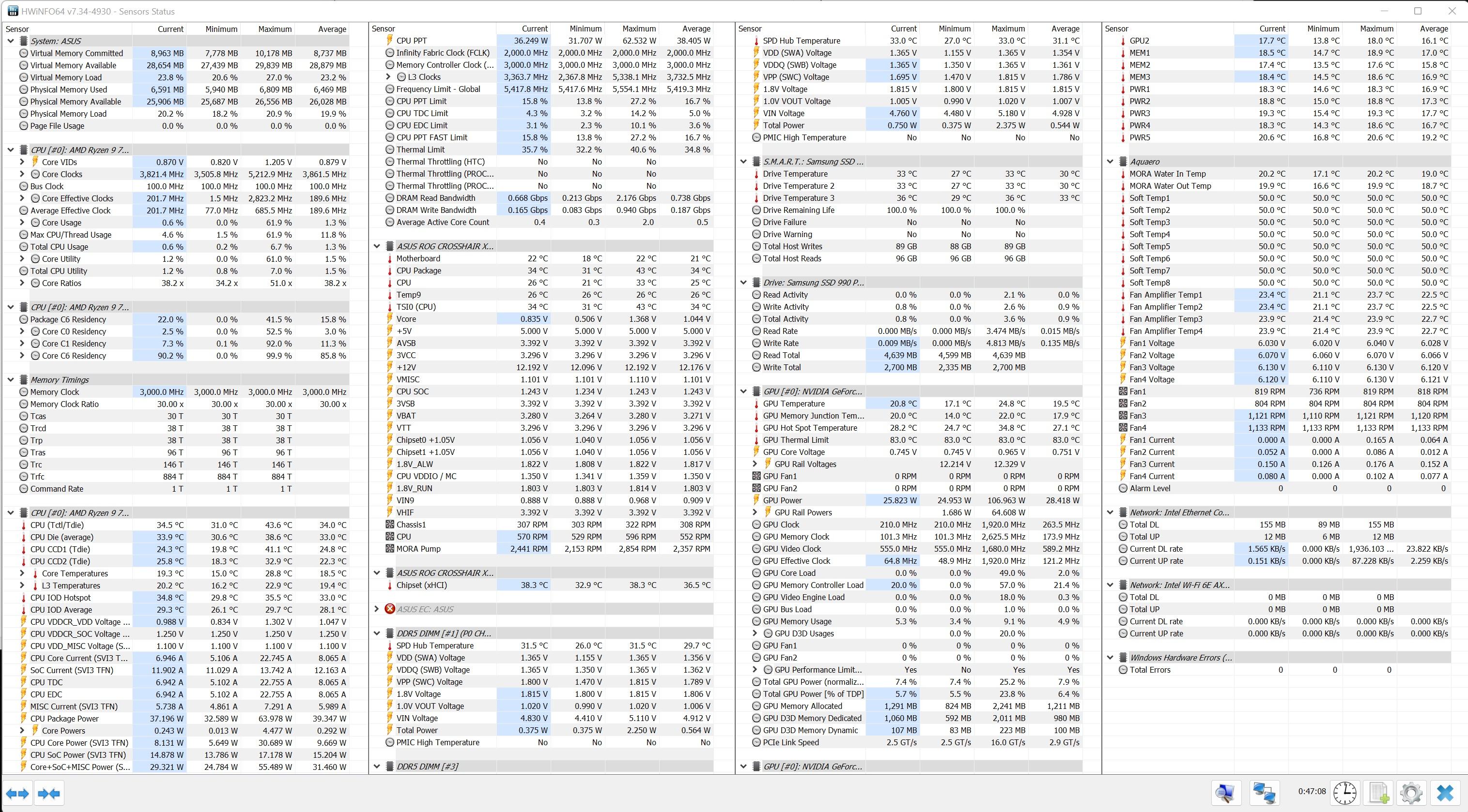

Running default settings the performance and temps are good,.. under normal usage, light loads the average active clock is 3,861 MHz @ 0.879V with temps average 34c.
Under heavy loads running boost x58.50 the temps will jump up to 93c and then level out to 70c while running benchmarks, stress tests.

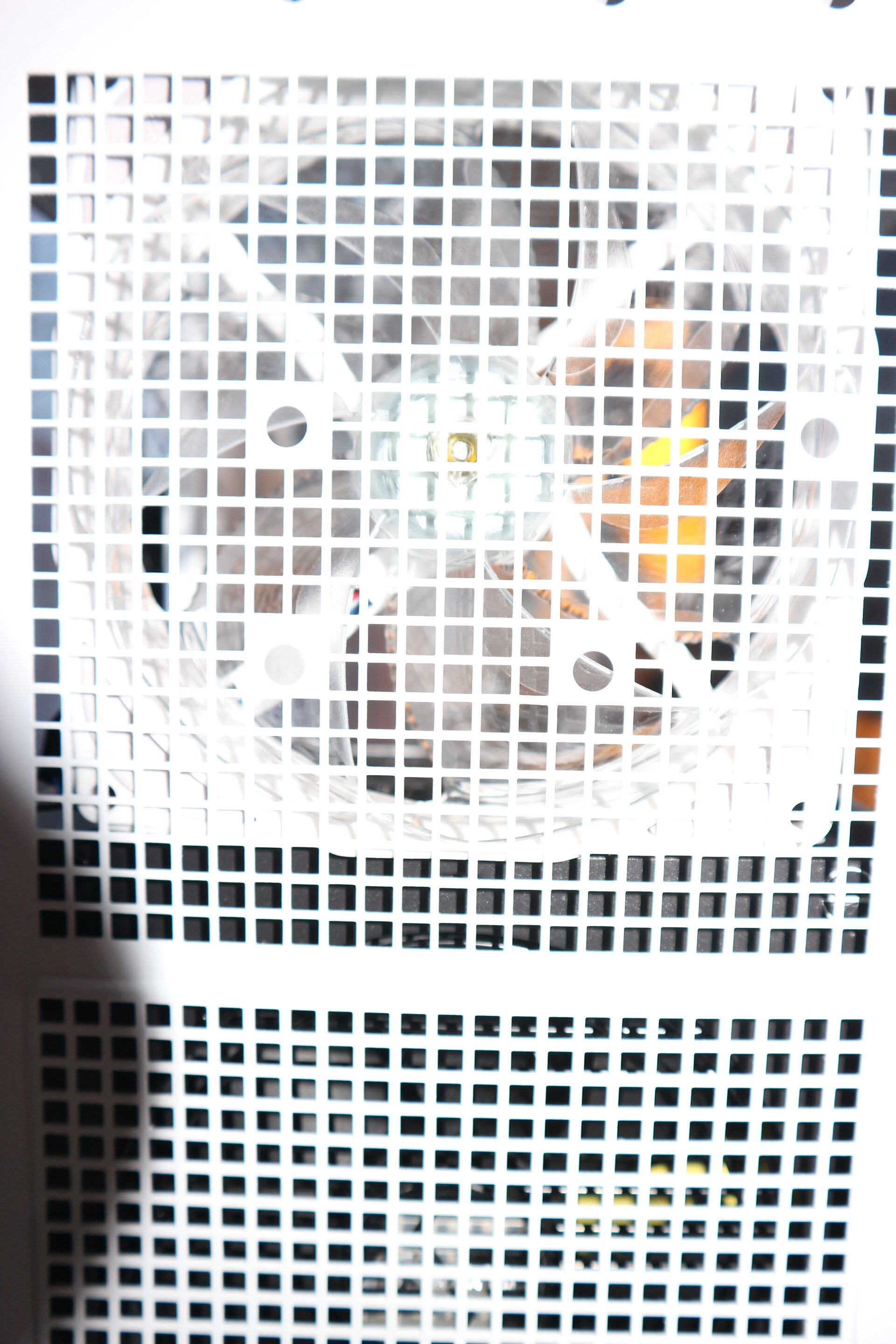

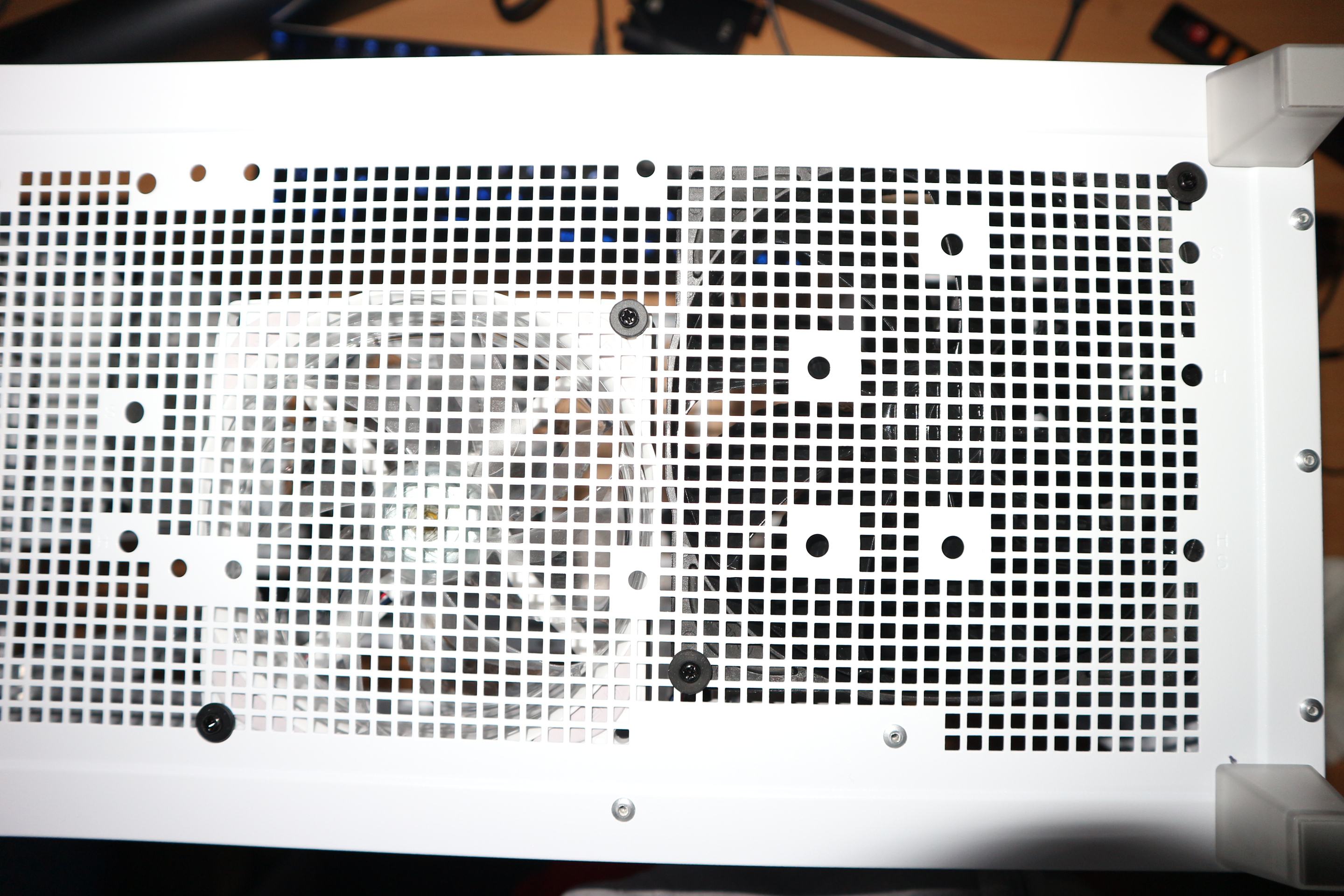

Heute das AP201 ausgepackt und mir Gedanken zur Lüfterkonfiguration gemacht. Folgende Erkenntnisse habe ich gewonnen und möchte ich - falls noch nicht bekannt - mit euch teilen:
- Lüfterplatzierung kann an der Unterseite frei gewählt werden, man ist nicht an die 8 Löcher für 120er Lüfter gebunden
- die quadratischen Löcher haben exakt den Abstand passend für 120er Lüfter (siehe erstes Bild)
- drei 120er an der Unterseite sind möglich
- 140er (max. 2 Stück) an der Unterseite möglich, aber: die Abstände der quadratischen Löcher sind 1 mm zu kurz, mit Entkopplungsgummis oder dem Noiseblocker-System geht es aber (siehe erste Bild, rechte Seite)
- an der Front kann man gerade so einen 120er Lüfter mit Entkopplungsgummis befestigen (siehe zweites Bild), in meinen Fall sitzt der Netzteilrahmen in höchster Position und Netzteil ist ein 14 cm kurzes Seasonic Focus

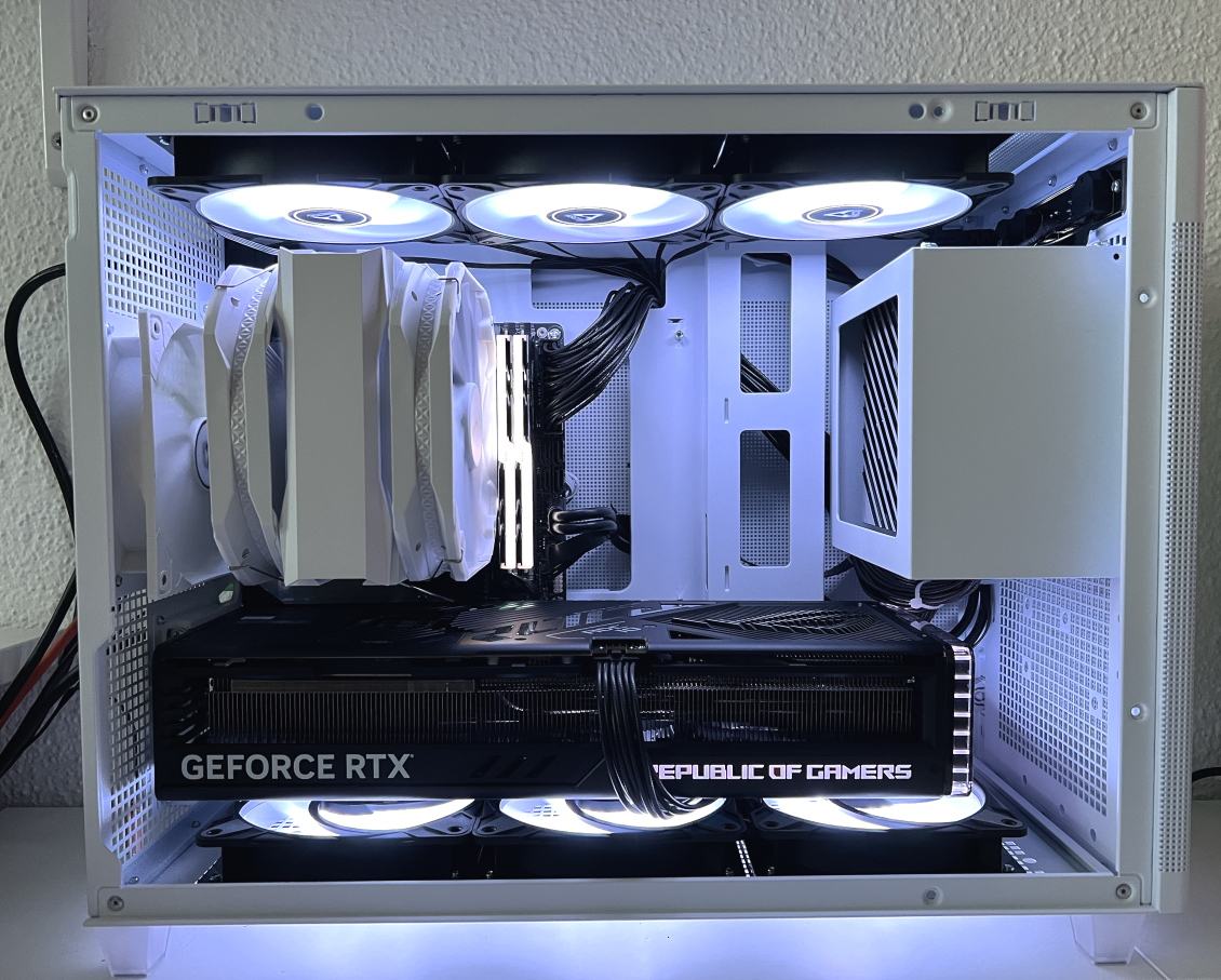

Leute, ich brauche mal euren Rat. Bin nicht sicher, ob ich mir das Gehäuse in Weiß oder Schwarz kaufen soll.
Fast alles meiner WaKü ist in Schwarz und da sieht sowas wie hier natürlich geil aus.
Reddit:
Wenn man jedoch das weiße Gehäuse mit einem guten weiß oder Metallic MB und GPU kombiniert, sieht das auch geil aus.
Sehr schwierig. Hat jemand von euch evtl. hier ein Weißes mit einer WaKü?

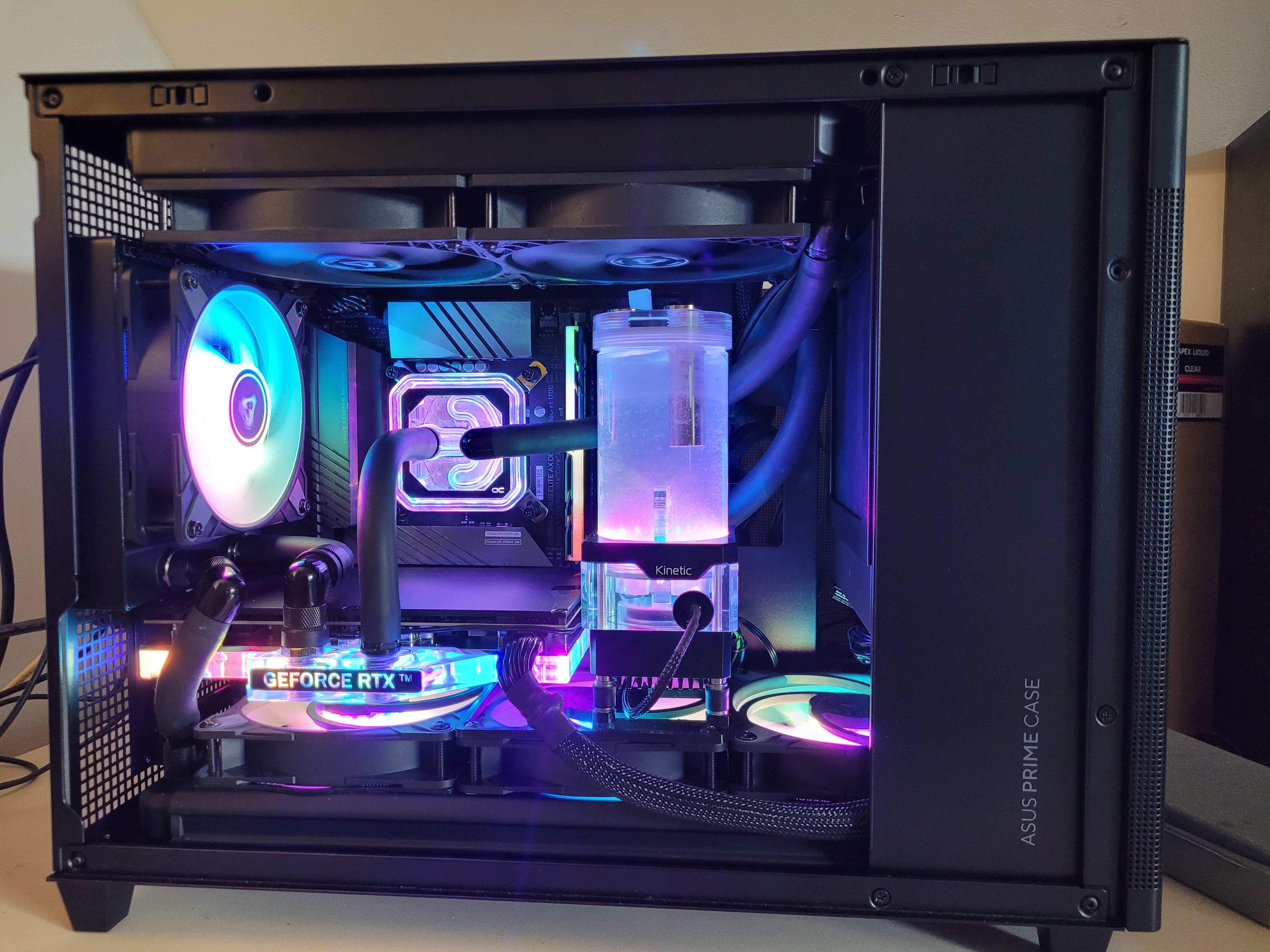

Ich musste auch mal wieder rumbasteln.
Habe hier im Forum einen Rechner gekauft, welcher in ein Asus AP201 gebaut wurde. Das Teil war eigentlich für einen Kumpel vorgesehen, was er dann doch nicht haben wollte.
Habe dann hin und her überlegt, ob da meine Custom-Wakü mit einem 280er und einem 360er reinpasst oder ob ich das Teil einfach komplett weiterverkaufen sollte.
Bin zu dem schluss gekommen, dass es passen wird. Also meine komplette Hardware aus dem schönen Antec P20C ausgebaut und in das kleine Asus reingeworfen (ausser dem Mainboard natürlich, mein ATX hätte da nicht rein gepasst. Dafür habe ich das vorher schon verbaute Gigabyte Z690m Aorus drinnen gelassen).
Die restliche Hardware ist:
13600kf
32gb G.Skill Trident Z 3600MHz CL16
Be Quiet Straight Power 850W
Inno3D 4080
Wasserkühlung:
ST30 280
Black ICE Nemesis gts 360
EK Coolstream 120
EK DDC pumpe-agb-Combo
Alphacool Block für die 4080
Ich bin echt fasziniert, was in dieses kleine case alles reingeht.
Die Kühlleistung ist völlig ausreichend, obwohl aktuell ein Lüfter auf dem 360er ausgeschaltet ist, weil der wohl n Lagerschaden hat und um den auszubauen muss die GPU raus und entsprechend das Kühlsystem wieder abgelassen werden. Da habe ich aktuell nicht noch mal Bock zu 🤣

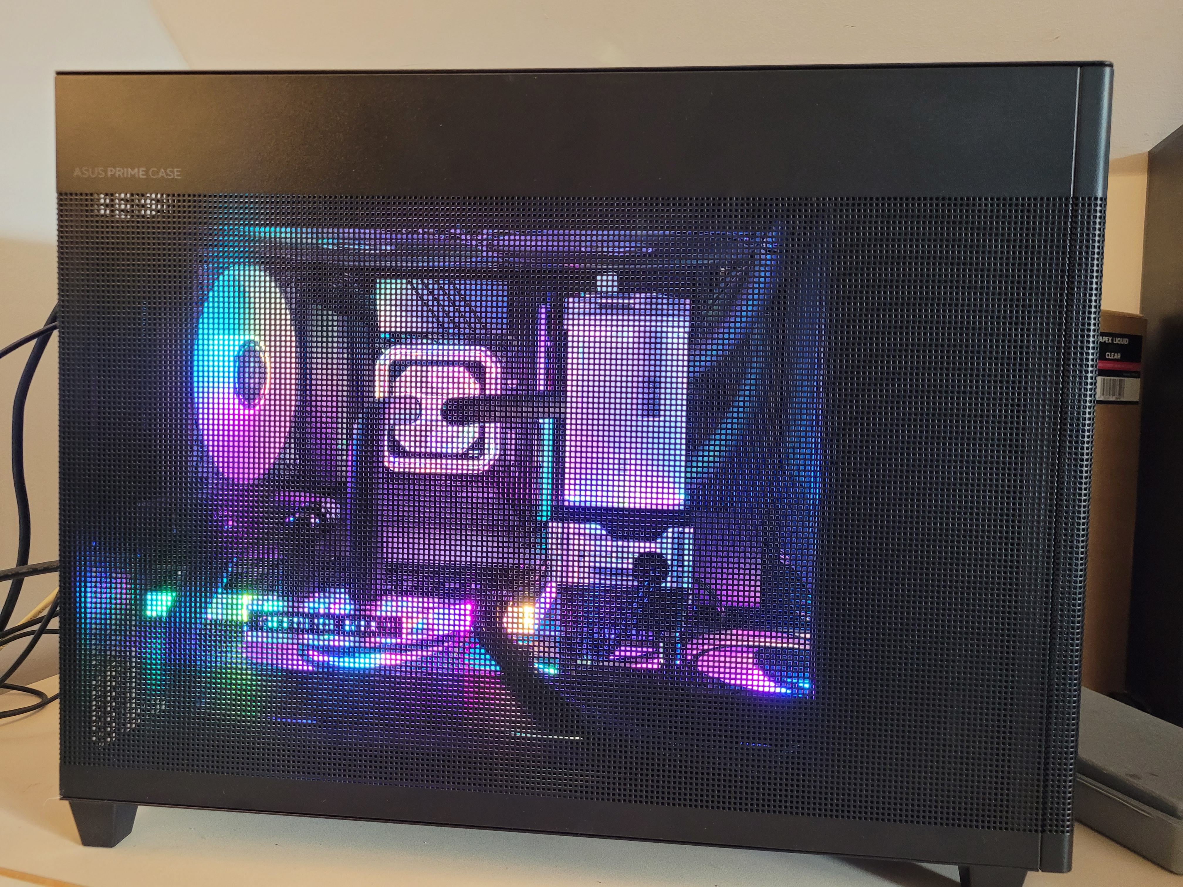

Konnte am Wochenende auch ein System (TUF760M, 13500@PeerlessA120, RTX4070) darin verbauen, muss aber gestehen, dass mich das Gehäuse nicht wirklich überzeugen konnte. Das feinmaschige Gitter schafft es irgendwie weder sonderlich gut zu kühlen, noch sonderlich leise zu sein. Platz ist an einigen Stellen sehr viel, vor allem durch die Tiefe des Gehäsues, an anderen Stellen sehr knapp - vor allem Kabel routen ist bisschen nervig.
Auch wenn ich nicht unbedingt der Meinung bin dass es sich um ein getarntes 35 Euro handelt (das versetzte PCI / ATX Blenden Design und der USB C 3.1 Anschluss, sind einfach eine Klasse drüber) denke ich schon der Preis ist mehr was ASUS verlangen kann und nicht was das Gehäuse wirklich wert ist. Aber gut, mein Kumpel is Happy, das ist die Hauptsache. Finde es kann ja gerne jeder seine Meinung haben und wenn für manche das ASUS drauf wichtig ist, halte ich auch nicht für schlimm.
